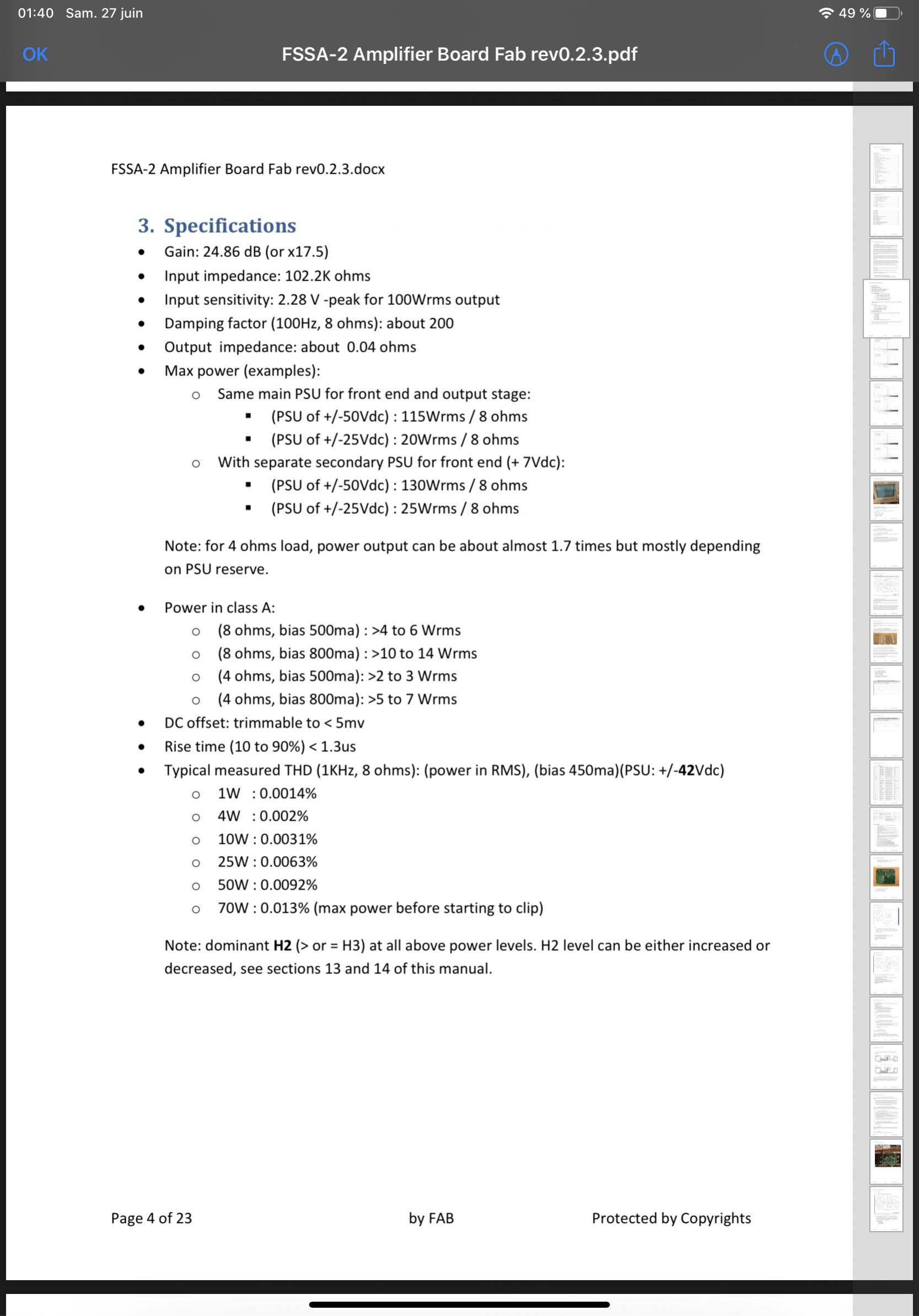

Does someone has already any specifications for FSSA-1 and 2?
Is it a good idea to use an SMPS to power the FSSA?
If it is, what should be the SMPS power and Vdc range?
I have a meanwell se-600-36, is it suitable?
Hi Miguel
See below for specifications.
For SMPS it is usually doable for 400ma bias. One SMPS per channel.
The one you indicate seem to have only one single output so it will not work.
Fab
Fab

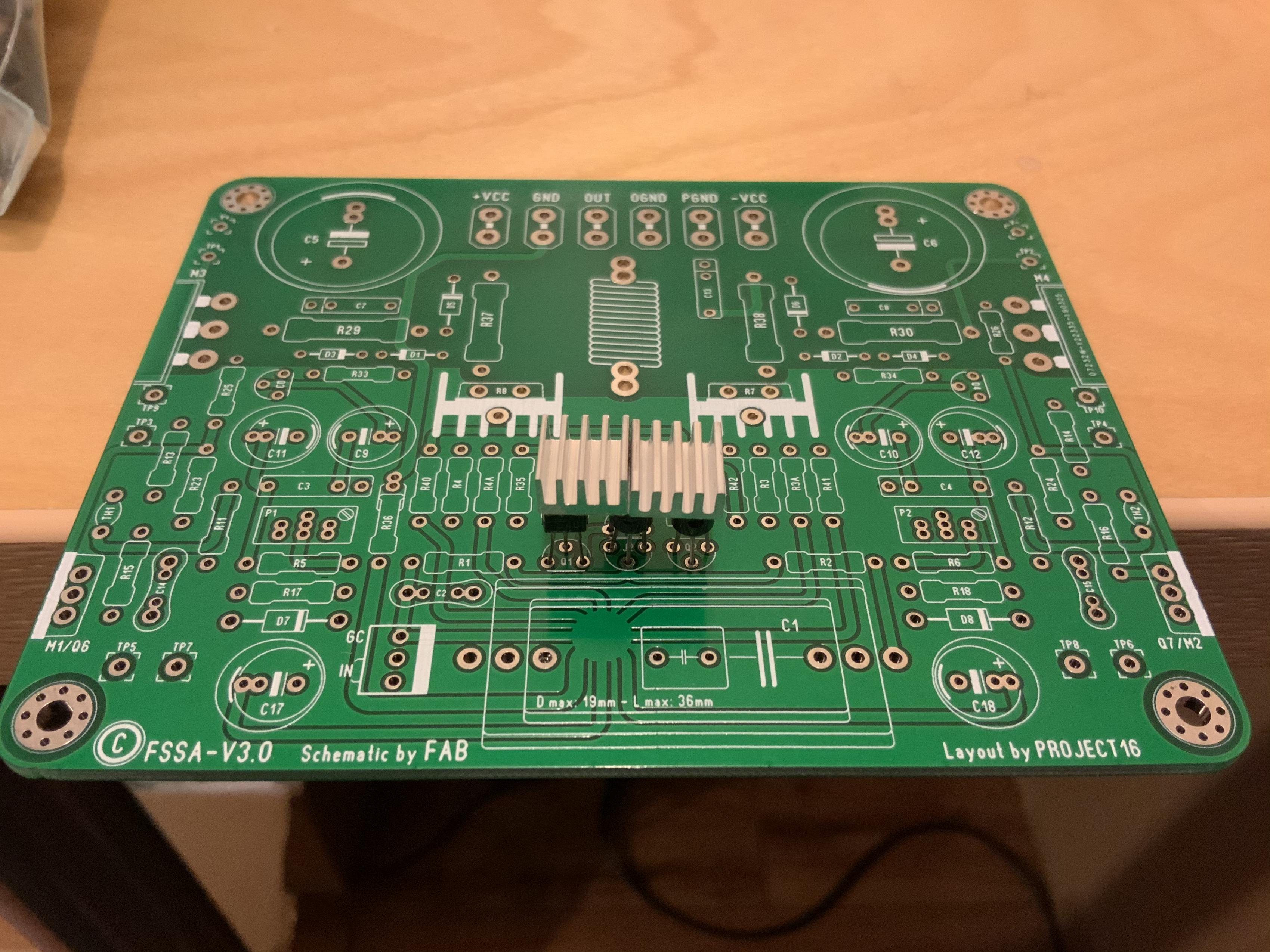

Input stage heatsink
Regarding the max voltage of the power supply it is for input stage transistors power dissipation concern as specified in section 9 of the manual. It is depending on ID of the jfet which is about 70% of IDSS which sets the input stage current for J1/J2/Q1/Q2. As suggested when having IDSS >= 10ma, one should use very small heatsink (having thermal tape) on top of J1/J2 and Q1/Q2.
Thus having IDSS < 9ma allows to have a higher PSU voltage for the same power dissipation in input transistors. Since J74 has a max voltage of 25Vdc the D7/D8 zener voltage should be 24Vdc max thus the cascode Q1/Q2 will see the rest of the voltage thus will require small heatsink accordingly.
Fab
