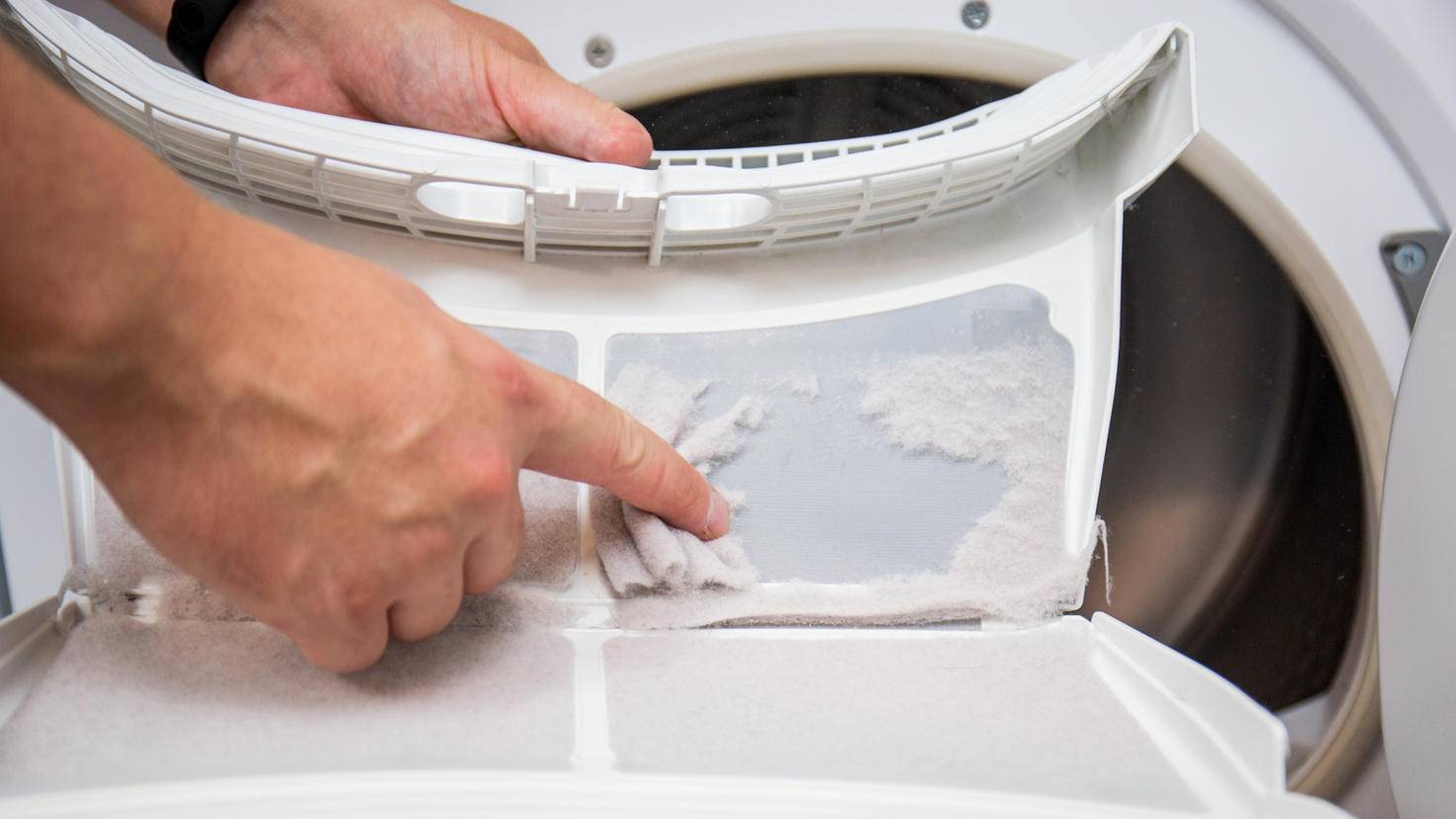

Did anyone try the extremely fine fibers from drying machines for clothes for closed box systems. It's damping for free and you always have a mix of all sorts of fibers

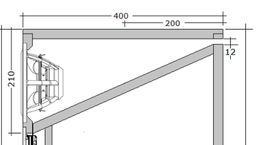

I dont know if it could help you but troels use the mw16tx as a midrange in its latest design called fusion 22. The mid enclosure has a linear slot to have a aperiodic tuning (according to him). He mentioned "if the slot is too much trouble, leave the midrange cabinet closed. It makes a slightly more dry sound compared to the aperiodic midrange cabinet".
I would be curious to see impedance measurement w/o the slot.
I highly advise against using the lint from your clothes driers, as this fiber is VERY VERY flammable. Being there is heat generation in drivers and xovers at times, I'd hate to see your investment go up in a big puff of smoke while also jeopardizing your dwelling should it go awry.
Hello, never thought about this. Yes you never know who pushes his loudspeakers with a lot of watts.... from this point of view stone wool is the most unflammable damping.
