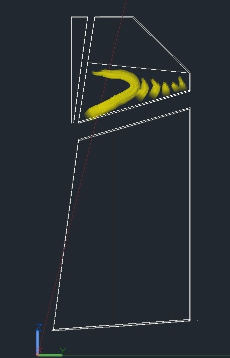

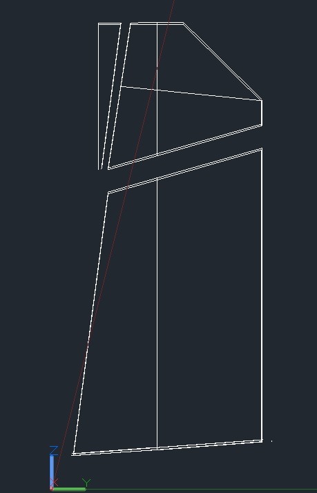

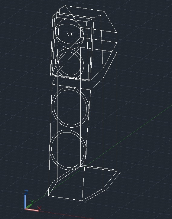

Fighting with the same thing, trying to determine what would be the best midrange cabinet for CAC17 / Satori eventually. I made sketch and will try to do some kind of tapered TL /aperiodic box shape which will be extended to the full depth of speaker. It can be opened at the end and if this will not be good simply to close it. Also it will not have any parallel walls....Damping,...I don't know yet, and there will be no consensus here on diyAudio I think. I checked many threads and there are strong opposite opinions...about bass tuning there is always some agreement, midrange topic is like voodoo....
Also with damping there is a right amount of it given a set of fixed parameters (enclosure, driver). You change other parameters it can be that a different damping should take place to get the box sounding right again.
Why there are different opinions on this is there are always several possibilities to get a certain response - influenced not only by the crossover.
My personal opinion is that enclosures should not be stuffed in closed boxes. Just a fill with fibers (100% fill) of the preferred sort but no stuffing (stuffing would be 200% or 300% filling with fibers).
However I never experienced current driven loudspeakers (current amplifiers). Here it could be that without dsp correction stuffing of a box is needed to get the Q down enough.
Today mechanical damped loudspeakers are very rare. Most loudspeakers are two way designs with bass reflex. Here too much damping eliminates the reflex function.
I know that well damped loudspeakers can sound articulate and correct but somehow too much like a revealing monitor speaker. If you want to listen to music and have fun less damping is acceptable. So there is some headroom for designing the speaker to your own taste.
