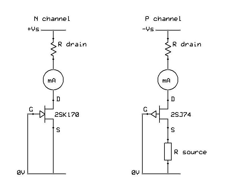

I have mentioned before about some issues matching these devices but for those interested here are my experiences.
Many would naturally assume a closely matched pair of K170/J74 is attained by low Idss tolerance but this is not altogether true.
These devices have different transconductance (‘gain’) curves and are therefore not true complements.
Simply matching Idss at a given Vds (usually 10v) will only give the point at which the curves meet. This also accounts for tolerance being Vds dependant – K170 Idss increases more than J74 with Vds.
Further explanation and a simple 'fix' is given by EUVL in the article ‘Input JFET Variants’, I have done a few tests myself which concur with this.
A relatively simple way of degenerated matching is to measure Idss of a J74 with around 5ohm source resistor and match this to a K170 without a source resistor. If this is done at the actual Vds of the circuit they are to be used in then the results should be pretty much spot on. Vds is given by supply voltage less the voltage drop of R drain.
For the more technical the formula from EUVL is;
Idss (2SJ74) = Id * (1 + Rs.Yfs)
where Id = Idss of the 2SK170 in this case; Rs =Source resistor value; Yfs = Siemens for 2SJ74 (approximate values can be found in the data sheet)
