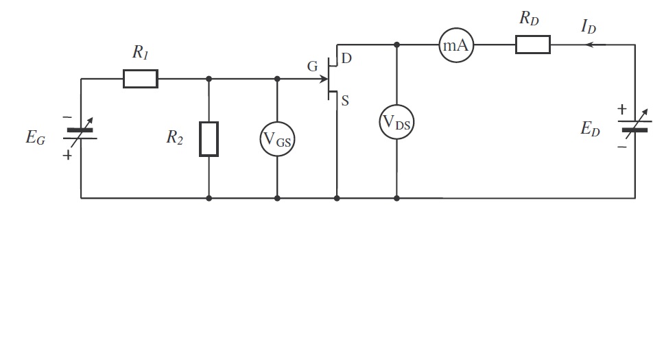

you can messure the static parameters of the Jfet 🙂
If you give me some more info on actual resistor values I can easily set up this test circuit and do some measuring
those resistor just have to reduce the current , so the power dispation would be within jfet limit
And both voltage source polarities reversed for P channel J74 I assume.
Is this schematic slightly wrong?
I set up for both N and P channels and was not getting any current flow.
When I removed the source voltage for the gate ie gate at source voltage through R2 then the Vds dropped and I got current flow.
Is it the polarity of Eg shown the wrong way round in the diagram (for N channel set up)?

Think I have found the problem, my supplies have a minimum output of 1.25V which is enough Vgs to 'switch off' the current flow.
Have slightly modified the circuit and at 10V Ed get around 5mA with 0Vgs, increasing Vgs reduces Ids and zeros around 0.6Vgs.

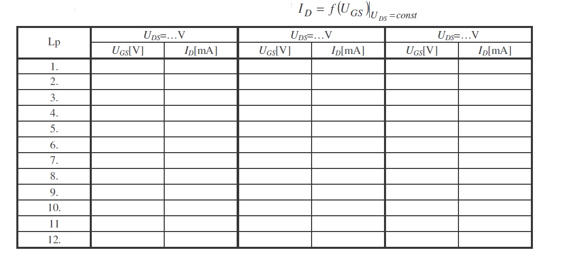

messure at Vd-10V and make the graph Vgs/ Id , compare with graph attached in the data sheet for J74 , it will confirm , your devices are origin Toshibas 🙂
Have done that and looks good to me, just trying to get in a file/format/size that will be acceptable to upload, I really don't like computers sometimes!🤐
