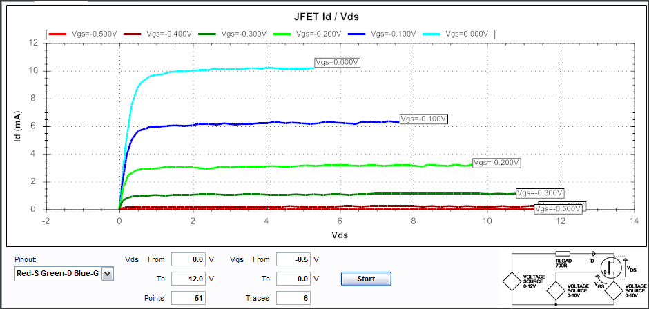

Spent most of the bank holiday weekend rematching and that stage is finally all done now. Quite a task if anyone has tried matching 460 or so jfets!
The next step is to run some curve traces to prove they are genuine, my curve tracer should arrive Thursday. I have no reason to doubt they are Toshiba as I have made discrete opamps from these batches and no problems (they were purchased back in 2008 just as they were becoming rare which is, as I believe, before the rash of 'counterfets' anyway).
Then I will group them and PM people on the shortlist first.
There will be a restriction on the amount per person to help out as many as possible.
Will post results of curve tracer here but don't expect one per device! 😱

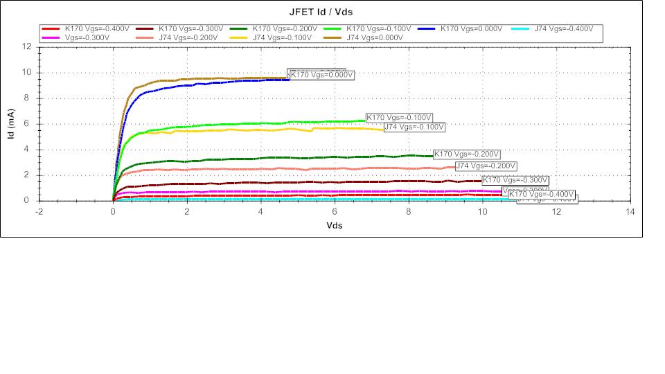

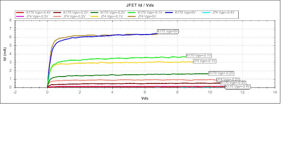

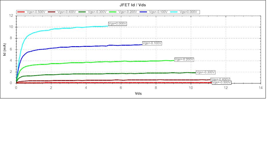

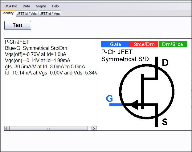

I got 20-30pcs in a bag that I am a bit suspicious of. Here is one I picked at random. Have you got one near its Idss as estimated by DCA Pro so we can see about its Vgs (off), Yfs, and curves? Thanks.
Thanks. Those in my ??? marked bag are bogus indeed. Very good try but fake.
They lack the slant, the low Vgs responsiveness. Those things are in the datasheet curves also. When their Yfs(gfs) and Vgs(off) still shows good. Yours being a bit less for gfs should be our room temp diff right now. Most Northwest and Southeast Europe stretch.

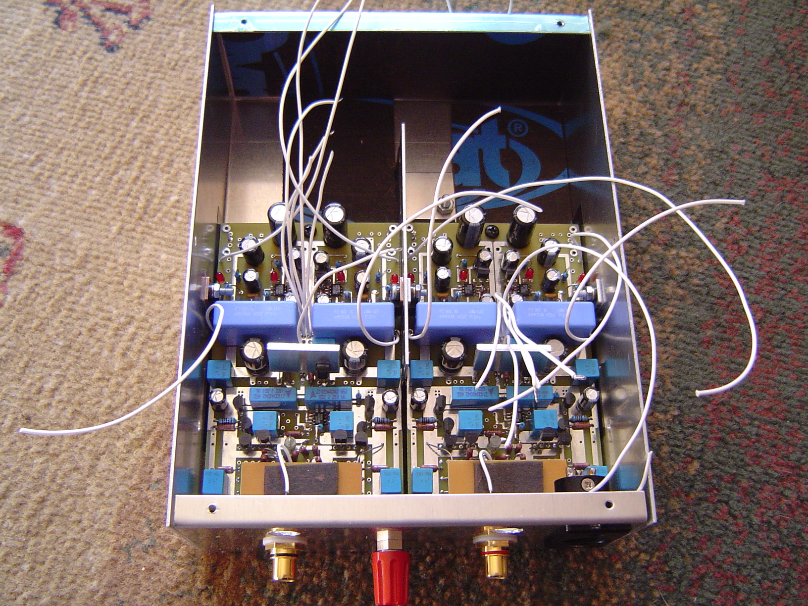

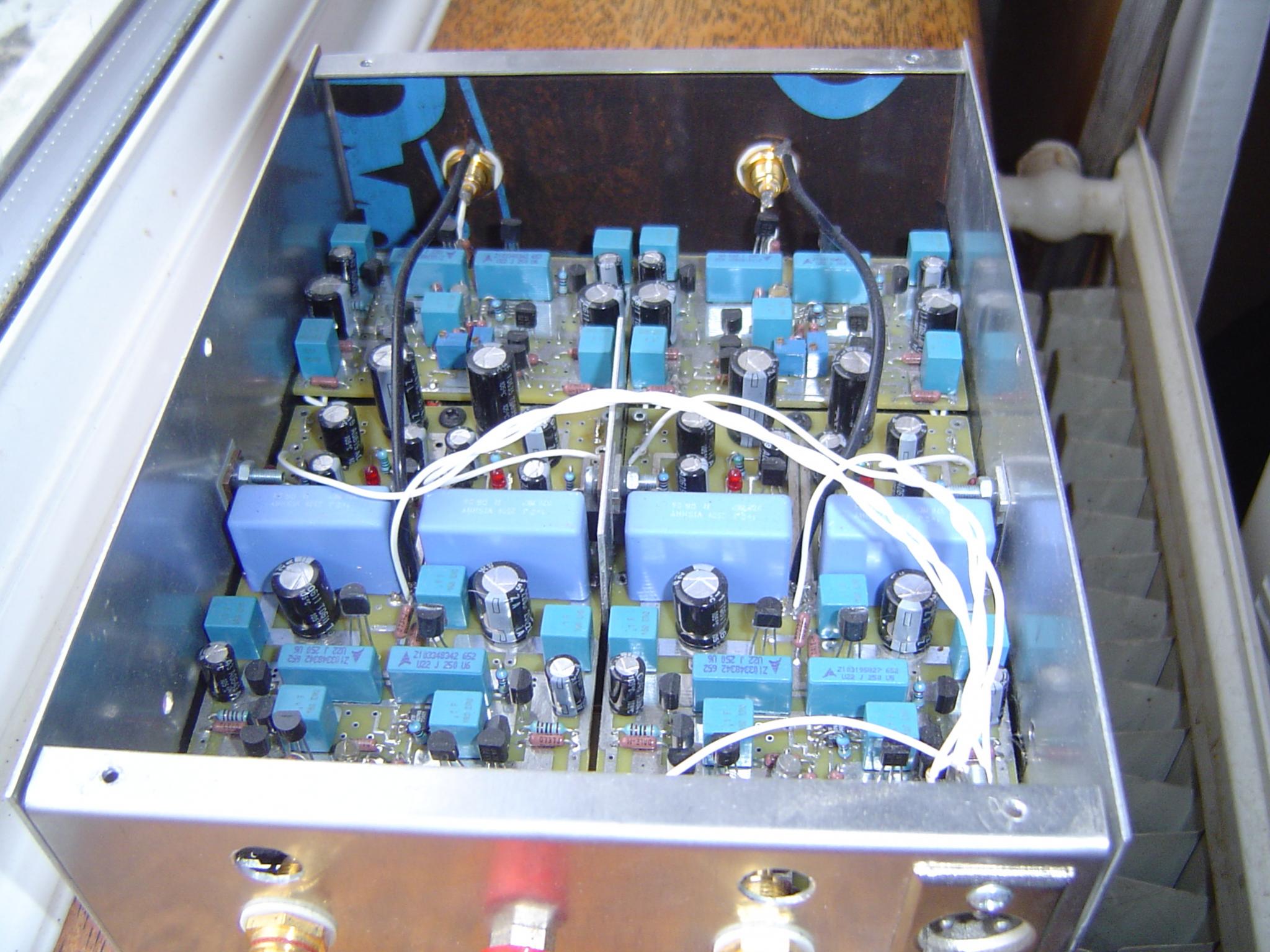

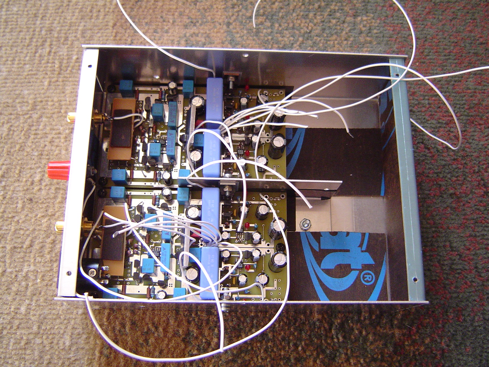

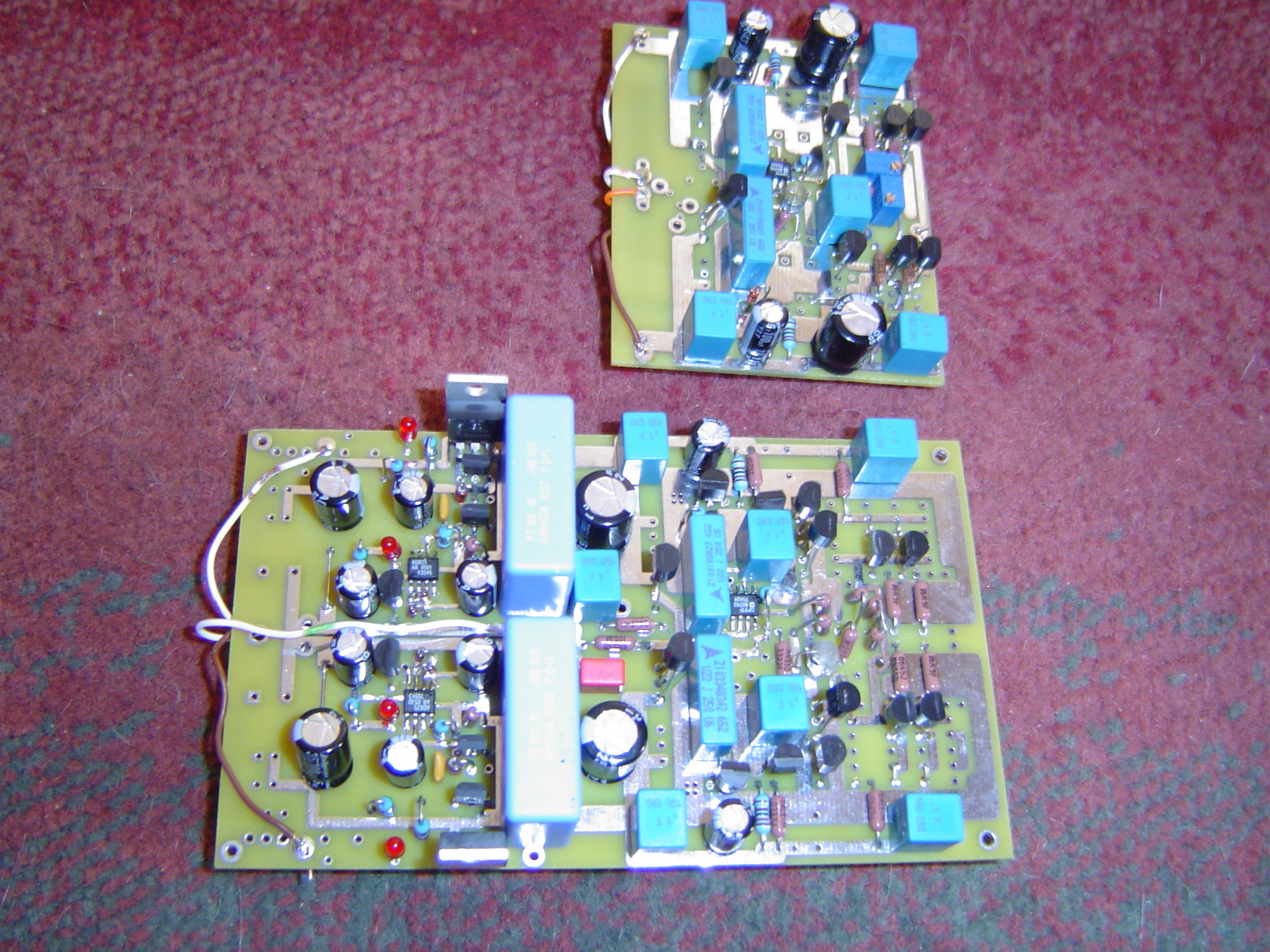

I built a copy of Borbely Audio's mm/mc phonostage with Walt Jung super regs, very good but I don't use vinyl any more, I know..😱 🙄

I wasn't planning to sell the phonostage, it is still in prototype form and has a couple of niggles - runs a bit on the warm side and suffers from quite high dc drifting on mc due to front end jfets not being thermally coupled (even though there is an integrator circuit). It is quite useful for me to keep as the building blocks are discrete opamps which can be reconfigured for other uses if I decide or I can just rob the matched jfets from it.
