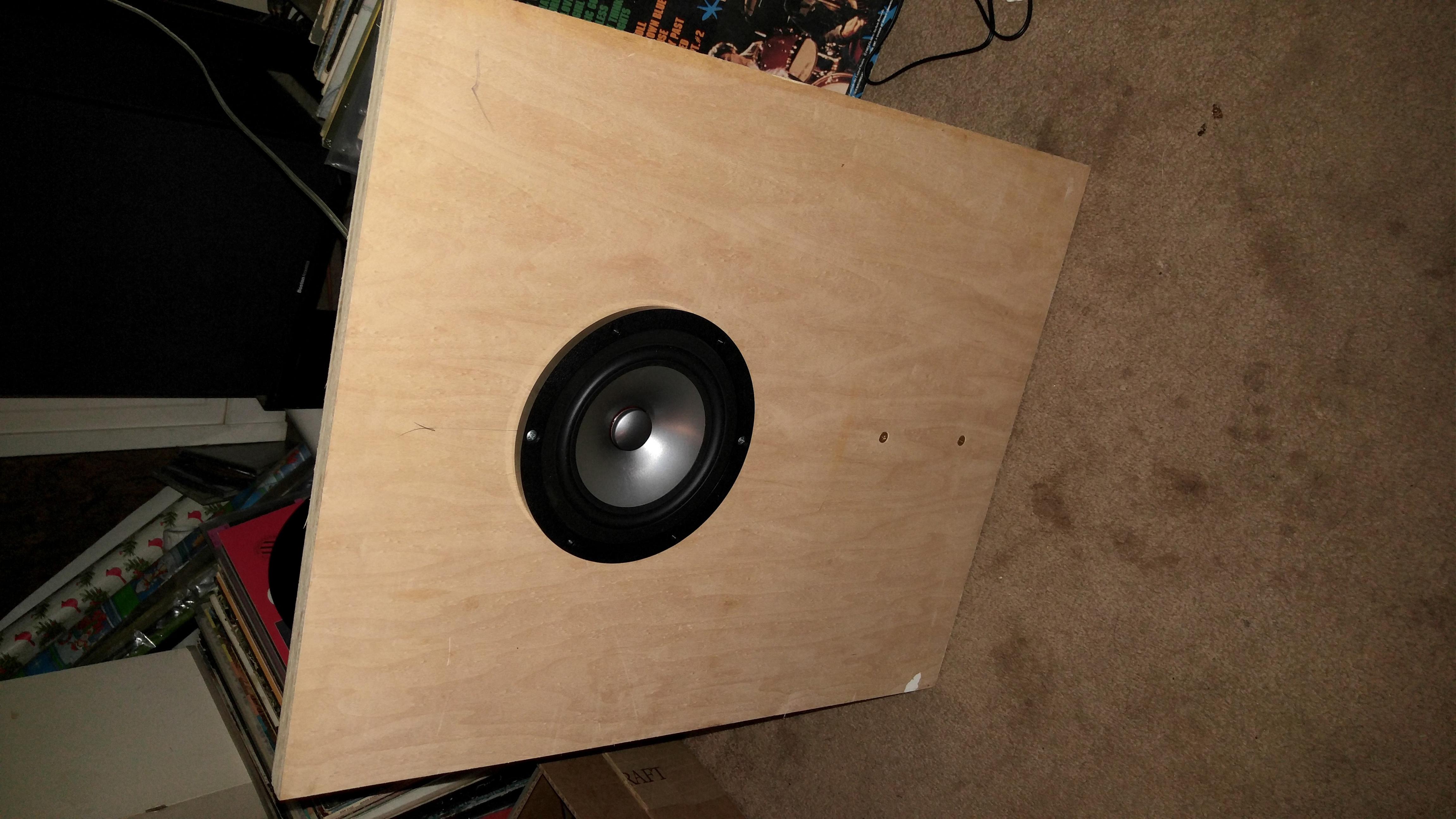

I read that breaking in the 10.3s can take a while and I've seen some posts of people rigging up drivers to get some hours on them before installing, so I decided to put my 10.3s in an open baffle, no research or prior experience, just something to mount them in. Then I ran across posts suggesting this might harm the drivers.
Building my FHXLs might take a little while as I'm trying to make them shiny and I'd like to break in/listen to the 10.3s meanwhile. Any real simple designs out there I can bang together with a nail gun and 3/4" paint grade real quick?

Always a good idea. You have to keep the levels down anyway when you are doing initial break-in so there is little to no chance of damaging the drivers. I give all the drivers i work on an initial low-level 2-300 hr breakin -- drivers unbaffled sitting on their magnets. They still need real world use to fully break them in, but the worst is over brfore i ship them. The A10.3 can use a particularily long amount of breakin... 500-1000 hrs to get to their best.

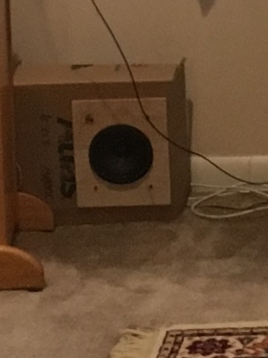

I broke in a pair of A10.3 in 'sealed' 0.25 ft^3 cardboard boxes. Shown below is a pair of PA-130 drivers in the same boxes. I put on the local classical public radio station & let them run all day at low volume for a few weeks. I have to say that even in these crude boxes, the A10.3 sounded good!

I have made a few sets of loudspeakers and have never made a separate box to "break in" drivers. I quite enjoy listening to them as they stretch themselves out and become what they are to be. It is an interesting experience listening to the changes.
I think it is not really necessary to "break them in". Just realize they are going to change over the first hundred or 2 hours. Enjoy the transition it is an interesting experience.

More than breaking in the drivers, I wanted to listen to them. I'm excited about the FHXLs (not my fault you guys have this website that distracts me with an amp camp amp build, and a pair of nScan-Kens that keeps me from completing my original project) but I'm also excited about the A10s. I think I'll throw together a couple boxes because even NPR news sounds awful with the drivers out in the open.
