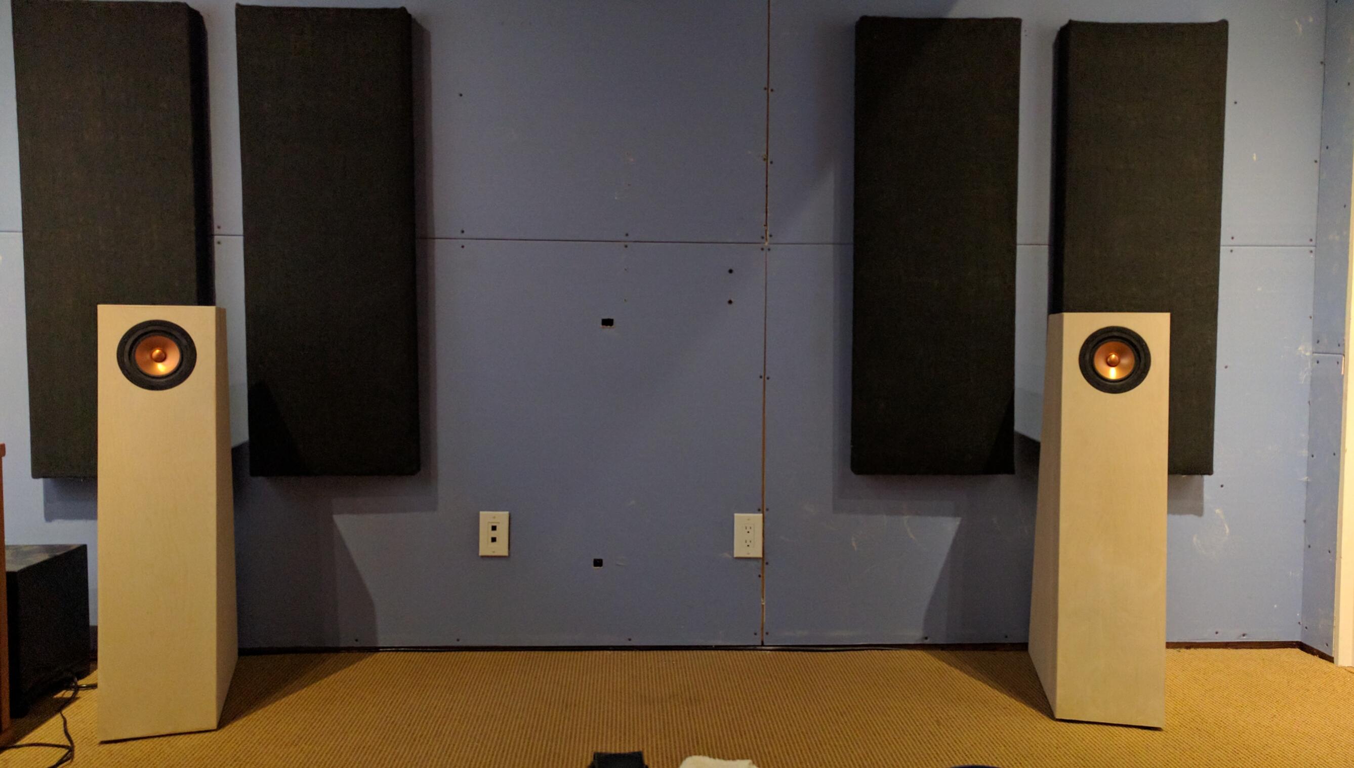

Jeremy- Depending on how far you are setting from your speakers you may try to tilt the back of your cabinets to align the driver to aim at you directly rather than over your head. If you look at the on axis plot of the drivers vs. off axis you may pick up some extra high frequency you are looking for, just a suggestion and easy to try.
Hi Jim,
I think they are bang on, from my listening position I can see the top of the cabinet so the center of the drivers are level with my chin more of less, the 5dg tilt is aiming the center of the driver directly to ear height, as I say It's just a smidge recessed in the treble for me that puts things like hi-hat cymbals and vocals back into the mix. I've always lived with 2/3 way speakers and the Alpairs are not far off, pretty impressive I think with very coherent presentation, but I feel the need to experiment with some tweeters, ESS AMT have been recommended to me so I'll be going with those, if they don't work out, as in muck the presentation up, I can always sell them on.
Cheers, Jez.

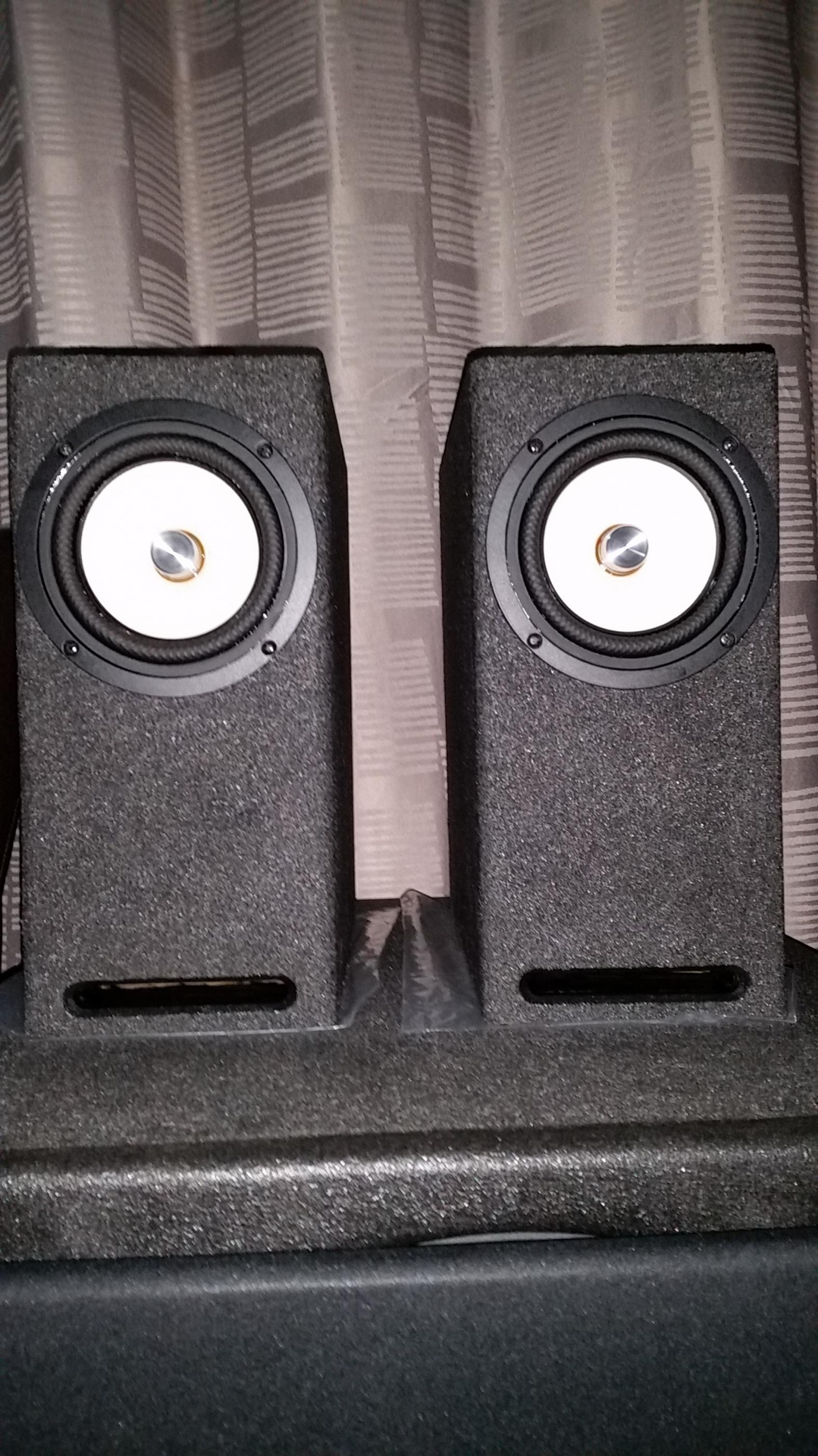

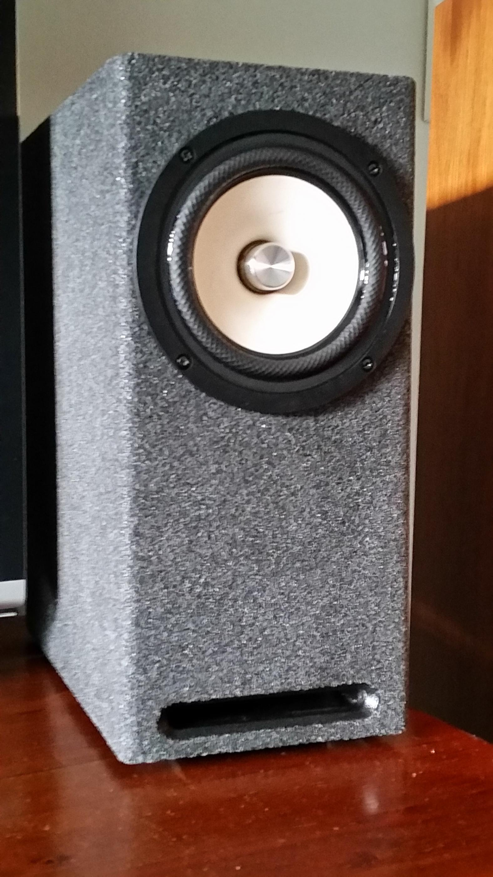

I'd planed on coating the wood with a water based, acrylic sand texture coating, applied at 2 coats at 3mm total thickness for a custom finish. I've used this on 2 of my other projects & IMO looks quite nice.
This is what it looks like... Pics are not the best quality, my apologies.
I'm sure this sand texture will help to dampen cabinet resonances. I can colour this material any colour i like!
I should mention that i created it, as my job is developing decorative surface coatings for the building industry.
