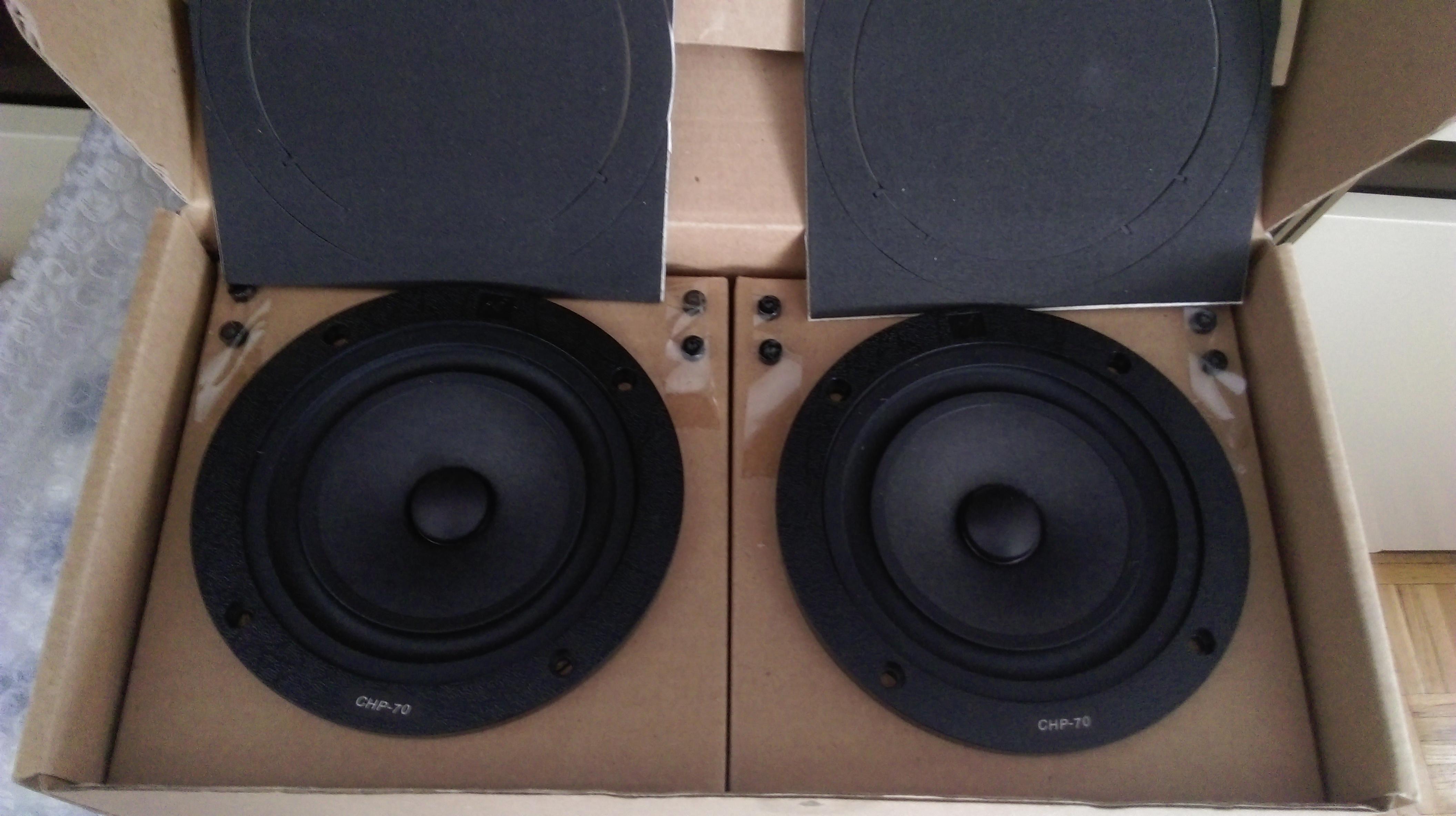

Hi, im new here and quite new to diy audio building so i would be grateful for little help.
Im planing to build Frugel-Horn MK3 with MA CHP-70 and asking on few opinions on materials. I have some 18 mm okoume plywood that im planing to use for build, it is light water resistant plywood for boats so will that be good as birch plywood?
Im also have bag of long combed natural wool, would that be ok for damping instead poly-fluff?
And last, its hard to find cotton or wool felt here but maybe i can manage to find some technical wool felt like this : Technical Felt : Manufacturer of Technical wool felt
Is that felt to much thick?
Thanx
Tomislav

Cindra,
As long as your plywood is good quality, with even surfaces and does not have too many voids, you should be ok. Baltic birch ply is not a must and 18mm is more than enough thickness.
Poly-fluff would be probably a "safer" choice - have read that natural wool can attract insects, and you would not want that.
What thickness of felt can you find? IIRC the advised thickness is 12mm, but it can slightly less or slightly more. If it is too dense/hard, then maybe it will have less effectiveness. If you can share a picture that will be good.
Can you find jute felt at your place?
Providing the ply is void free, should be fine.
I would avoid the combed natural wool unless it's been chemically treated to avoid attracting moths. Hollow-fibre pillow stuffing (polyfill, dacron &c) is as noted above a safer choice on that front. The soft technical felt should do, or look for a natural fibre / wool fibre / jute carpet underlay. If it's slightly thicker than usual, you may need less fibre fill.
