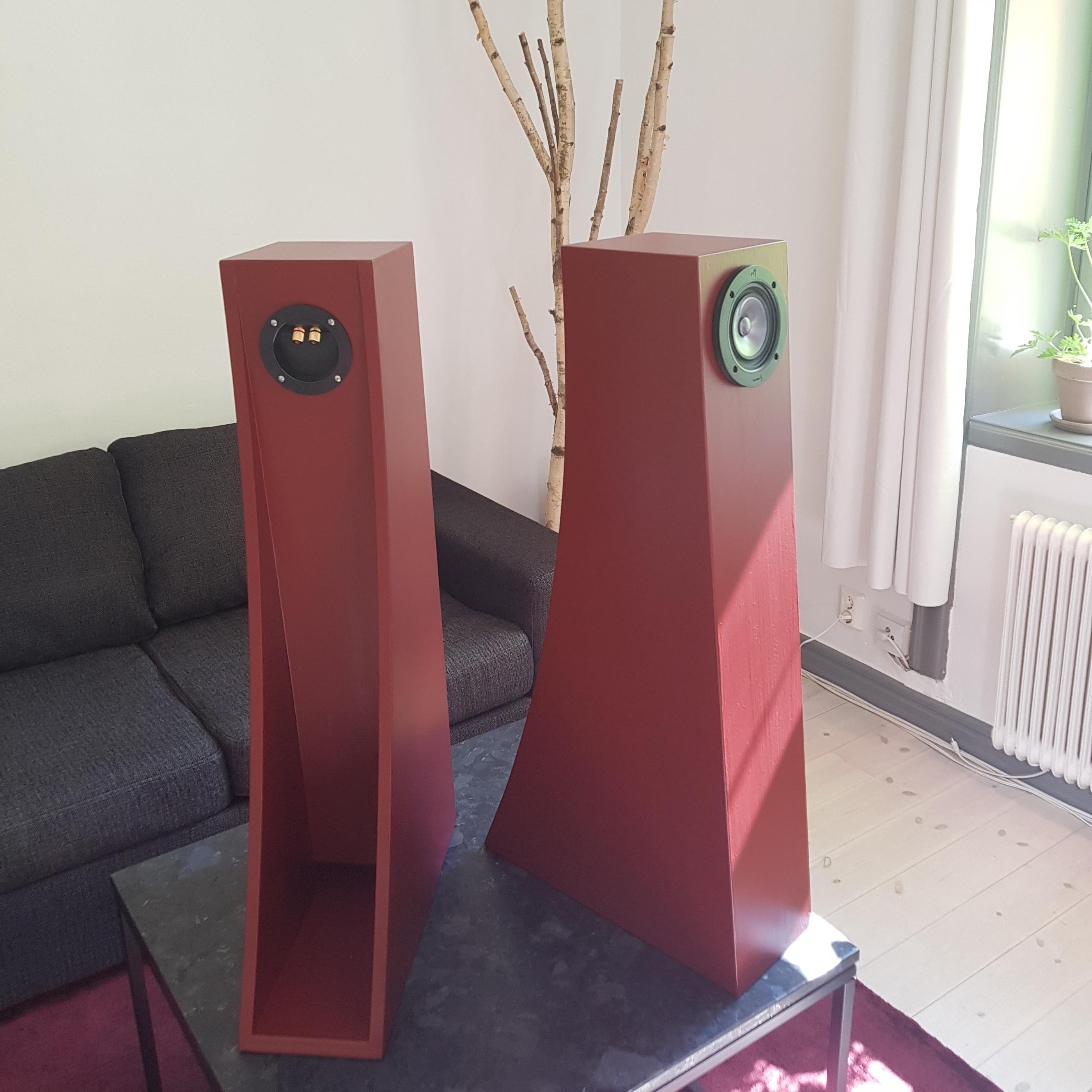

Hello again everyone.
Went to check what you guys said about spikes/pads for the speaker. Thinking of buying some spikes just because it looks good, if it sounds better (I don't think I'd notice the difference) thats cool too!
But then I remembered I never showed you my finished product! 🙂
So here it is. I feel like the sound improved with the paint, but maybe it is just an illusion. The color looks crazy good in real. Matches my carpet really well.
Nicely done Fredrik!
Mine were veneered in Cherry and then finished with Rubio MonoCoat.
I cut a set of 3/4" solid Cherry "Outrigger" feet that are shape much like a dogbone.
I used both rubber feet as well as spiked feet on the bottom of the outriggers.
No, I can't say I heard a difference with rubber to spikes. 😕
