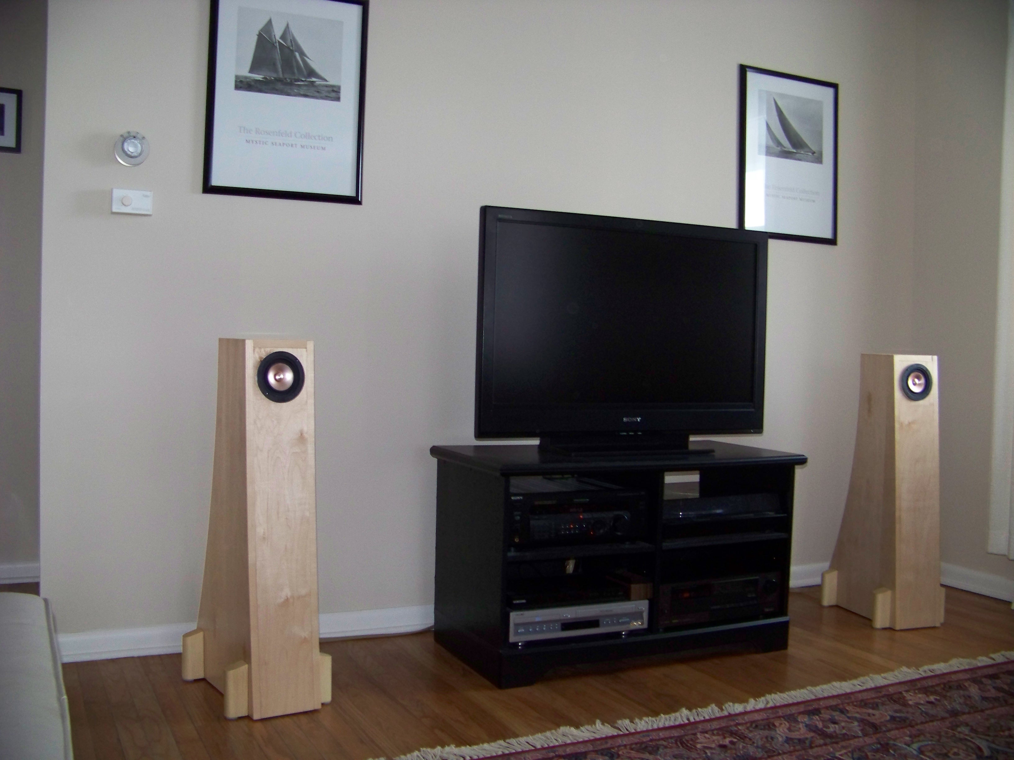

When measuring your space, make sure you allow for wide feet at the bottom of the FH3. They are otherwise a bit on the tipsy side. This makes them take up more space than a normal box shaped speaker even if they are slim at the top. I don't have feet on mine and I already knocked one over.
After tipping one of mine over I came up with these home brew outriggers using aluminum bars and spikes from ebay.

I'm using the A7.3 Gold. The lack of really deep bass, especially compared to my 2 ways, kills the experience for me. I think what I liked when I first played them for a few months was the detailed midrange, but I then modded my turntable which now produces bass so deep and tight that I need to hear it, even at low volume. These just don't, and we all know they don't.
I have a subwoofer, but it doesn't hook into my analog setup, and besides I never liked that either.

I got the 7.3s too and feel the same way. A friend is going to make a Passive Line Level Cross Over for me (to use with subs) which I'll use with two amps. I'll post the results.
I use two bucket subs with the Frugal Horns and they integrate well.

Bucket subs using $66 Peerless woofers, 5 gallon buckets from Home Depot and a Yung SD300 plate amp.

Your bucket subs look great Poultrygeist! Do you brace the insides in some way? I also like how you finished the sub amp.

Really depends on what the drivers are. I've got the prototype P_10 FH3's at home, with Fostex FX120's in them. They have very good low bass output, and don't require a sub.

Thanks. Here's the bucket sub recipe. I understand their inventor uses them with his HS horns.

These OB H-frames also partner well with the FH's. They won't plumb the depths but they offer very accurate and natural bass that won't disturb the neighbors.

What drivers in the OB H-Frames?
Eminence Alpha 15a
