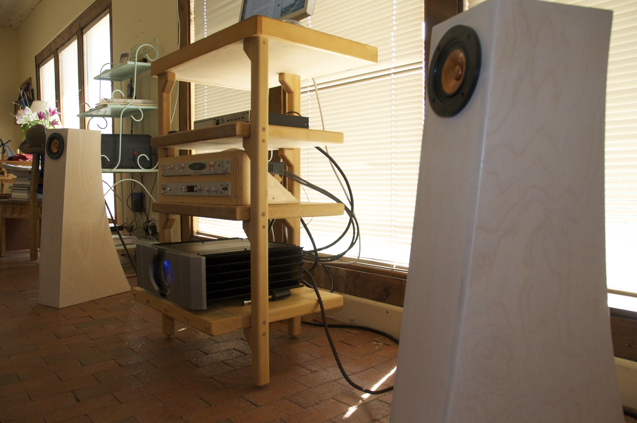

Holy ****. The M.A. alpair 7 drivers in the new F.H. box seriously rock.
I would have NEVER thought it would be able to produce BASS in my room. But they do pressurize the room! Well... OK a big *** Altec 16 incher does have piston to drive you to the prizes rather effortlessly but the Alpair is not that far behind. No doubt that I will try to blend the altec and the alpair but for now...
I got TUNES!!!!!
The build of the F.H. box came out very fine. Boy am I one happy SOB!!!
I had to remove my trusty home brew 45 from the equation but Nelson's kick *** Pass Lab 30.5 SS class A amp does just fine, thank You!
No xover, no step baffle.

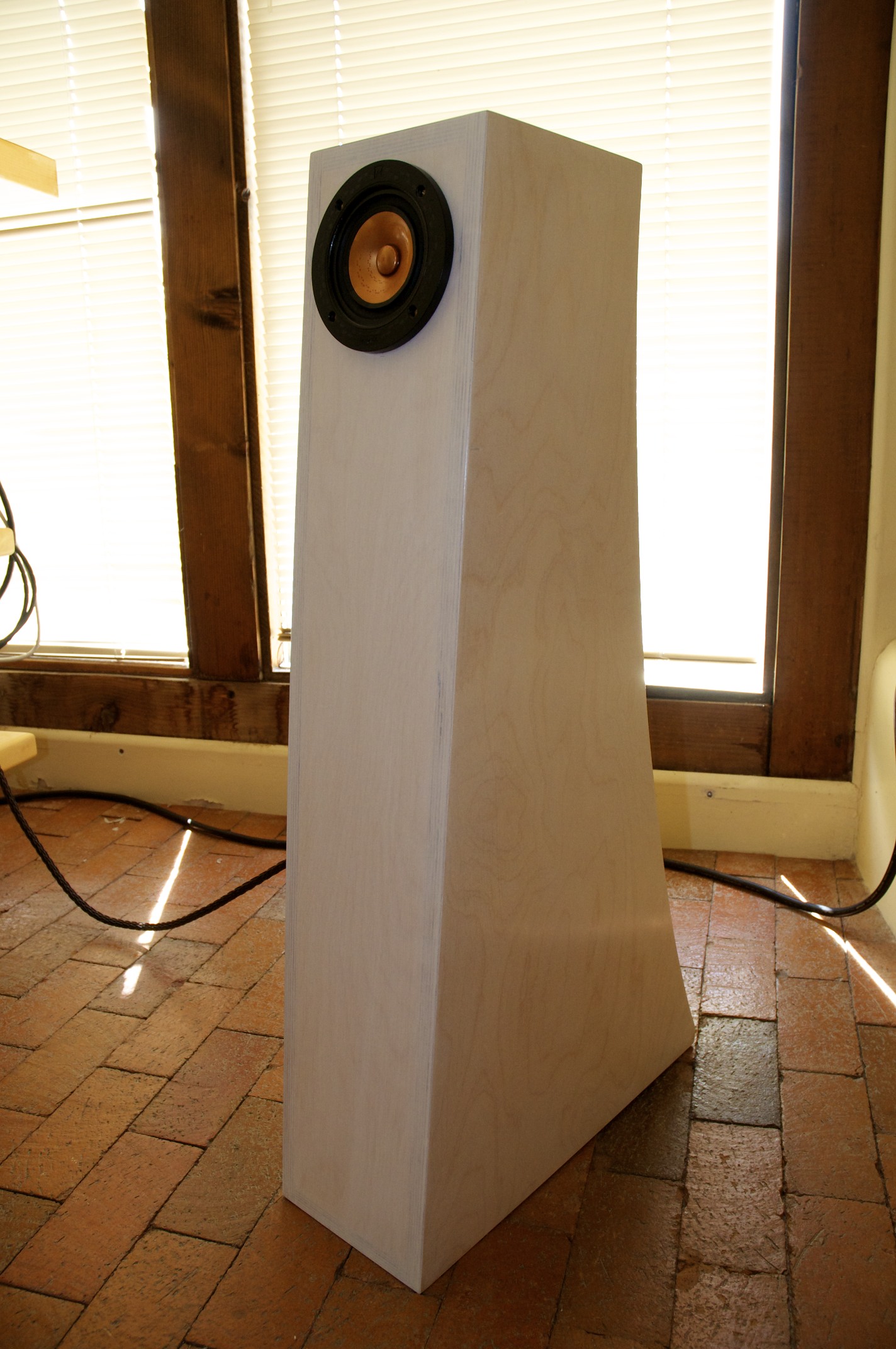

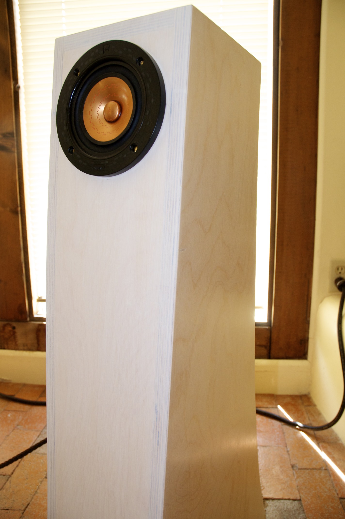

Not a Fat Pak...
18 mm baltic birch.
Glue up with Titebond Pro
Stained with an oil based white stain.
Then waxed with "Bowling alley wax"
For the stuffing I used an Army surplus wool blanket and pillow fluff.

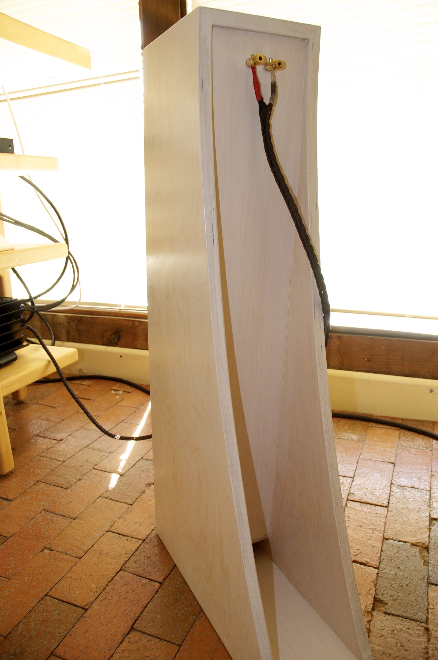

Internal wire 14 ga solid pure silver wrapped in a cotton jacket.
No spikes as yet but in the shop.
punch list...
spikes
install front baffle cut out so that the speaker basket is flush
Adjust the amount of stuffing.
Enjoy
