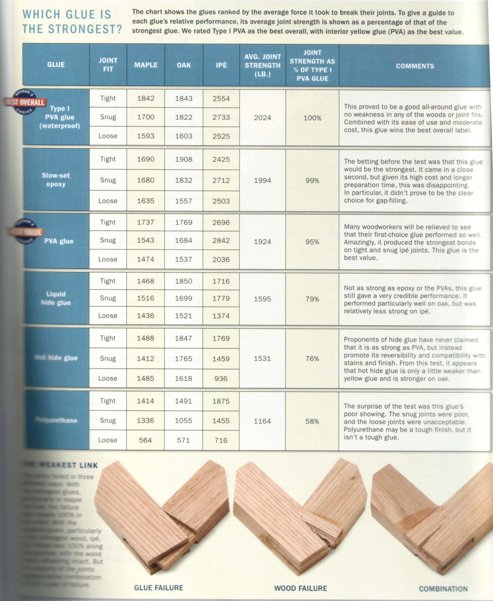

I want to tell you guys about an article in Fine Woodworking a few years ago.
They did a glue test.
The glue that tested the poorest were the foamie glues.
I too have found this to be the case. I will never use them. Good old Tight Bond was one of the best....
I just sayin...
You may not have the same results...
I'm just sayin...
