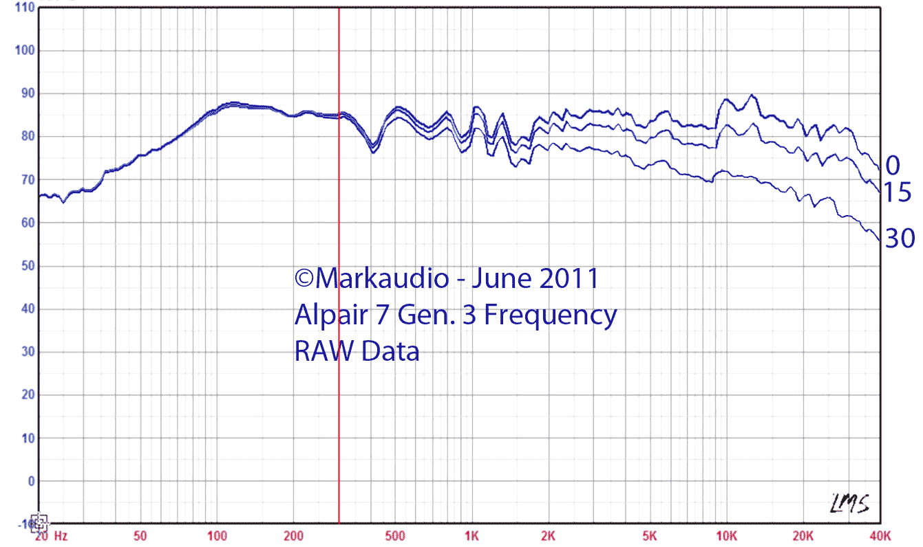

Since the box does not affect the response significantly above about 300 Hz just look at any measured response. Mark's graphs for the MA drivers are very good.
Here for instance is the anechoic measure of A7.3. The FH3 with A7.3 will have similar response above the red line. Below the red line, the box gives gain and more extension but is dominated by the room and the placement in the room. It is also affected by the amount of damping used below the driver.
attachment.php
dave

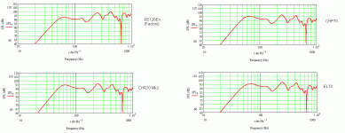

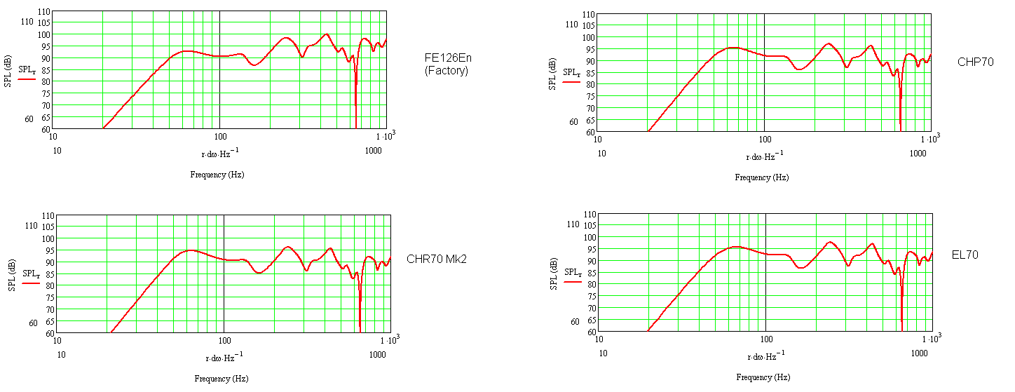

Thanks for addressing my question. I guess I was looking for something like the modeled FR curves that are on the Frugal Horn Dalek and Metronome pages. BTW I am thinking about building a Metronome - the link to the plan seems to be down unless I am looking in the wrong place.
That i have (and must have posted somewhere sometime). Scott frrely posted those in the early days, but they are subject to the same caveats as a real FR measure. We have been much more careful for the last wall as people were more often then not mis-interprting them.
With MJK it is possible to specify part of a room with speaker placement and do a sim. The walls thou are perfectly stiff (not achievable in a real room). I do not know what simuated room these were in, but they are minimal damped. All the ripple above a couple hundered Hz will not be there in reality, and the LF will be modified by your room, placement and how much damping is actually used.
