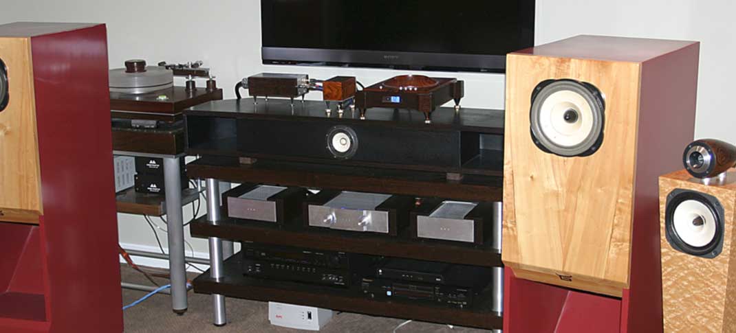

Frugel-Horn Mk3 flat-paks
In the same manner as Aiko is used here...

My main interest is speed and detail in the FH 3 As a musician (cello) I want to known what the artist is doing. Bass is nice, but I don't want to give up response or clarity, each of which are more important. I had been thinking about the Altair 7, but the low sensitivity seems like it would compromise clarity and force a more complicated amp. EdbSchiller's "bass augmented" (or a DIY alternative could be added later on). Any thoughts on a driver? I have a back wall but the corners are 3 feet away from each speaker. Listening position is 7 feet. Mostly classical, jazz, maybe antique rock.

OK, now that I got that outta my system (been a rough day), a couple of comments - I'm as much a fanboy of Fostex fullrangers as the next FR/DIYer, but unless you've actually heard the FE138ESR for yourself and enjoyed the experience, of the 2 I'd recommend the FE126En its sonic merits alone.
I've commented on the question of (rated) sensitivity of the Mark Audio drivers before - indeed it was rather a concern for "us" before the opportunity arose to hear them (in any enclosure), since after many years of playing with the 3-6" range of Fostex drivers (mostly the FE126/7 and 167) and often in conjunction with low powered tube amps ( 8W and under) , the lower number printed on Mark's spec sheets gave pause for thought "will my 3W 2A3 be enough?"
Well, I for one consider this to be one of the areas were the printed numbers don't tell the whole story: to cut to the chase, and to address the question of the FH3/A7.3 combo - it works very well indeed , doesn't need the same degree of boundary reinforcement to maximize the bass extension and weight as the FE126 would, and to many ears could be considered more neutral through the critical upper midrange than the Fostex.
That said, any FR driver of this size class can only benefit from support by competent bass augmentation, particularly, in my opinion, if the FR driver is actually HP filtered (say between 80 - 120 or higher ) thereby relieving the excursion demanded of it. I think you'll find the most noticeable improvement when adding separate woofers in this manner (stereo if XO any higher than 100 or so in a non HT system with mono blend of LF ) is a substantial increase in attainable SPL concurrent with increased midrange clarity, depth and image stability.
There are any number of candidates for midwoofers suitable to the task - IINM Ed uses one of the Silver Flutes in a fairly simple small box - but that may have changed since the last time I looked. In any case, one of the keys to seamless woofer integration is that the selected drivers have clean smooth response several octaves above the determined XO frequency.
