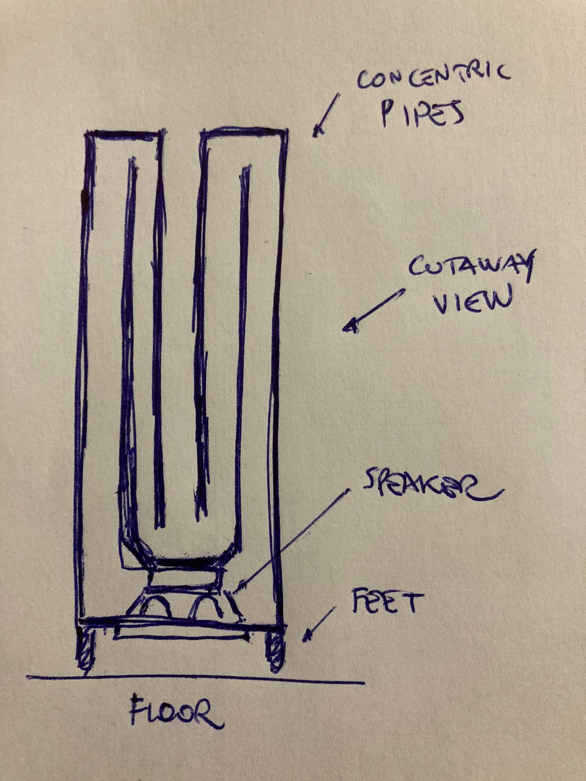

You may have trouble finding enuff room on the base of the prism to fit the driver. On secound look maybe not.
You need to ensure that the feet hold the driver sufficiently far from the floor, and unless it is hardwood or stone you should add a reflecting base. Like the distance from the wall, the floor can provide mass-loading to the front side of the driver.
dave
Reactions: LeifB60
Not easy to find standard pipes of just the right ID/OD. My LXmidi (8"+4" fiberglass-honeycomb XO-less) has such a folded-concentric TL going the other way exiting below. I plan to replace the middle cardboard tubing with square-cross-section plywood.

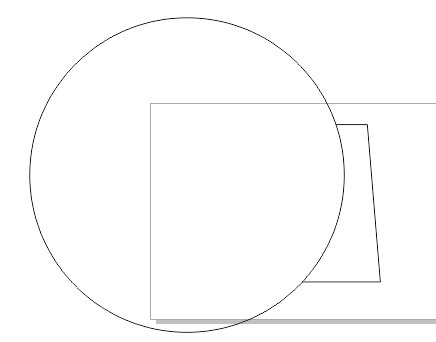

Hello,
I was trying to draw the FH MK3 in Corel draw.
My reference is page no: 4 of the document: http://www.frugal-horn.com/downloads/frugel-hornMk3-1v0-060518.pdf.
My result is attached here, but it looks different from the drawing given in the build plan.
The curve has a radius of 1775mm, but it looks very different.
The front baffle is 85 degrees inclined to the left.
Request guidance on drawing the curved portion in Corel Draw
Thank you!
Sumesh
... Corel draw. ...

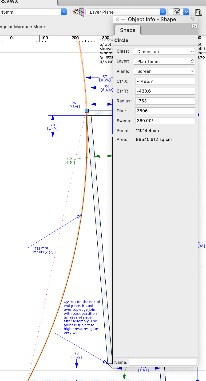

Hi! Not sure about Corel Draw (or the dia/rad issue), but I have found the wiki.geogebra.org site to be helpful. It takes a bit to figure out the interface, but once I did, it beats me trying to do this in Excel or PowerPoint (I could probably do it by hand if I had all my draftsman tools, but that was 30+ years ago now).
I need to go, so these aren't the exact tools, they are just the ones that I had sent to someone else a while ago.
https://wiki.geogebra.org/en/Circle_through_3_Points_Tool
https://wiki.geogebra.org/en/PerpendicularBisector_Command
Reactions: sumeshak
Thank you for directing to a powerful platform.
Let me explore.
