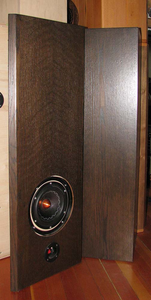

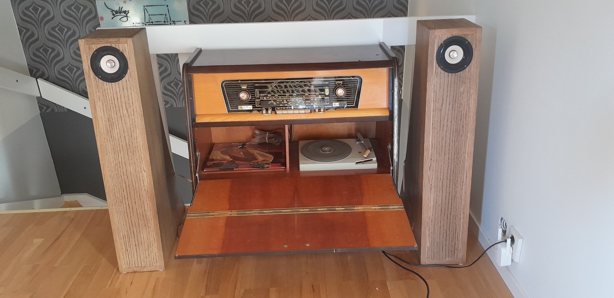

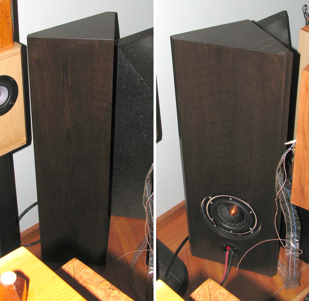

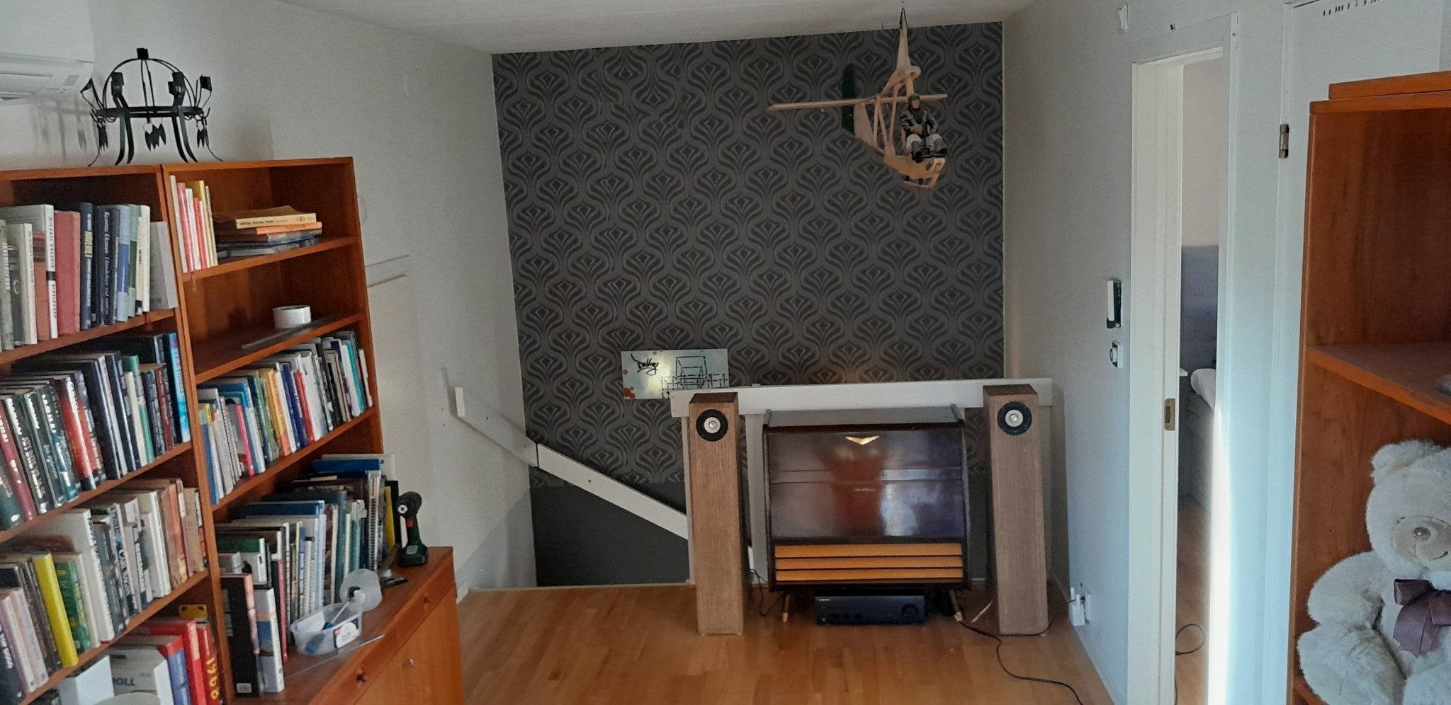

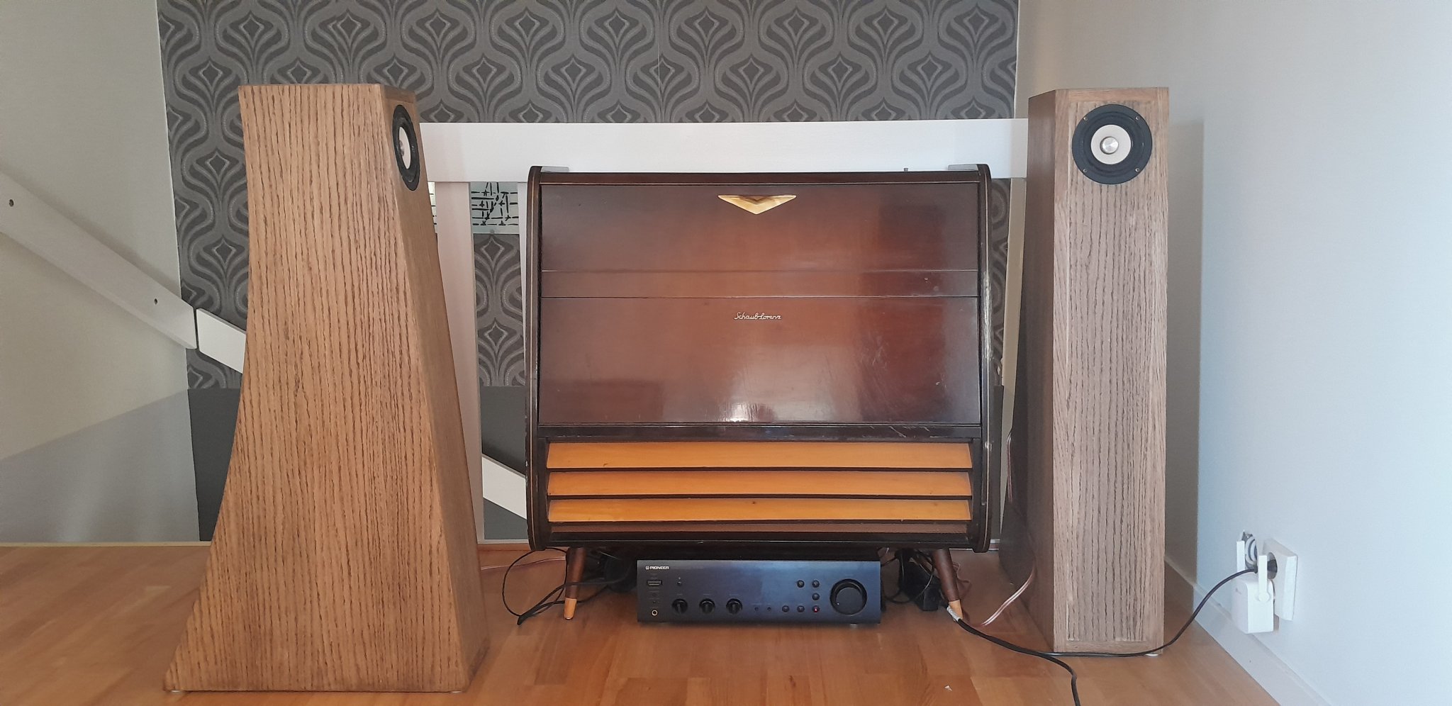

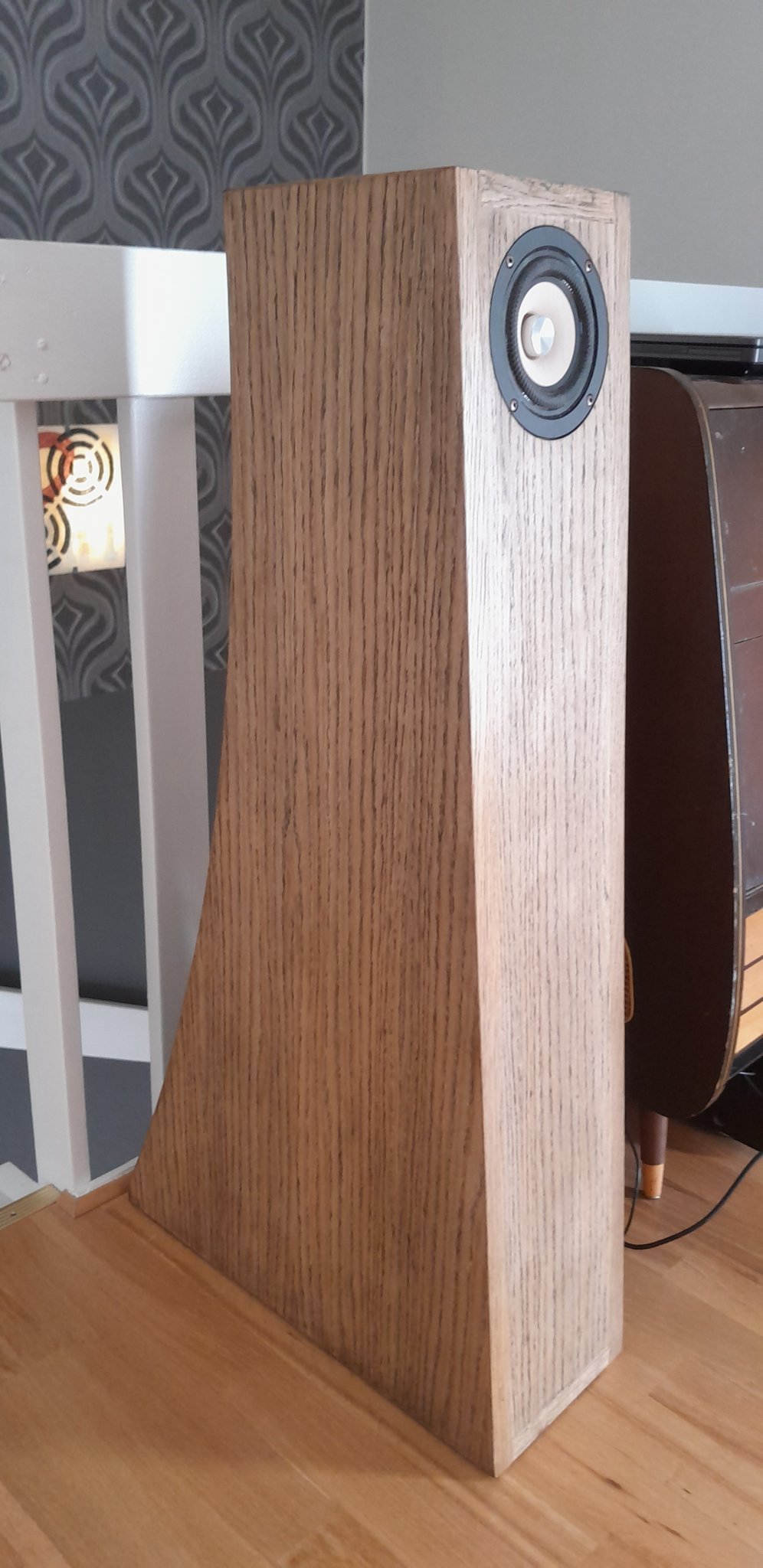

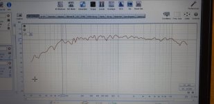

My Frugel-Horn MK3 are finaly in place.
Build by 19mm MDF with oak veneer. Finished by vax-oil tinted with smoked Oak.

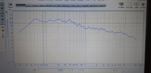

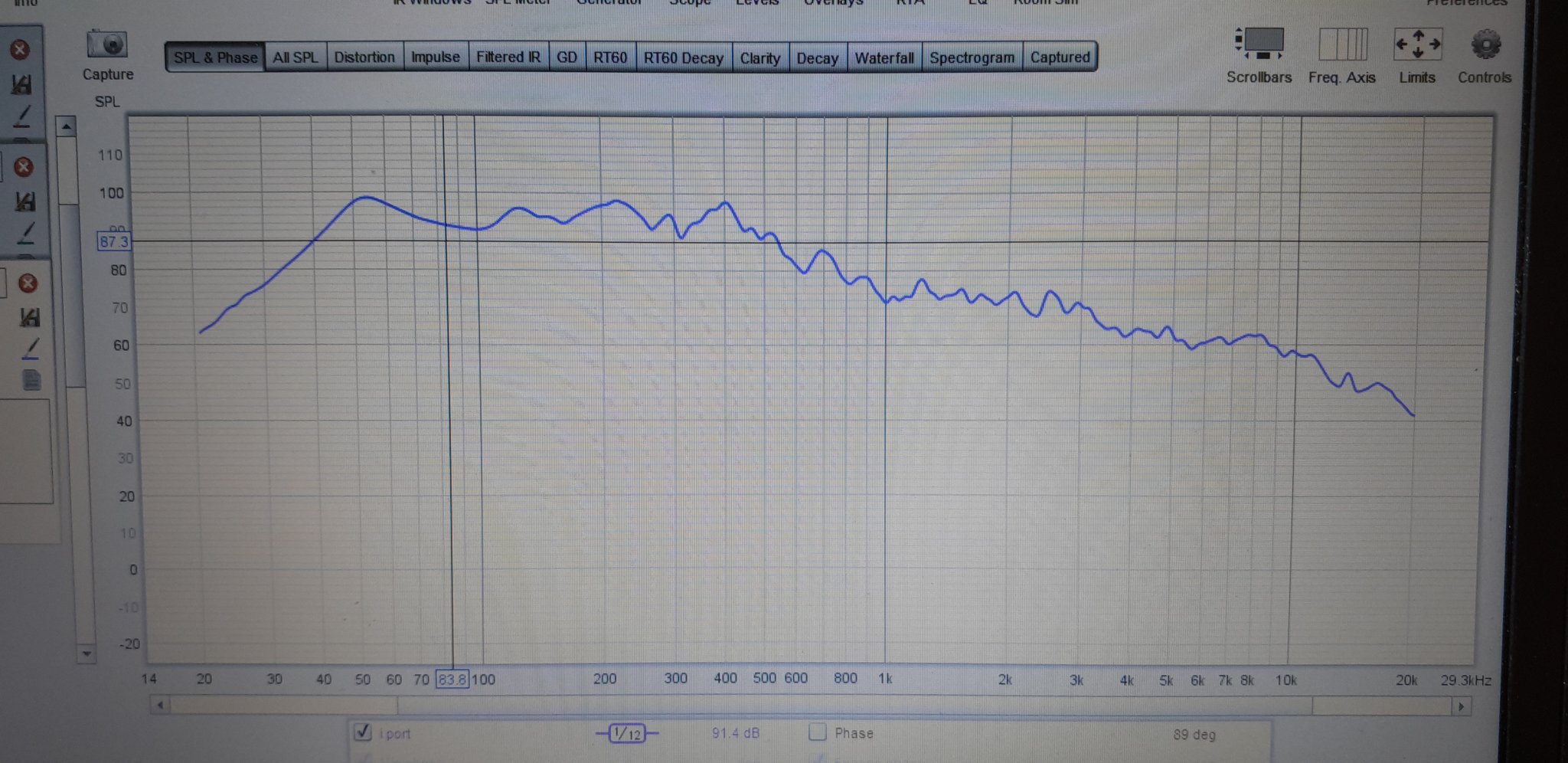

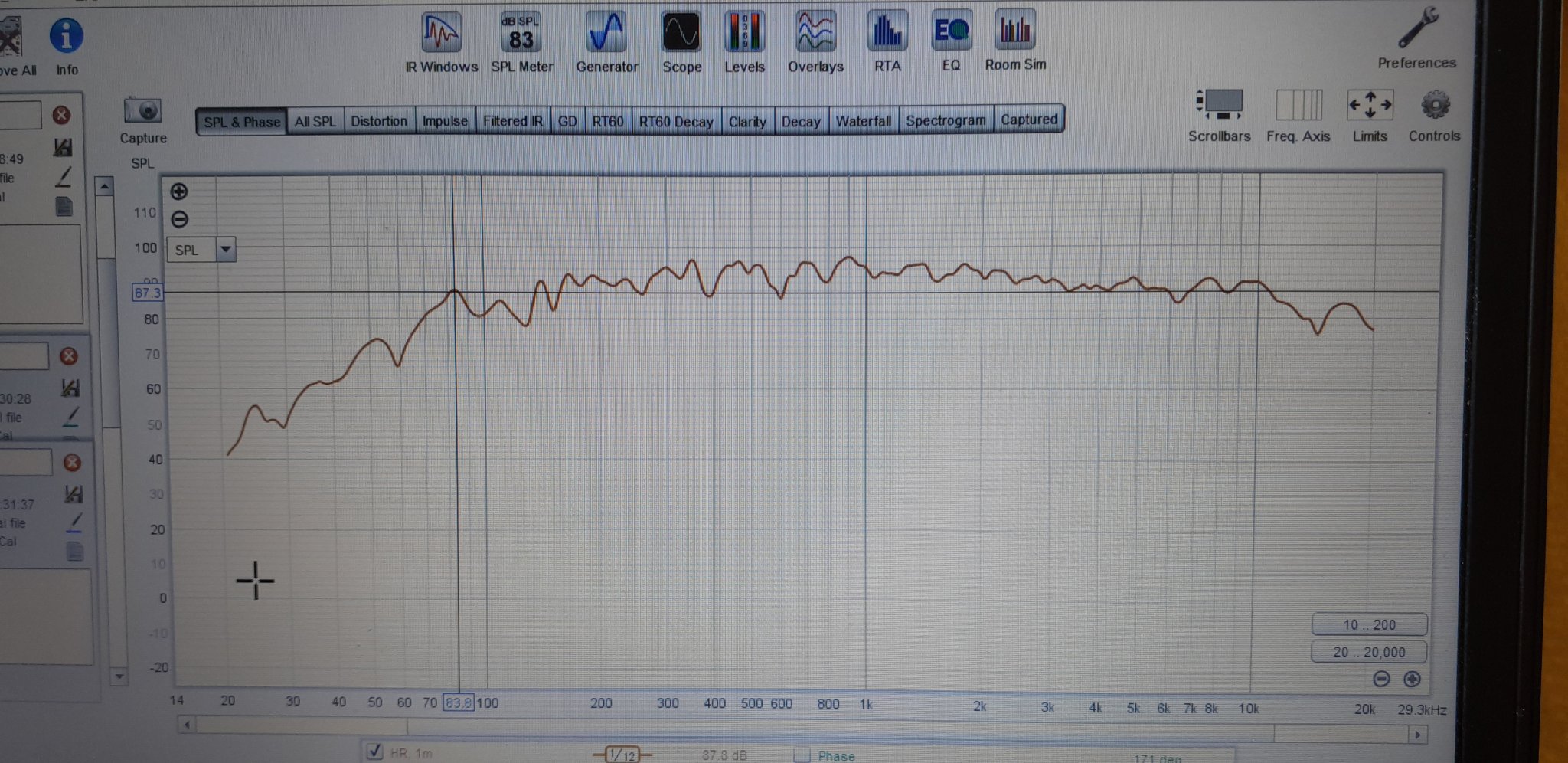

Deivers are TB W4-2142. The measurements are looking good, first measurement are in listening position, 2th are back close to the port. I looks like I can benefit with some deeper bas respons by adding a reflector behind the cabinets.

Hello PerCarlin:
Your speakers look nice.
I think you might consider adding a powered bass driver to augment the lower frequencies. Deflectors will help, yet it is unlikely they will bring up the bass very much. The issue is small drivers can only move a limited amount of air and are therefore limited in bass reproduction.
I hope this helps
I hope this helps
Whilw true, with the FH the room makes an even bigger difference given the room is used the last part of the loudspeaker.

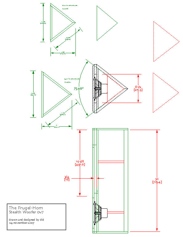

Along Scott suggestion, when you menioned deflector i thot about the ones i have with a stealth woofer hidden in it.
dave

The idea of the stealth woofer is an elegant solution in an open room as PerCarlin has.
Well worth considering

@planet10 do you have any link to those deflector / stealth woofers?
To be honest the reason i dod not mention it at first was because the woofer i used (SDX7eN) is NLA, and to do again means finding a woofer that will work in the volume/shape used.
And i have to do a proper drawing.
dave
How deep can FH mk3 go?
Heavily dependent on room, room placement, driver used, amount of damping and the amplifier used.
One can get into the 30s with everythign right, but worst case likely in the 60s.
dave
Not only how deep, but at what output?
Same parameters per-gain. Limited by the driver excursion, bass extention, and how much gain the room. room placement, amplifier provide. Typically not as much as a larger driver capable of moving more air.
dave
