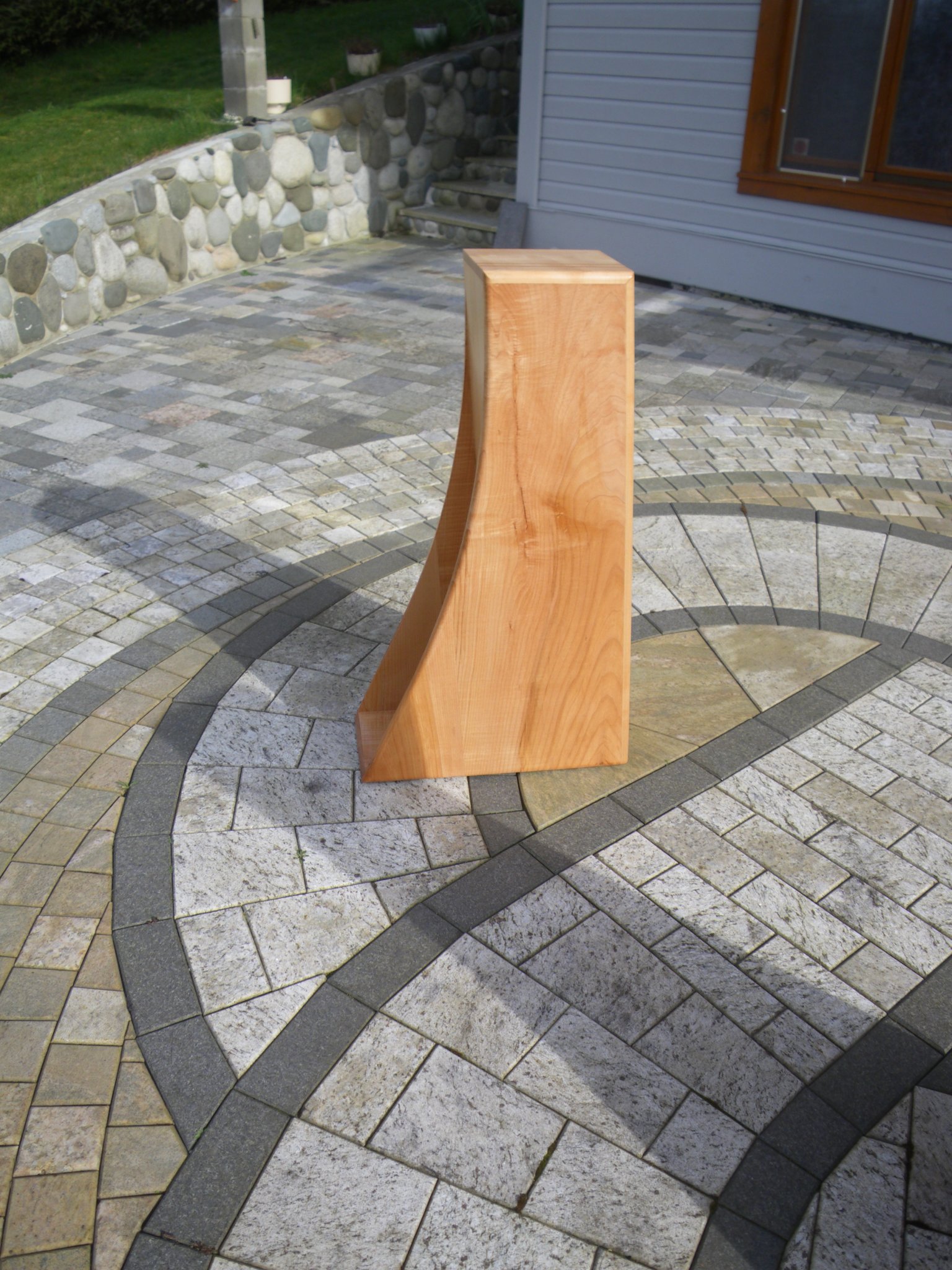

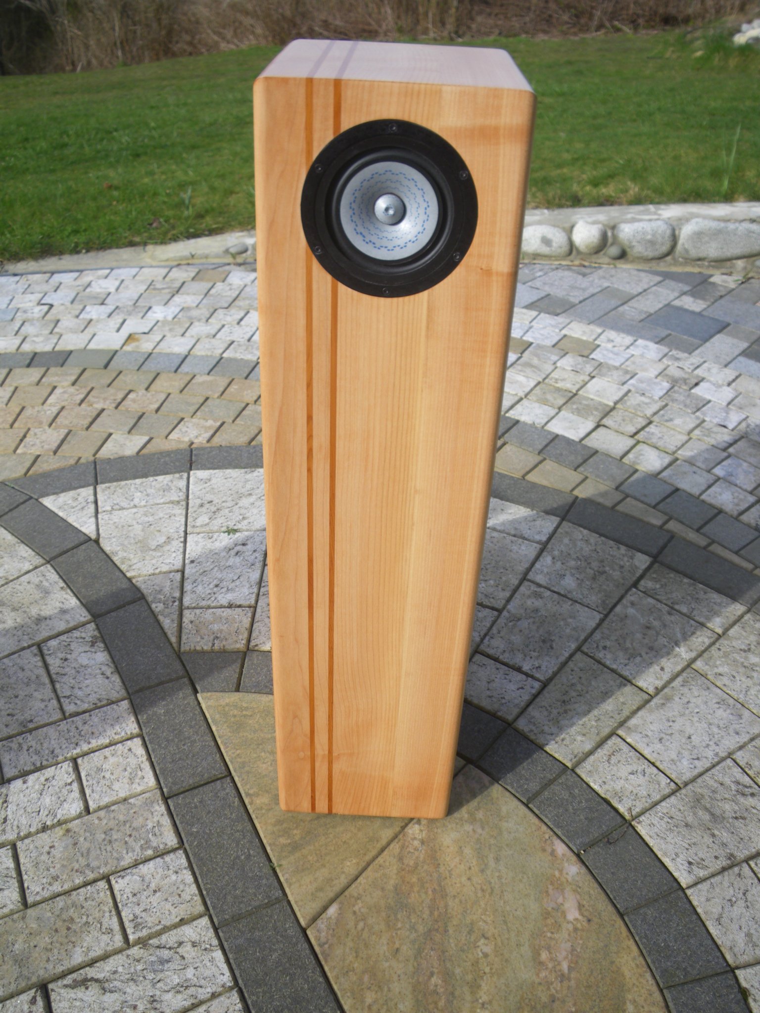

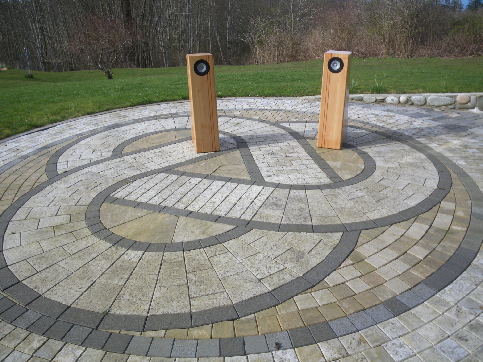

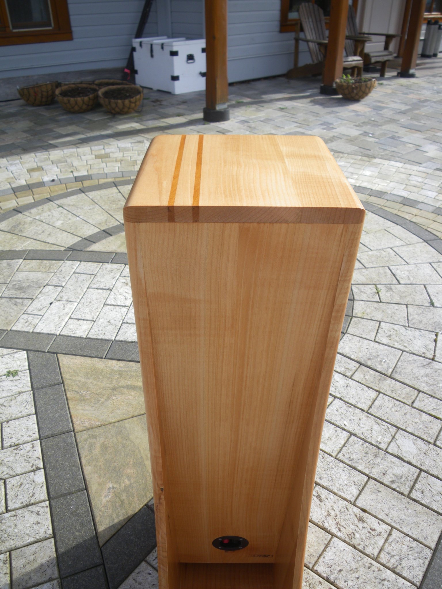

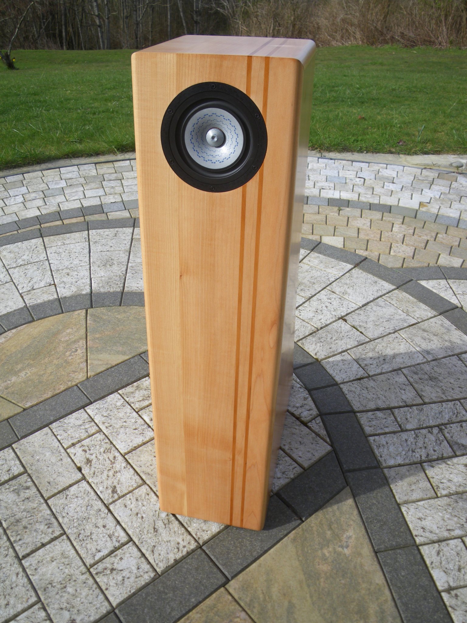

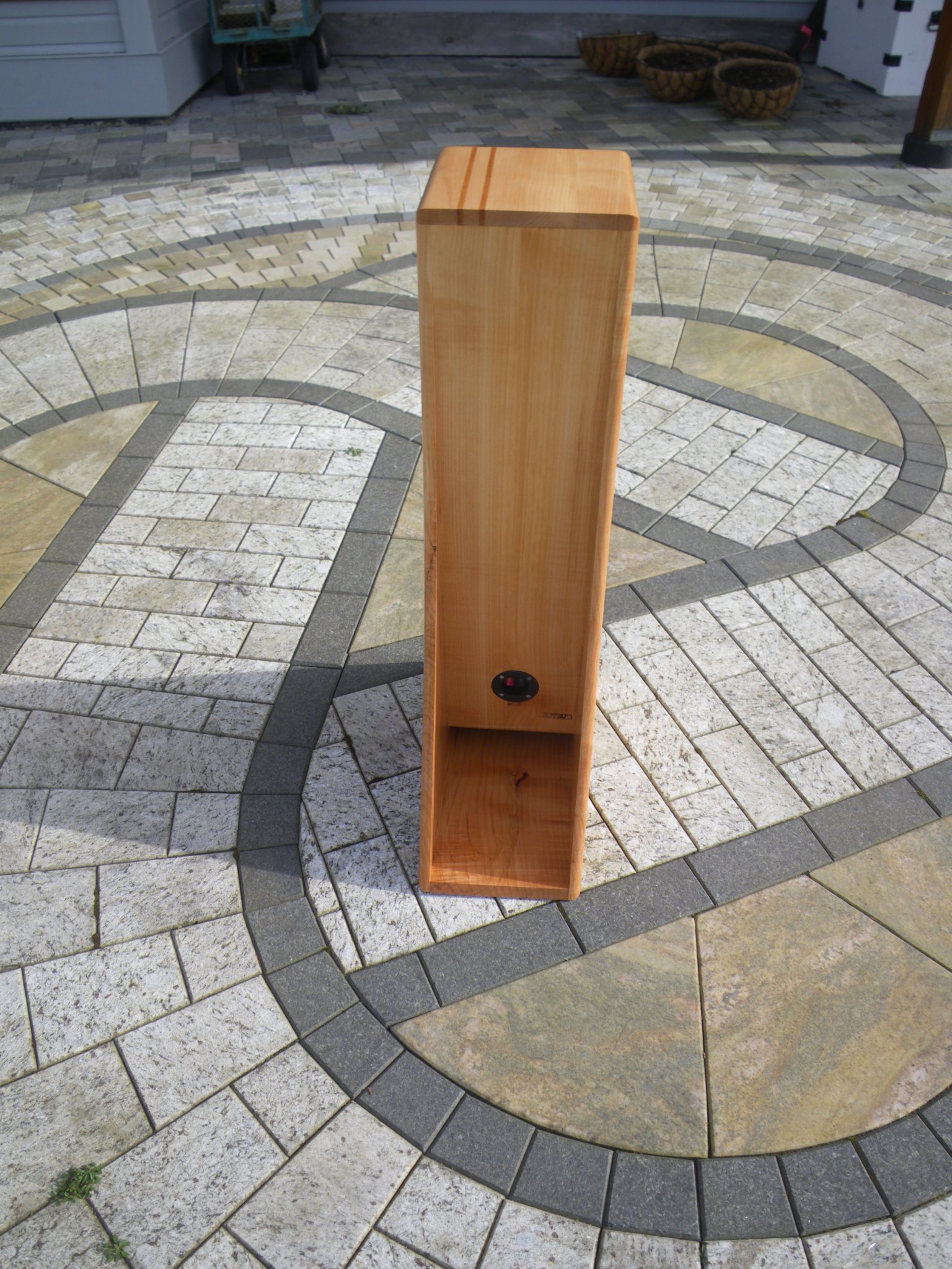

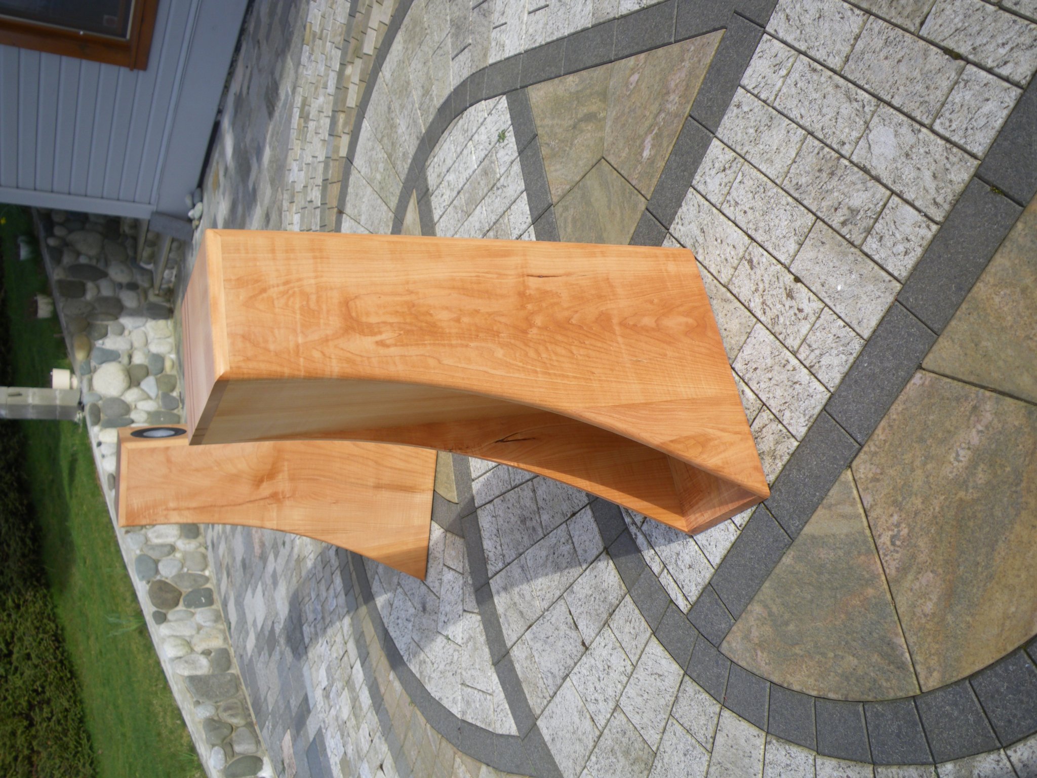

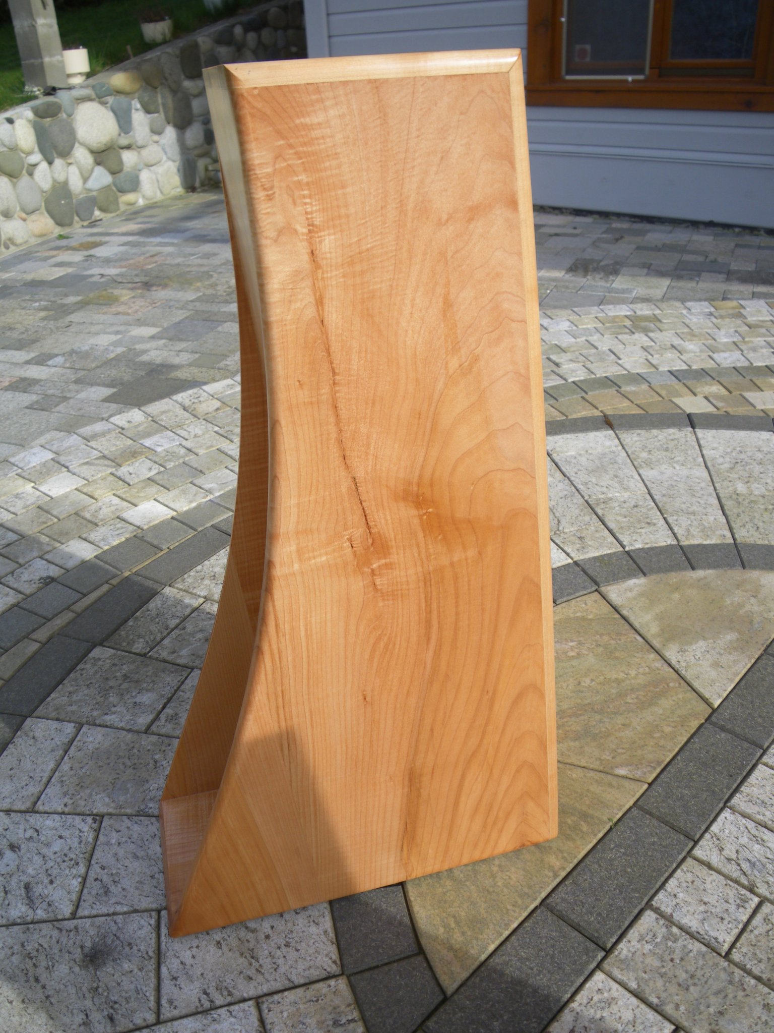

Was somebody interested in solid wood construction of a Frugal horn?
Here is a few pictures of the ones I built.
As Dave and others have said you need a bit of experience in working with wood before you tackle a project like this. But boy is it ever worth it if it works out for you.
Frugal horn XL with MA 10p Enabled by Dave
Made from 3/4 inch Big Leaf Maple planks with 1/4 inch strips of Pacific Yew inserts. All solid wood inside and out.
Sound is quite amazing with a pair of 8inch sown firing helper subs.
Enjoy

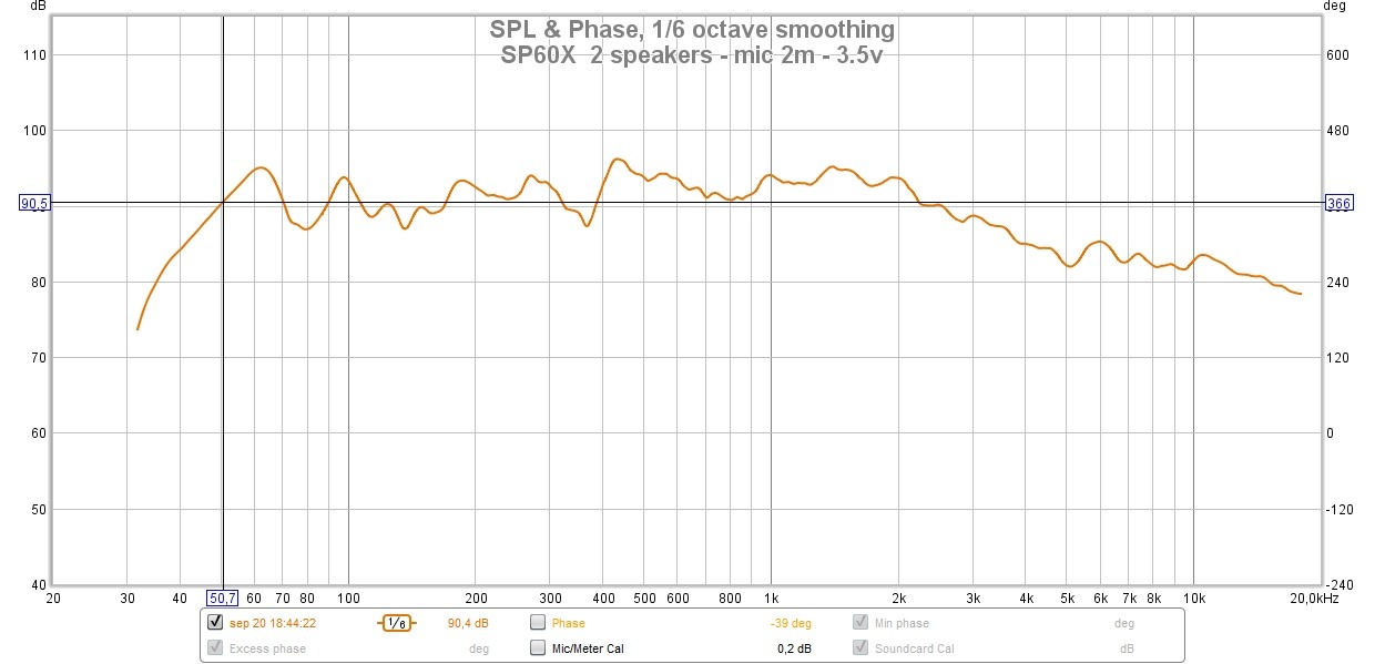

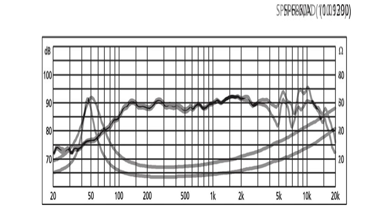

I've tried SPH-60X in FH3 and works fine. High sensitivity and good bass extension, flat to 50Hz in my room. Very nice playing rock and movies.
60X Lacks a bit in highs, SHP68X is said to have better treble (I have not tested).
It looks like the -68X/AD are about 5db higher above 3-4kHz. So there are some improvement compared to -60X. However are datasheets only datasheets and reality are reality. I think I go for the -68X/AD when it's time.
Wow, what a nice job. Just having them for looking at would do let alone using them. 😎Was somebody interested in solid wood construction of a Frugal horn?

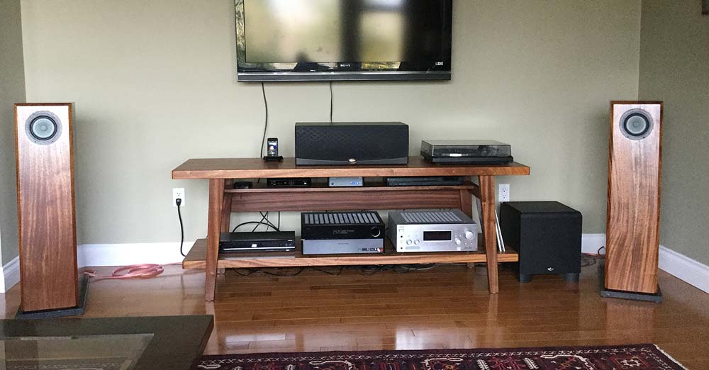

Scott’s ar emore interesting with the Yew inserts, but Berie did a set of Mahogany FHXL alos with A10PeN.
And matching stand.
dave
And matching stand.
dave

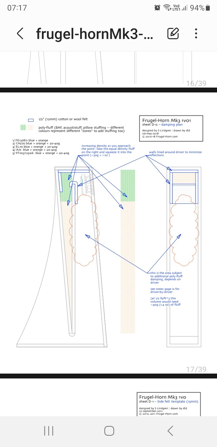

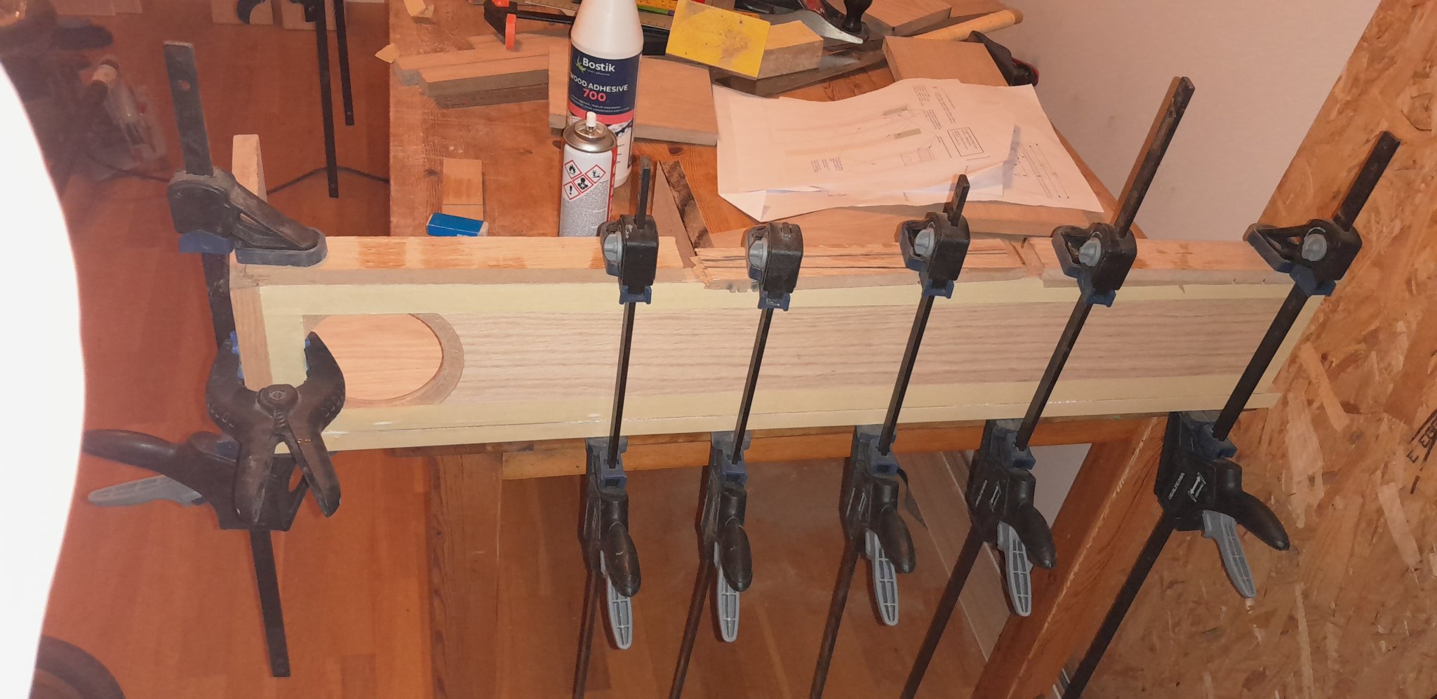

I have started my FH mk3 build and this week will I add the stuffing before I Close the cabinet.
I'm struggling a little by understanding the stuffing-page in the plans.
What I have in my hands are
10mm felt-mat.
Acousta-stuff, synthetic fibres
Drivers are TG W4-2142.
The felt are no problem, I will add according to the blue on the drawing.
But what about the Acousta-stuff.
How much do I ad to the orange zone? What can I expect to add to the red-cloudish zone?
The orange will be fixed after closing the cabinet, the red are hopfully adjustable....

30 g in the point. The tricky part is getting the density right. You want it to be denser at the point. The guidline is. tease very well, gathe rinto an equal amount the length of the file area. Then try to stuff it in such that you ar eputting the same amount thruout the pink ignoring that it is triangular. That makes it denser at the point and graduaky decreasing density to the top.
The bit in the front is where you adjust for driver, room room placement, amplifier output impedance, and taste.

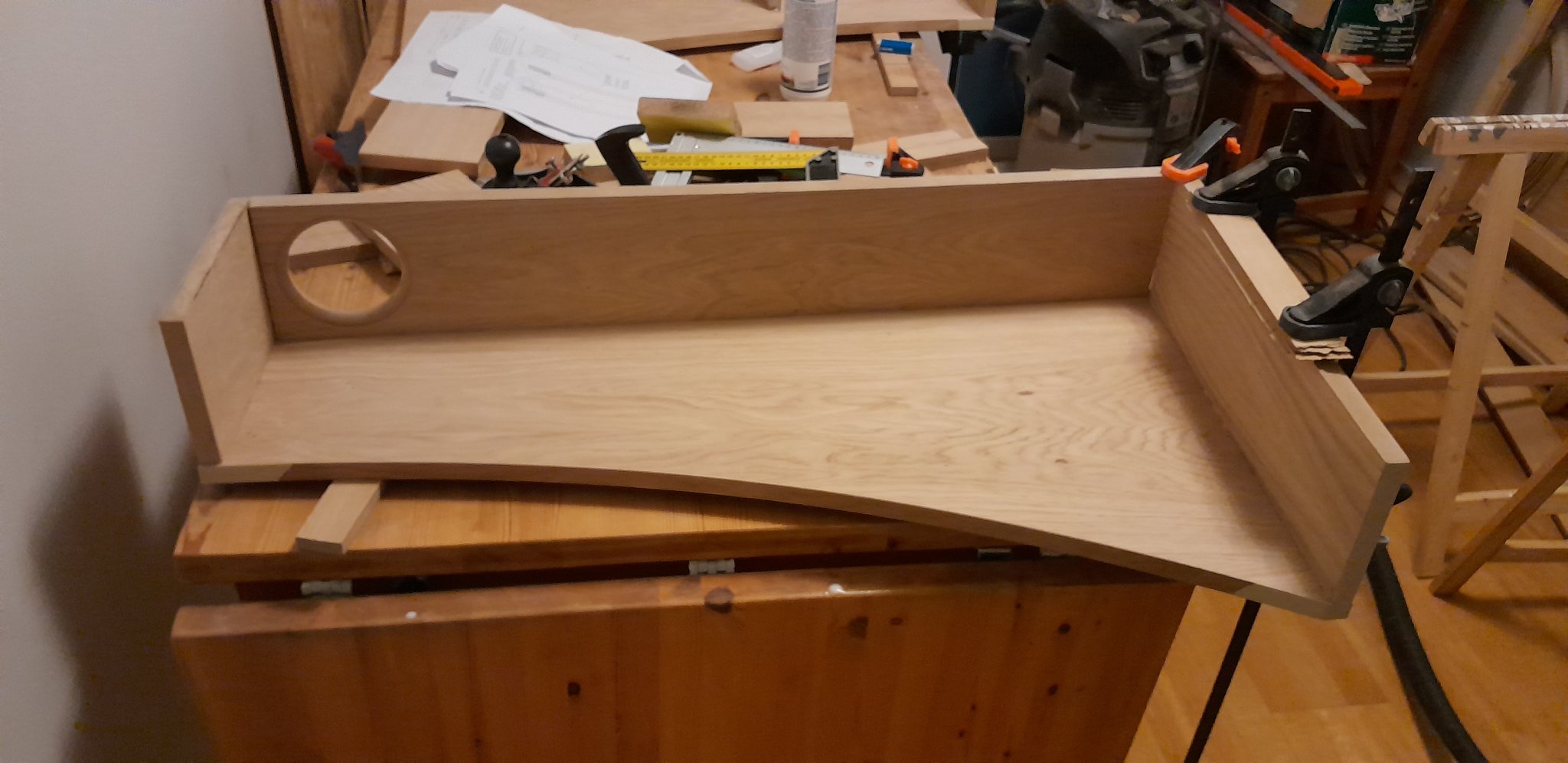

PerCarlin,
Just taking a casual glance at your photos. I may building these cabinets sometime in the spring. Even though they look relatively simple to build, is there anything so far that might have given you pause about the process? Also, you got to tell me which hand plane it is shown in the background of one of the photos. Been doing it that way myself for a number of years.
Hand plane: one of many in my workshop, don't know any brand or number. I take the one that I need for the moment. I can take a photo of it tomorrow.
Show stoppers: don't know yet.

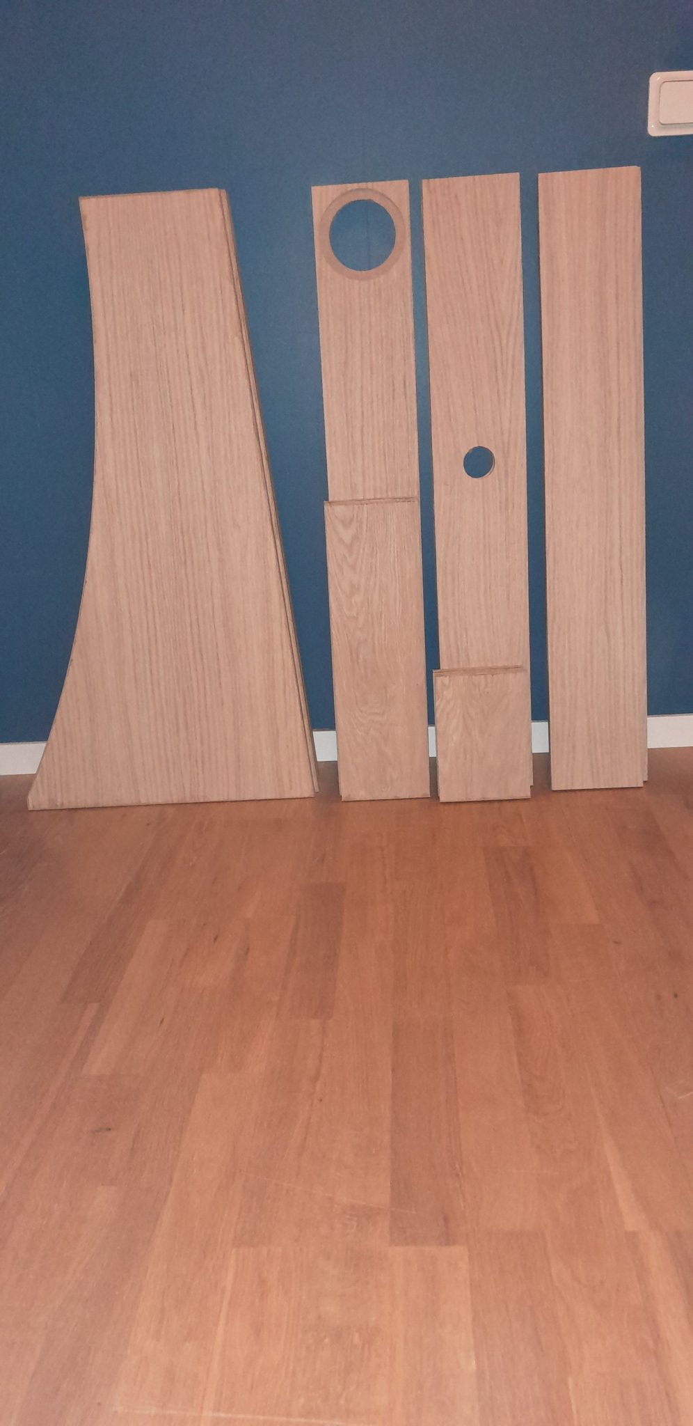

I had the sides CNC-milled, would been a disaster with my jigsaw.
Measure twice, cut once are always a good recommendation.
All other panels are 140mm wide. I guess that cutting these with consistant width are crucial, if one side are 138 and the other are 143 will it be tough to close the cabinets without big airgaps.
