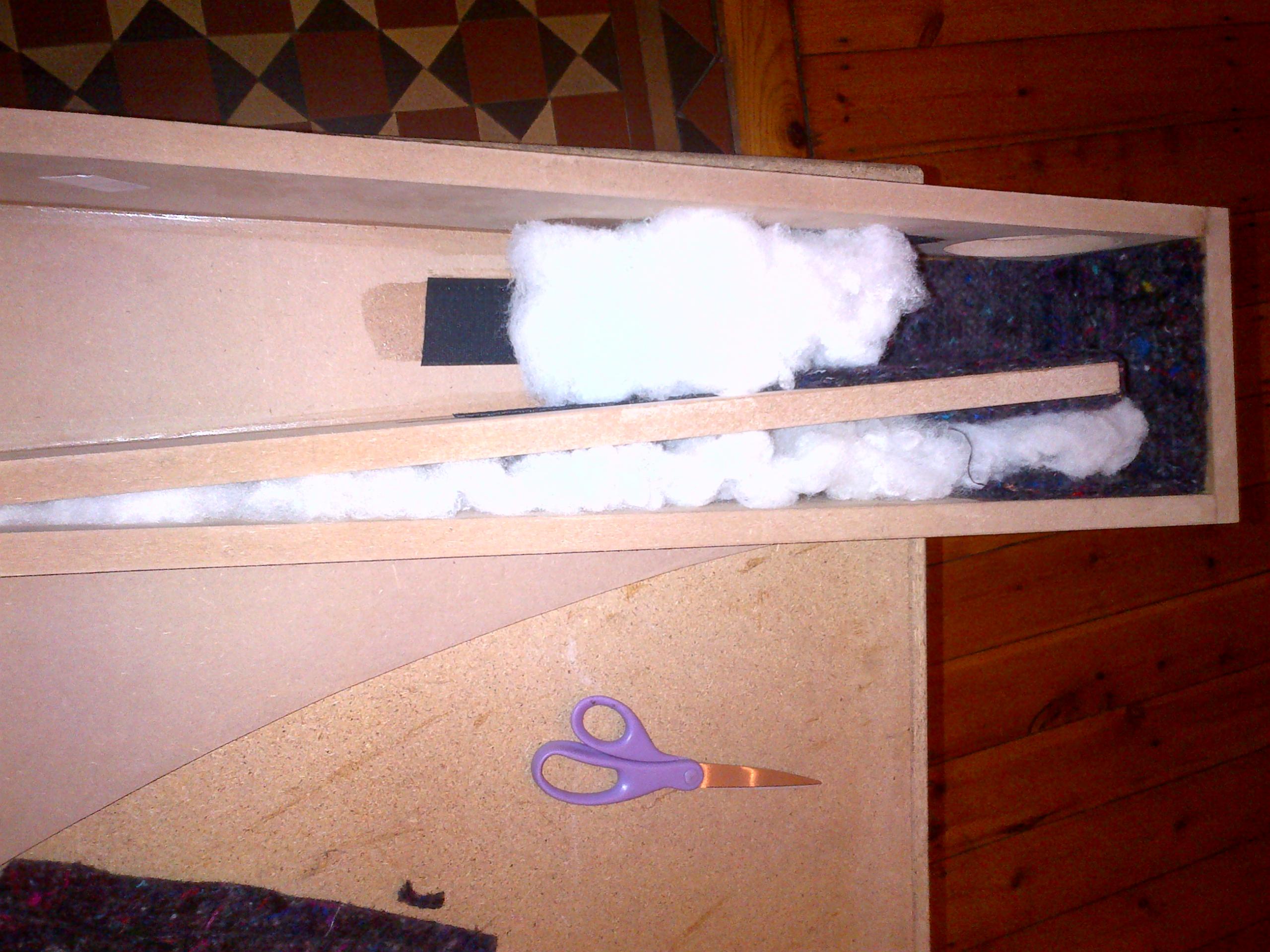

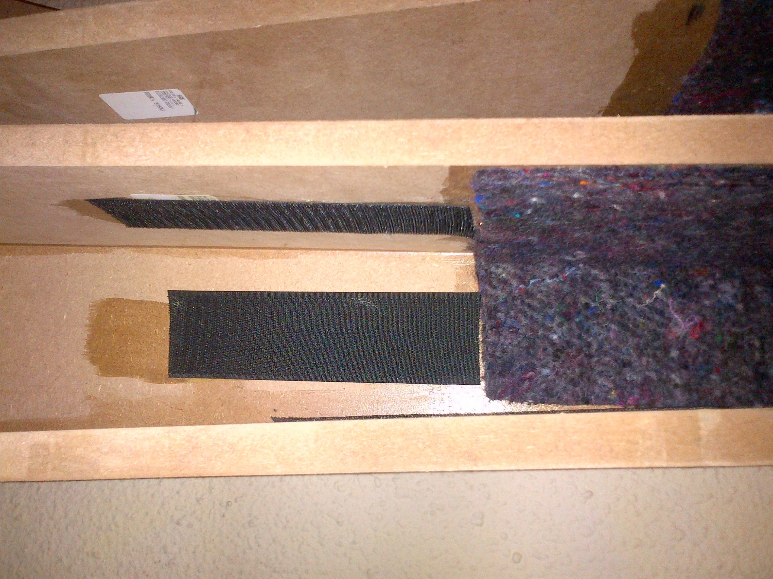

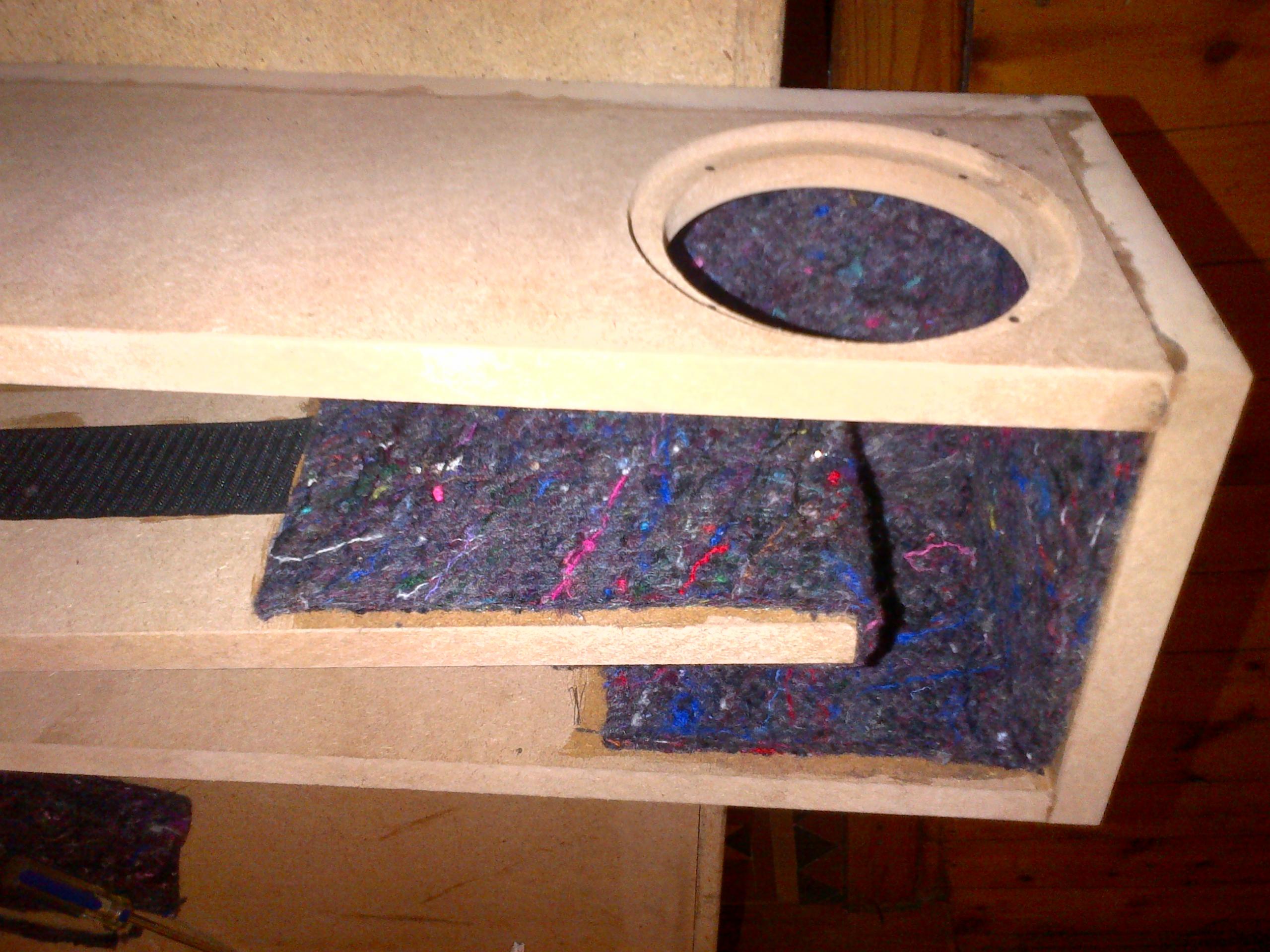

Hi Dave please help, I have attached some pics of my attempt to stuffing the FH3's. You mention carefull stuffing...does the stuffing in the V look OK (see pic1) or do I need to fluff it more. I found it quite difficult to not get those clumps of stuffing. Also, the felt I'm using is not quite as thick as 12mm, prob 8-10mm (see pic2), is this OK or should I put another layer over the existing?
BTW - I have 30g in the V and 20g in the throat as you see it. I also stuck valcro down the side panels of the throat (see pic3) to prevent the stuffing from falling to the bottom.
Thanks!
