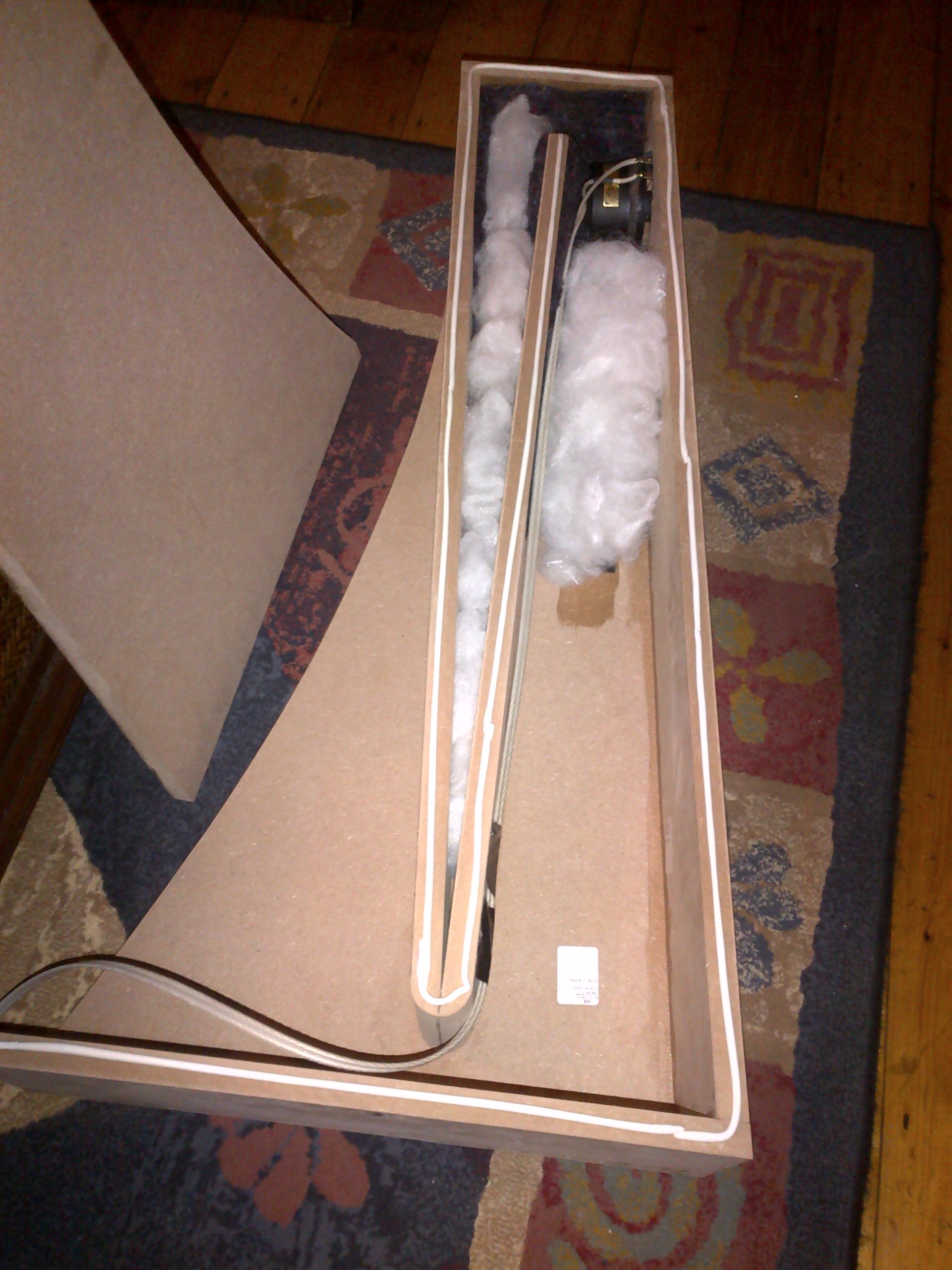

Where did you get the felt? IE what kind of store?Hi Dave please help, I have attached some pics of my attempt to stuffing the FH3's. You mention carefull stuffing...does the stuffing in the V look OK (see pic1) or do I need to fluff it more. I found it quite difficult to not get those clumps of stuffing. Also, the felt I'm using is not quite as thick as 12mm, prob 8-10mm (see pic2), is this OK or should I put another layer over the existing?
BTW - I have 30g in the V and 20g in the throat as you see it. I also stuck valcro down the side panels of the throat (see pic3) to prevent the stuffing from falling to the bottom.
Thanks!
If I understand you correctly I should put a second layer of felt on the inside panel behind the driver, the piece that folds from behind the driver around to the V section?
Yes.

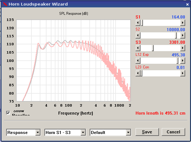

That choke in the output of the horn intrigued me. I had never seen that kind of thing before and at first I thought that we were looking at a mass loaded transmission line rather than a horn. I began pondering the use of the concept in FLHs and so I did a simulation in hornresp of a 30Hz FLH with smaller than ideal mouth area. I then added a choke to the mouth of the horn. Lo and behold the response flattened (mid range came down slightly and the low end droop was countered) with a slight increase in ripple throughout the passband.
I wonder if this would bear out in reality. If so it could be very useful in making smaller bass horns. I figured that a choke would destroy the efficiency but it doesn't really look that way, if of reasonable amount.
I will post sims later but just thought I would share.
Scott posted his sims of this long time ago.
dave
As far as FH3 is concerned, the choke functions purely as a (relatively mild) low-pass filter with no significant impact on Fc or Fo.

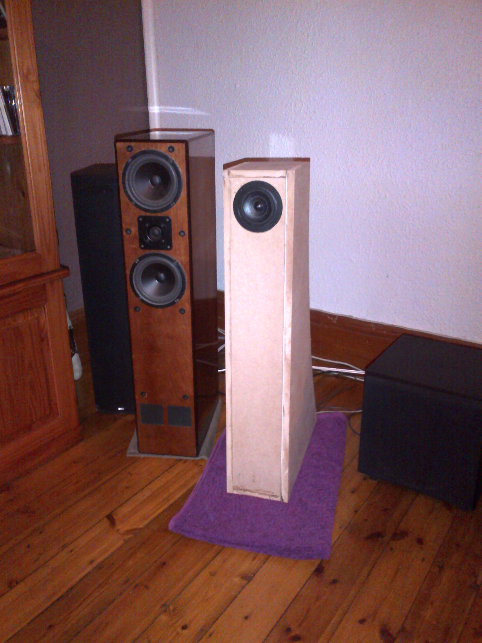

First listening impressions
Last night I managed to put the FH3's "together" for the first time. One side panel of each was stuck on with sticky tac (see pics)
At first I was very impressed and had a smile on my face. Female vocals sounded very good, Diana Krall had new life in her CD's that I know very well. After some more listening to other source material such as Jack Johnson's Sleep through the Static I found that there was a brightness that was quite harsh and listening fatigue set in. Other genres like Jazz at the Pawnshop sounded good with the sax sounding very accurate and all instruments were easily distinguishable and well separated but overall I thought the FH3's were lacking warmth and body. The upper midrange is too dominant...I think.
So, I would like to know where to go from here with the stuffing arrangement. As I mentioned before I have 30g in the V and 20g in the mouth below the driver. I have another 20g to add to the 20g in the mouth but what can I expect to change or rather in which direction should I go? Any suggestions on improvements will be appreciated.
