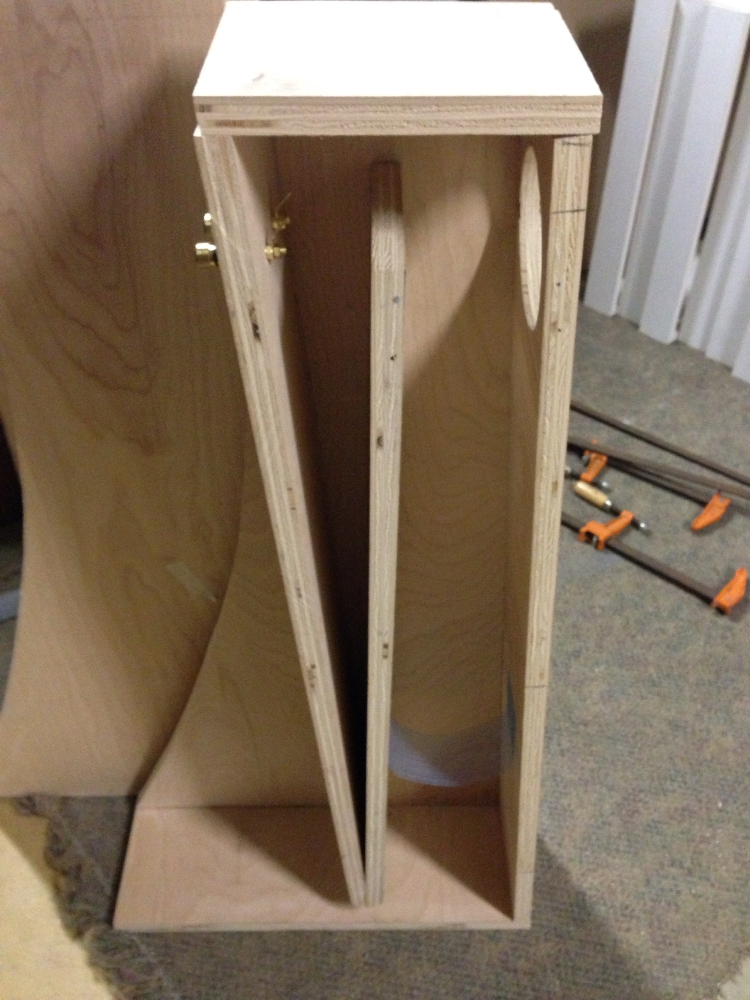

Chamfered edge on back of driver cutout
So I made a minor boo boo ... I glued the baffles in place before I chamfered the back edge of the drive cutout. How critical is it that this is chamfered? I'm using the CHP70 drivers if it matters. And if I do need to chamfer the holes, and suggestions on how to best do it at is point? I'm attaching a pic to show the stage they're at right now. Thanks for the help!
Just use a rasp to get the same effect. It will take just several minutes per hole to do a really good job (considering it's plywood). It is challenging to rasp the part near the side panel (not much clearance), but that doesn't matter as long as you rasp out everything you can (while still leaving enough for the screws -- but the screws don't need much in my experience).
(Plenty of commercial designs don't chamfer / rasp at all, so whatever you do puts you way ahead.)
It also appears that the cutouts weren't rebated for flush mounting - whatever your opinion might be as to the effects of that, on drivers as shallow overall and with as thick a mounting flange as all of the MA, it will further emphasizes the constriction immediately behind the cone.
mr Bond is correct about many commercial products not being chamfered, but they're also more likely to be CNC machined with rebates, and many OEM drivers have much thinner mounting flanges
