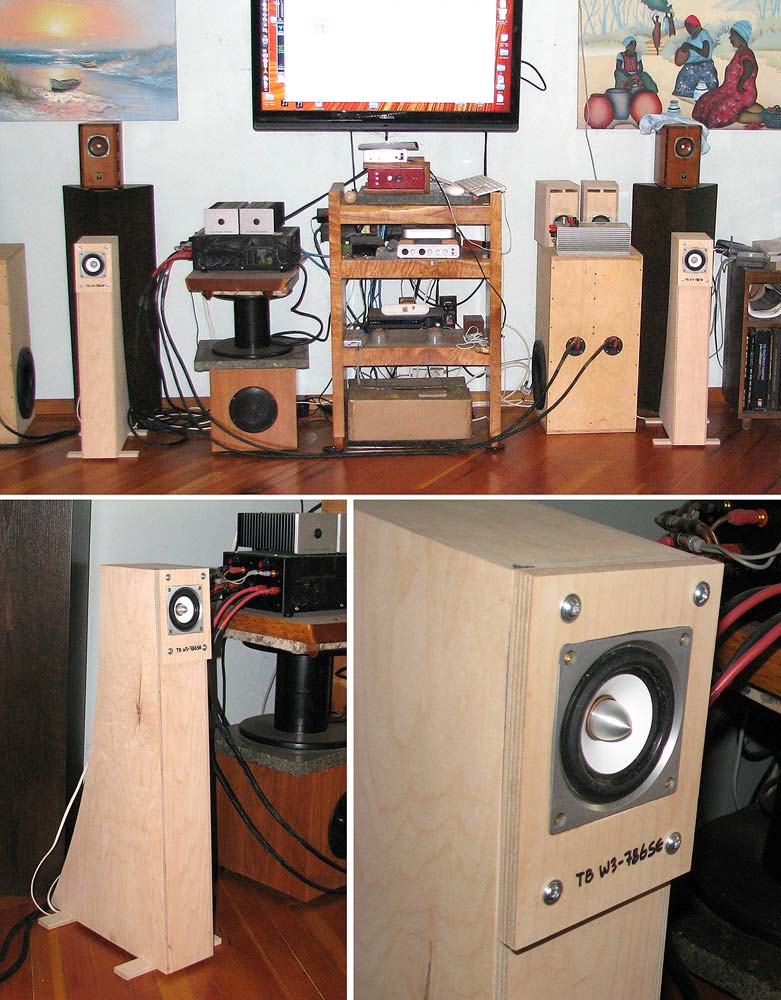

Since we are building all the FH-Lite flatpaks with vestigual supraBaffles i got Chris to whip up some baffles for a couple pair of older 3" we have kicking around.
The 1st was the TB W3-786se. These are serial #1&2 and i don't know if any more even exist. They sound quite good, perhaps need for a tad more damping upfront. They go off for treatment now.
Pictures & more info on the driver here from 2002: http://www.diyaudio.com/forums/full-range/8054-tale-two-tangbands.html
