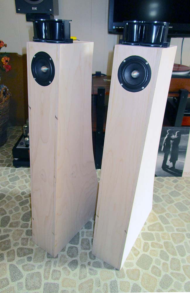

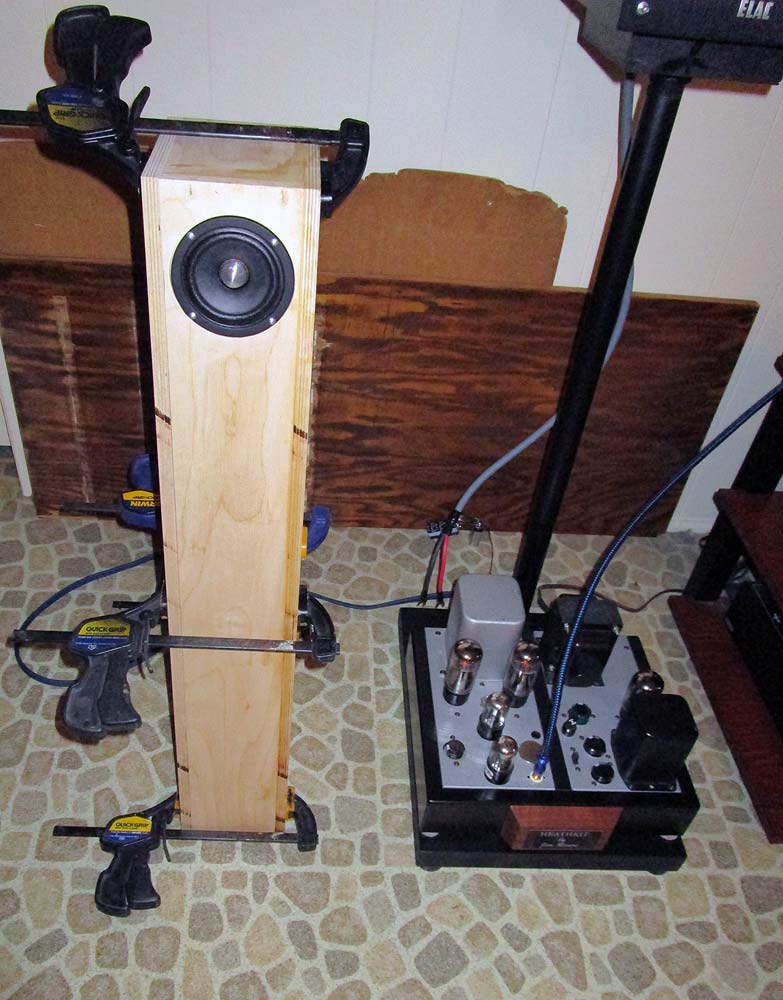

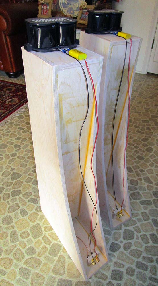

I finished my tweeter section for the FHLite with the Aura NS3.
Of course the soundstage is much wider now and the Aura plays more "free".
The additional air is very welcome to my ears and the sound of this system is incredible!
The x-over and tweeter are of kit of Quint-Store if someone is interested.
These speakers can play nearly each kind of music without detected lacking in any region.
I must say it again "Gentleman; give it a try!". It is so much speaker on such a small space.
This speaker is a beatuiful playground for everyone who want to test different stuffing behaviours;
tweaking the speaker with an active/passive XO or just for enjoying the minimalism of a well playing fullranger!
I hope this thread will get more pics and comments of happy builders.

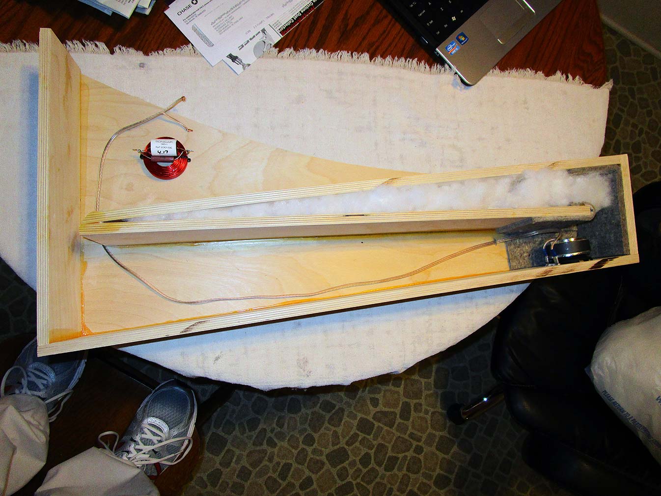

I'm in the build process for a pair of Frugelhorn Lites with the FF85WK's (ETF2015 is approaching...)
I'm stumbling over the stuffing instructions given in the pdf: "Take the equal density fluff on the right and squeeze it into the point (~18g = 0.61 oz )"
Here i'm stuck with necessary quantities of polyfluff:
- Does the orange zone get it's 18g of stuffing AND the green zone its 18gr of stuffing ?
- Does the front-zone get 24gr of polyfluff for the FF85WK driver ?
If someone could share his knowledge here, i'd be grateful.

The green & the back orange get the same 18g.
The 24 g is the estimate for the FF85wk. How much you use in the end is also dependent on room placement and taste. More for less bass quantity (but perhaps a bit smoother).
dave

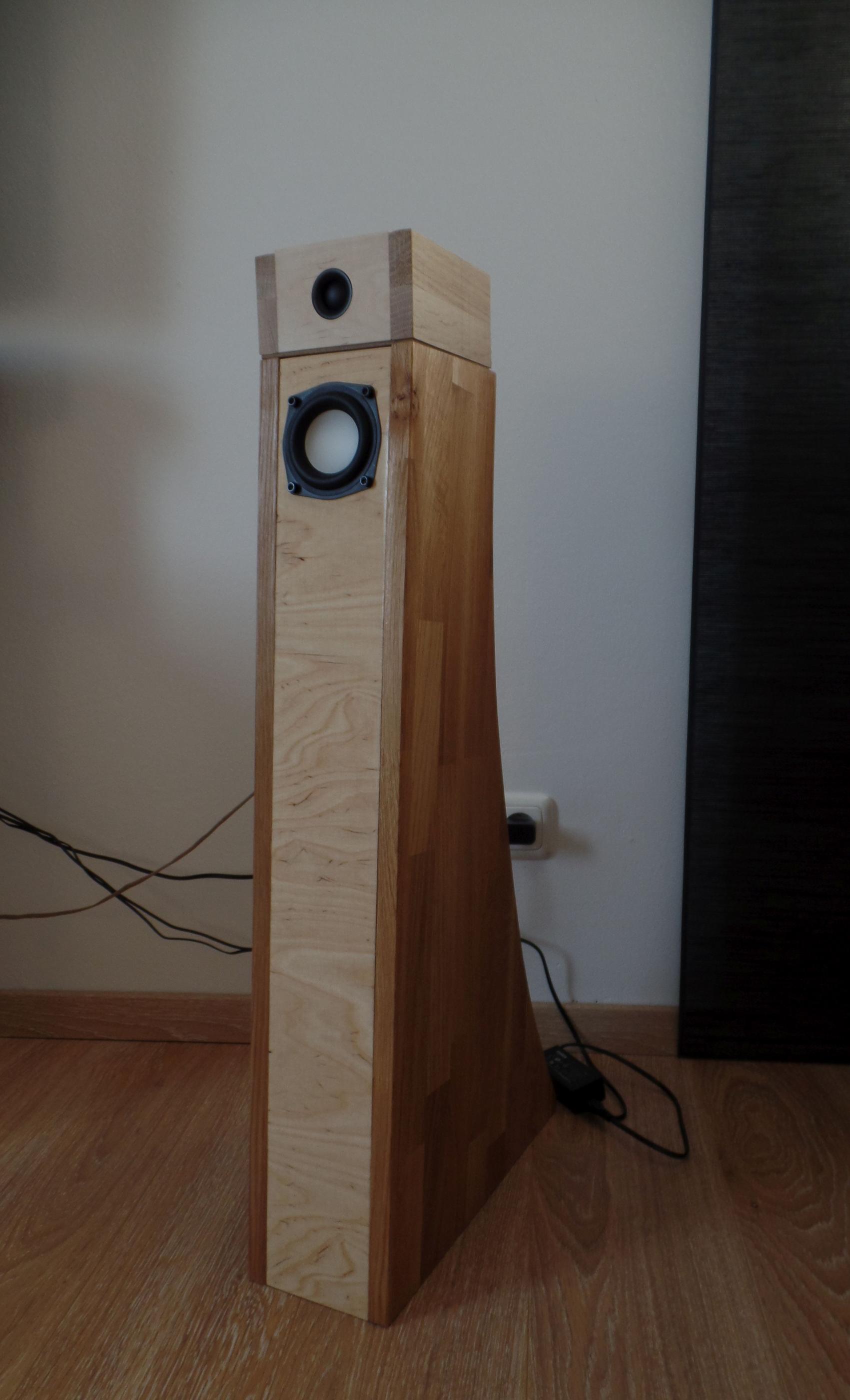

Hello all,
I made a pair of FH Lite with vifa TC9FD-18-08, and they are VERY VERY GOOD. Smooth and extended sound, very detailed and natural. Non fatiguing.
The amp is an ACA (thanks Mr Pass) and the combo sounds very well, 6w is enough for most music and movies.
They are revealing speakers. If music is bad recorded, sounds really bad, with the best ones they are amazing. In "Skating away" Ian anderson is having breakfast beside me!!.
If you want a small, cheap and high WAF pair of speakers, this is one of the best. Not so difficult to make, a jigsaw is enough (jigsaw + router is all i used).
Really small and nice looking, the red one is a Tabaq
Thank you for a great design
And sorry for my English 🙂
Victor
