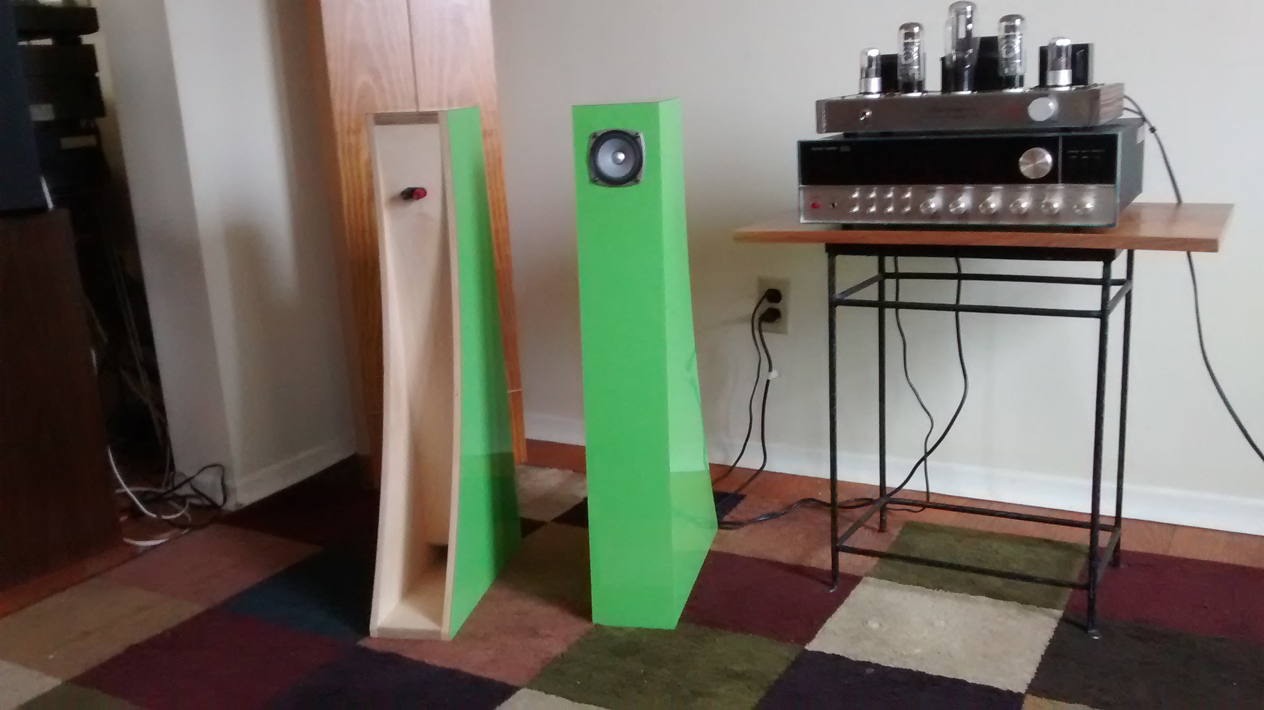

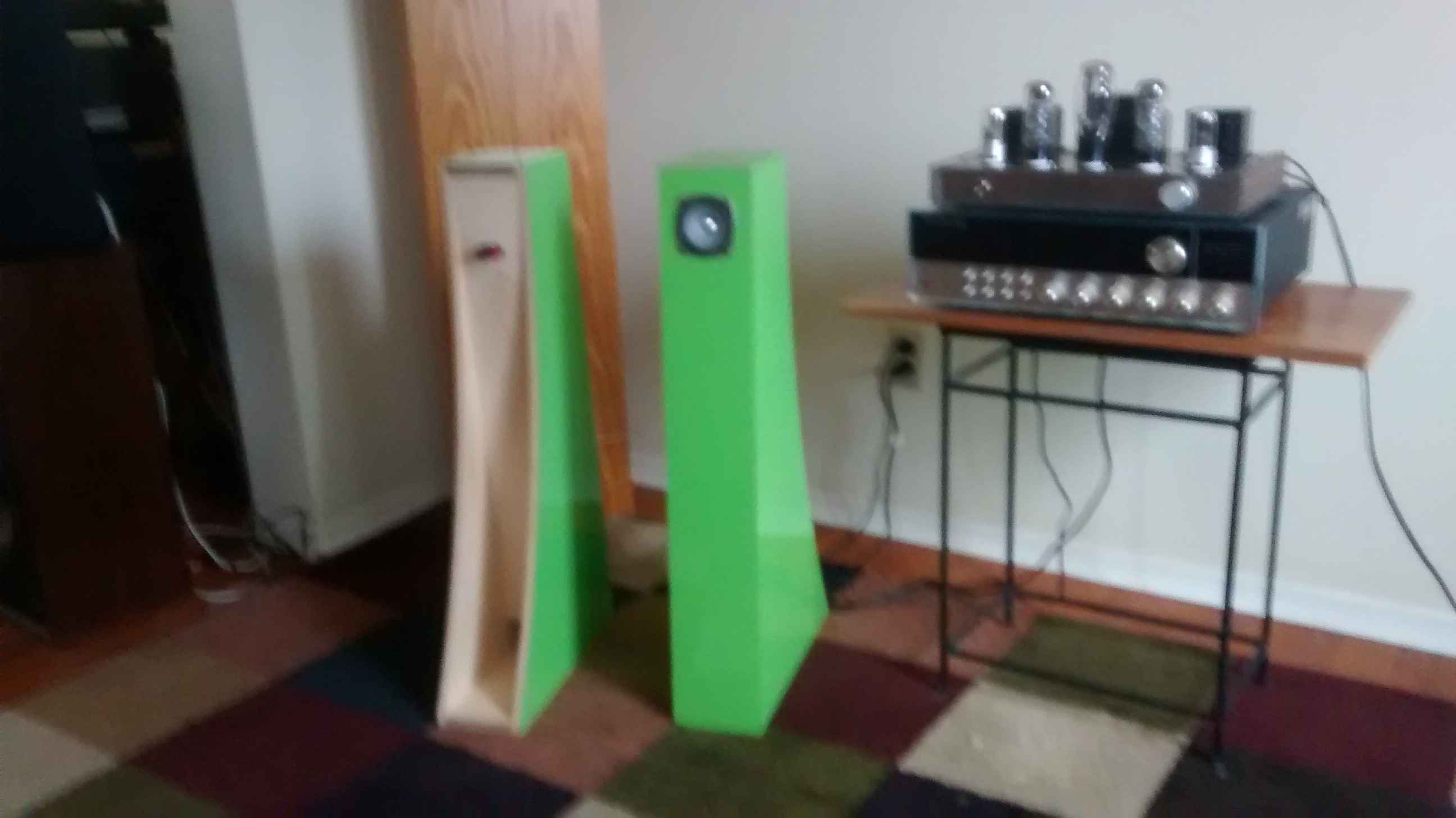

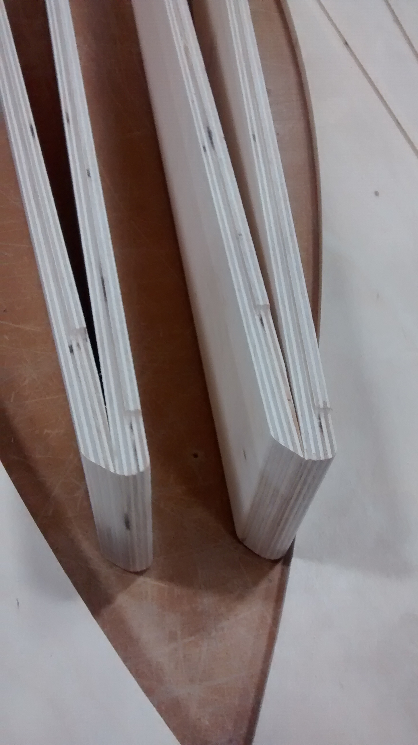

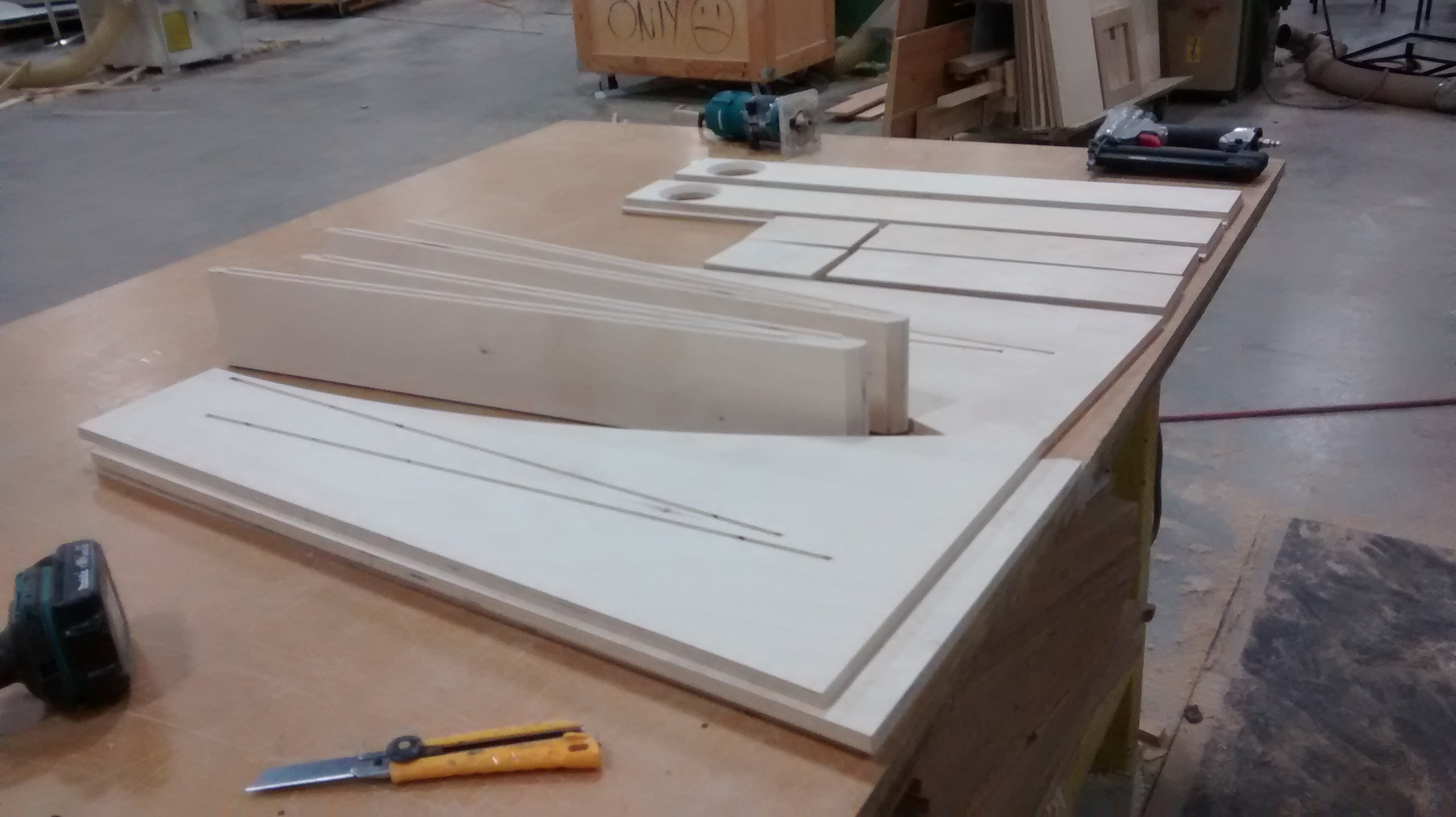

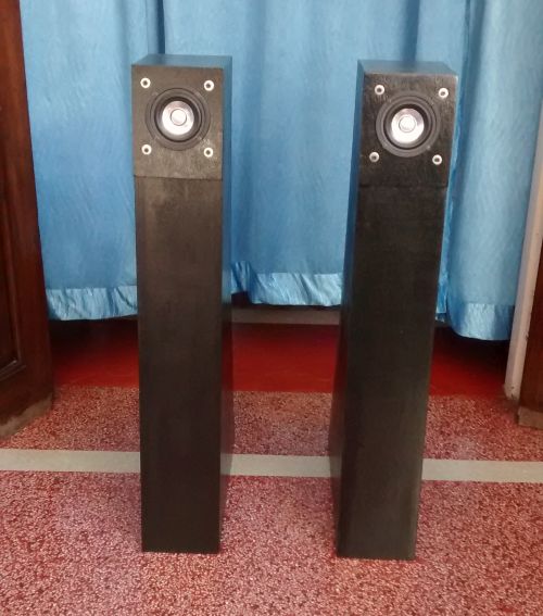

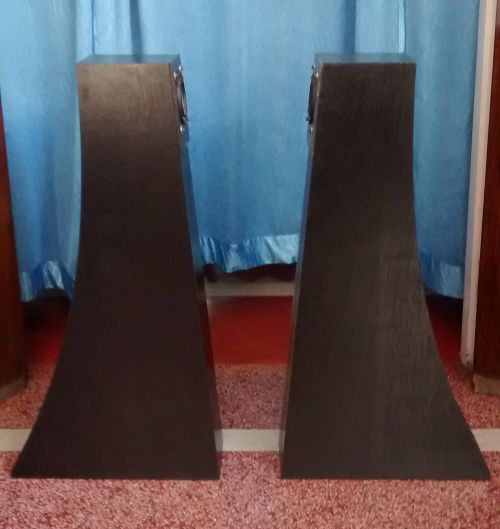

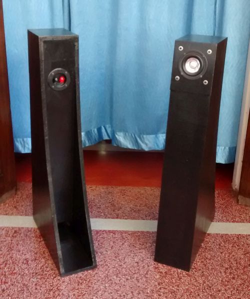

It took me five hours start to finish to build these speakers, not counting the hole jig and gable pattern which were made before hand.
Writing this post and trying to upload pictures (which I'm still attempting) has taken me longer.........I hate computers

Wow, such nicely constructed speakers...and in only 5 hours... I'm jealous!
Well done. Hopefully you are enjoying their music.

thanks plund. i do like the sound, so much that i take them over to friends. i like it when they try to find the sub.
as for the five hours........i'm a cabinet maker by trade, so it's easy peasy for me. i kept the jigs under my bench in case they would want to build a pair. but i don't enjoy building anything twice. maybe a pencil 10.3 next.

Are those FF85's you have in your FH lites?

yes, they are FF85's plund. i purchased a pair of alpha eminence 15's. i just don't know how i'm going use them with the fhorn lites..........more lurking required.

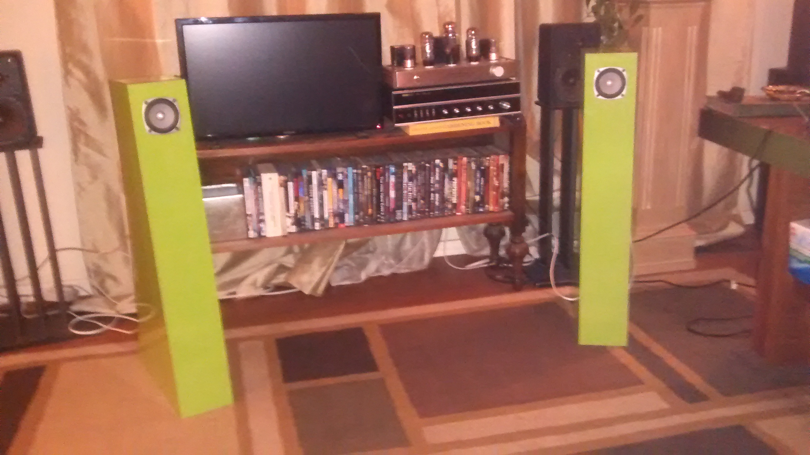

I apologize for not reporting in earlier. I completed my FH Lites with removable baffles in late November last year and just had time enough for a cursory first listen before the wife and I left for a long overdue holiday. Upon return the usual catching-up activities followed leaving me with hardly any time for some serious listening.
My first driver choice was the Fountek FE 85, a decision which was partly influenced by S4m’s glowing comments and also by my own experience with these drivers, having used them earlier in both the BR-MLTL Hybrids and the Fenceposts. The Fenceposts are decent speakers with adequate bass but somehow left one wishing for some improvement in the highs department.
Fountek FE85 – Not only was I surprised by the first impressions at my initial listen-in, it floored me absolutely! It was as though a cover had been removed from atop these drivers and they performed like they were a few notches higher up the quality ladder. A simple change of cabinets and a HUGE change in the characteristics of this humble driver. Amazing!
The soundstage, bass just the way I like it, good mids and clear, crisp highs – it was all there.
Tymphany TC9FD – Smoother and more controlled in Sound Quality and delivery with well defined highs, distinct mids and reasonable bass output. They gave a good overall performance with nice balance while listening although to my ears they sounded a wee bit more overpowering than the Founteks. That’s my personal opinion though and others may disagree…. 🙂

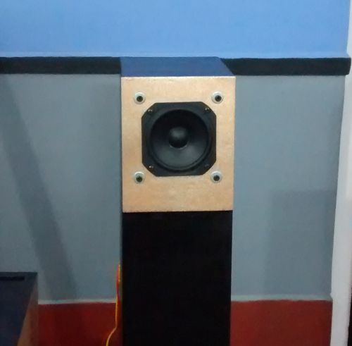

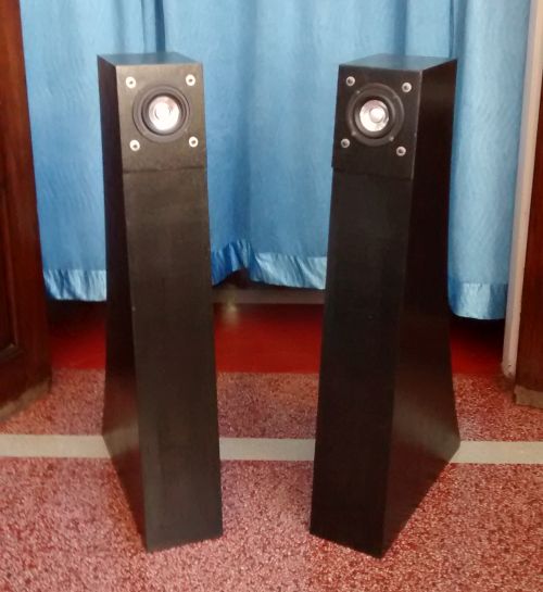

WOW this thread has come alive since I started lurking! I've had 2 pairs of 3" drivers just waiting for an enclosure and finally I stumble upon the FH series. I've got a pair of FE83 and some Olasonic woven somethings from DigiFi volume 19. The FE83 seem like they'd be better than FE85 but I'm new to reading T/S and really only basing my judgment on the CCAW vs plain copper and the higher xmax.
I haven't even finished these and I want to try the Tang Band W4-2142 in the FH3's - any thoughts? I found it weird that a W5 was recommended but then noticed that Tang Band's sizing is a bit off from other drivers...
Anyway no glue yet, better get to it.
