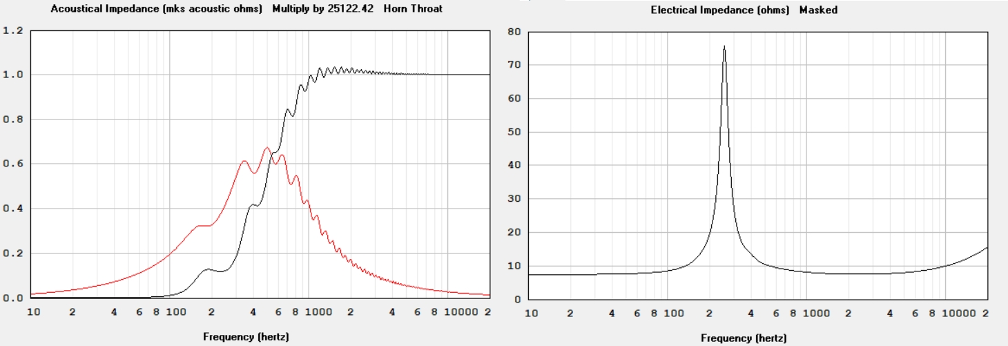

While all horns load to the surrounding air, this aspect is largely ignored when designing OS waveguides. I'd recommend using hornresp to assess the response you get from the rear chamber.does an OS Waveguide benefit from a resonant & closed back-chamber,

Loading type horns tend to lose some of their efficiency when you absorb the back wave. Fortunately, hornresp allows you to test absorption.
