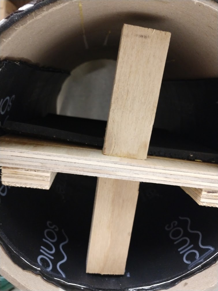

Most of the commentary here is very close to being 100% spot-on. But, please allow me to expand on this. A cardboard cylinder is indeed non resonant, but does have a "sound". We want 100% neutral. I used damping sheets on 1/2 of the outside, and then on the inside for the opposite half. A cylinder has a constant axial mode, so we want to eliminate that by using a "septum". The pictures are as viewed from behind, a.k.a. the exit to the world outside, but before absorbent material has been installed. !00% we want to emulate a quasi-transmission line, but not too much stuffing!! We only want delay (as has been mentioned previously) The septum should be cut to the dimension to where it barely touches the back of the driver, and does not block voice coil vents, if they exist. Again, this is NOT reactance nulling. The mass load, should by rights, affect the free air resonance, but not to a significant degree. The signal to the horn should be bandwidth limited- hi pass, as we don't' want to ask more of the horn than is possible. I have gotten great results from this method, I hope you all do, too.
