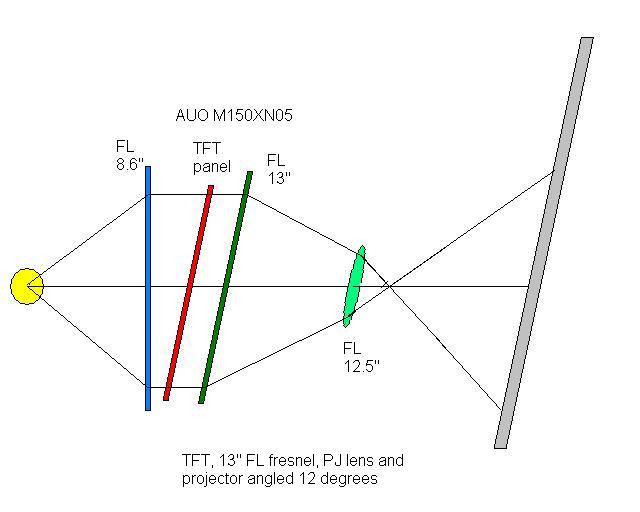

I'm building my projector. When you guys talk about one of the split fresnels being 13" from the light source, and the second fresnel being 9.8" ... is that 9.8" on the other side of the LCD?
I'm replicating Cruser's light tube, I'm a noob and I think it's a brillant idea. I just don't have a handle on the distance's yet. I
Tom
Tom
If you are using a diylabs Fresnel you have your Light source then you place your rear Fresnel lens about 8.9 inches away from the light, then a inch or 2 of space from your rear Fresnel lens put your lcd panel, then place your front Fresnel lens another inch or 2 away from your lcd and then put your triplet or other focusing lens in front of the front Fresnel close to its focal length (around 14 inchs or so if we are talking about the diylabs ones) and move it back and forth till it focuses. Look at Karnage’s post on the first page of this tread he has a little picture that should help illustrate.
Light - 8.9inch space - First Fresnel – 1-2 inch space – LCD – 1-2 inch space – front Fresnel – 14 inches or so of space - triplet lens.

I believe these two posts conflict. Which is the "correct" way to set up the fresnel lenses? Brainchild's results are awesome, and Space Ninja, your results are pretty sharp, so I was wondering if one way is better than the other. I would assume that having the longer focal point on the side of the triplet would allow a longer throw distance from the triplet, because of the angle that the light is entering the lens. I could be way off base here, but let me know what you think.
Thanks,
Steve
"If you are using a diylabs Fresnel you have your Light source then you place your rear Fresnel lens about 8.9 inches away from the light, then a inch or 2 of space from your rear Fresnel lens put your lcd panel, then place your front Fresnel lens another inch or 2 away from your lcd and then put your triplet or other focusing lens in front of the front Fresnel close to its focal length (around 14 inchs or so if we are talking about the diylabs ones) and move it back and forth till it focuses. Look at Karnage’s post on the first page of this tread he has a little picture that should help illustrate.
Light - 8.9inch space - First Fresnel – 1-2 inch space – LCD – 1-2 inch space – front Fresnel – 14 inches or so of space - triplet lens."--Space Ninja
"The bulb should be located close to the focus of your collimating fresnel, and the objective lens should be located slightly before the focus of your condensing fresnel. If you have a 14"FL collimating fresnel you would want your bulb close to 14" away. If you've already built your enclosure and you now need shorter FL optics, I would suggest picking up a couple of 9"FL fresnels, cutting them down to size and seeing if you can make them work with your rig. Alan and others have the 'back' shorter FL fresnels. The general consensus is that a longer FL fresnel (14") is best for the condensing side of your projector, but if you've built your enclosure you can't do that..."--Brainchild
Thanks,
Steve

Spin, It seems evident that either will work, try both and see what you like.
errata: I stupidly called a 'collector' a 'condensor'.....for the record, a collimator and condensor are the same, the front fresnel is a collector..the weed is good though. 😉

jcbklyny , what are you using for FL fresnels and pj lens?
Seems I have the wrong combination to place my fresnels before the lcd? All I keep getting is the lens projected on the screen.
Fresnel 1 ,8.9 inch FL
Fresnel 2 ,13 inches FL
PJ 13 inches FL
PJ 13 inches FL
why is 2 fresnels better than one? i just have one that makes a cone of light throught the LCD and onto the focusing lens. the only effect of fresnels that i understand is getting the light right, and as long as the lens is well placed receiving from the LCD then the image will be crisp.
You allway focus to LCD not to the fresnel. If the two fresnel and the LCD are too close to each other - whether the fresnel is between the LCD and PJ lens or behind the LCD, it doesn't matter.
In fact, you can and sometimes must (like with the AUO M150XN05 TFT panel, but not so much with the CMV 1515 panel, A150X1-T05 or whatever it is) put the fresnel in the image path to get a decent picture. However, it works only because and when
1) the light rays coming to fresnel are collimated
2) the fresnel has 'grooves out' (meaning towards the light source)
3) the PJ lens is focused to LCD panel
In this kind of arrangement there is no ghosting or other symptoms of usual disadvantages of the fresnels.
In my setup I tilt both the LCD (to get the best contrast) and the fresnel (for keystone correction). Because of LCD correction I also has to tilt the PJ lens to keep it parallel to LCD, otherwise the image isn't focused on the screen. Which IMHO proves that the PJ must be focused to LCD but not to the fresnel.

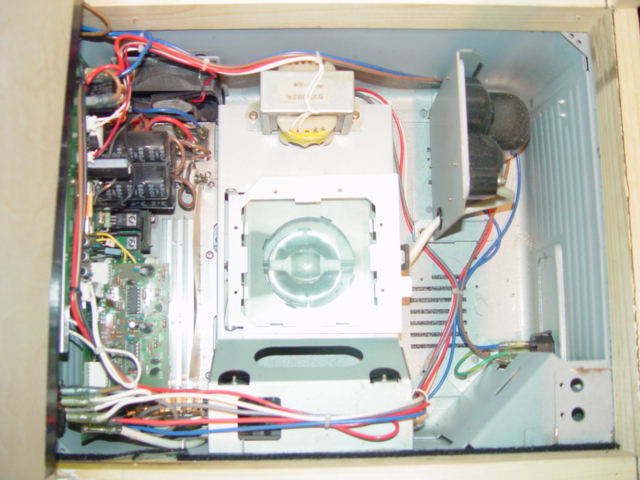

Modification Question
Is there any reason I can't take the 575W metal halide lamp, fixtures and ballast from inside an Elmo HP-305A Solar Deluxe and re-install it into my DYI enclosure?
Tom
Tom
tmitch007
nope but watch the heat and make sure u put the wires on the right way round, if your enclosure is made out of wood watch the heat as it will burn the wood, try to insulate the wood.
trev
trev
Thanks Ace... my plan is to use Cruser's light tube configuration... I've not seen the "guts" of the Elmo yet, so I don't really know if it will be adaptable to the light tube setup.
