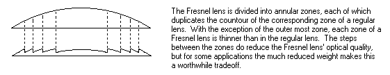

rules
Cruser, The 'rules' are everywhere...almost everything I've read about the fresnel states the limitations..
An example:
A partial solution to the dimness is to use a larger lens to focus more of the available light. But size comes with a price. The weight of a lens increases as the cube of its diameter. So, if you want to use a lens ten times bigger across, it will weigh a thousand times as much. Fortunately, this weight issue was solved by a guy named A. J. Fresnel with a special reduction program for overweight lenses. This program scrunches the lens down, almost flattening it out.... Unfortunately, the Fresnel reducing process also slightly reduces the lens' ability to present you with a perfect image...
Fresnel lenses show up all over the place where large, lightweight lenses are needed and optical perfection is not.
brainchild
ok but maybe as a projection lens not as a light spreader/enhancer, the imperfections is obviously the rings but we can get away with that in our systems.
