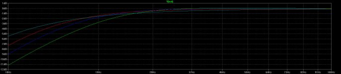

The OP asked to share the simulation file from #22 post.
This is "general" schematic, the interstage and the OPT is the "sample".
To use it must to download Stephie Bench dropdown tube menus:
Drop Down Menus for selecting your tube - Intact Audio

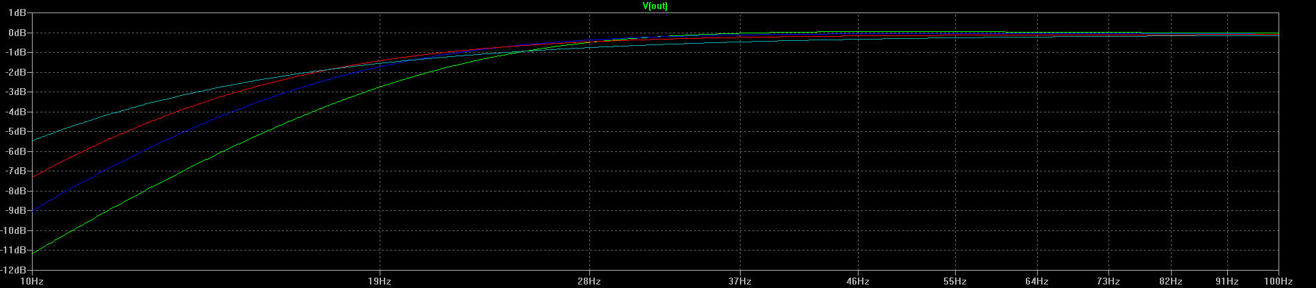

This sample use "real" (measured) transformers, 1:1 IT and 14k:8 OPT.
The 211 operating point is the same as OP's amplifier (sent me pics from inside of the amp).

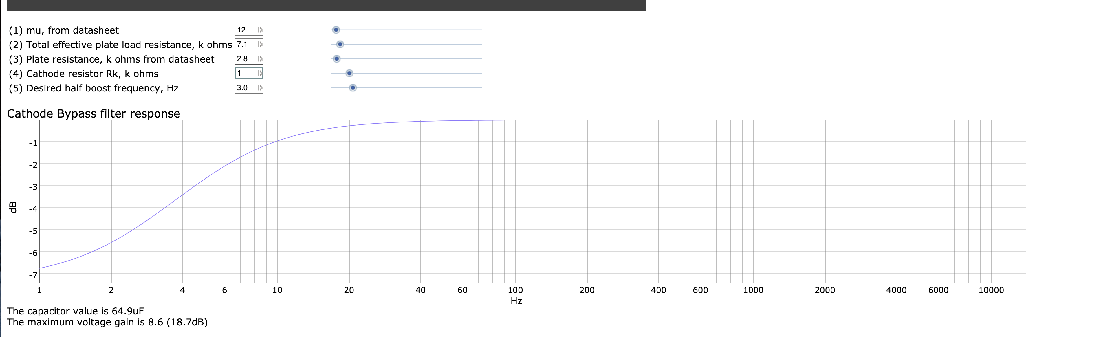

Are there any calculators suitable for the 211 valve to understand the capacitor value that is appropriate - I can find plenty of the more familiar valves?
I can assume I suppose that original designer got the 100 uF right, but it would be interesting to check
Thanks for all the help 🙂
That's really great thanks.
I found this too Cathode Bypass Capacitor Calulator
I measured my cathode resistor Rk and it is 1K

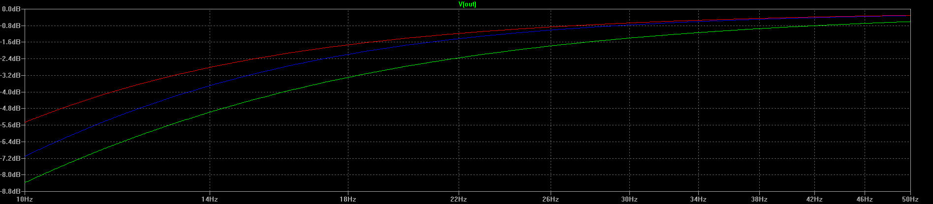

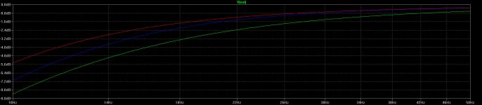

It shows that 100uF is enough.
Examine the unused snap in capacitor, if it's lower than 100uF (for example 47uF), try it.

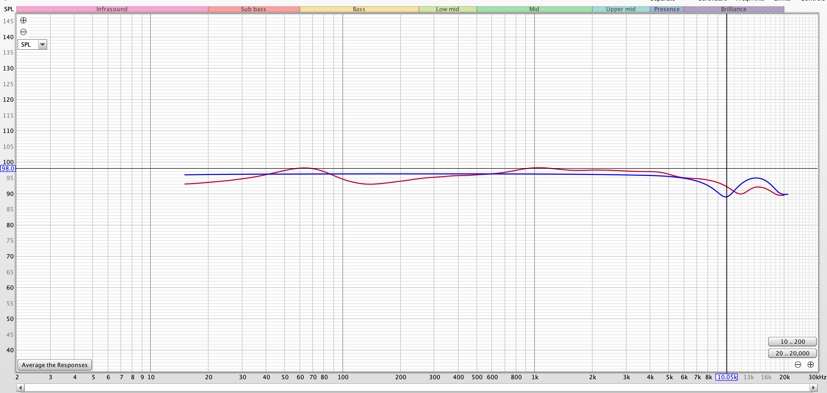

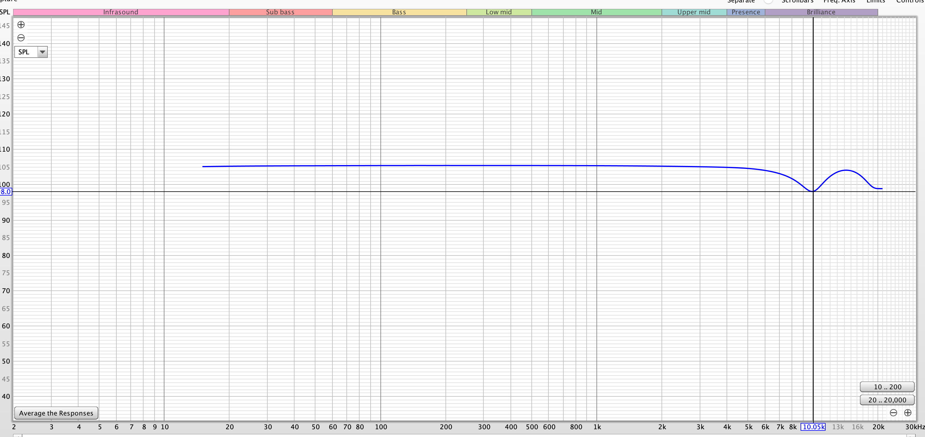

Use REW from 10Hz, not 15Hz for better visible separation.

As the loudspeaker (crossover) can altering 10kHz "valley" to 12kHz - IMHO with OPT "under fitting"- makes it probable, that OPT would be the problem cause.
By all means try another cathode decoupling capacitor (to rule out it's liability).
For the measuring the "quality" is unimportant, if it's good (low ESR) for few ten kHz.
