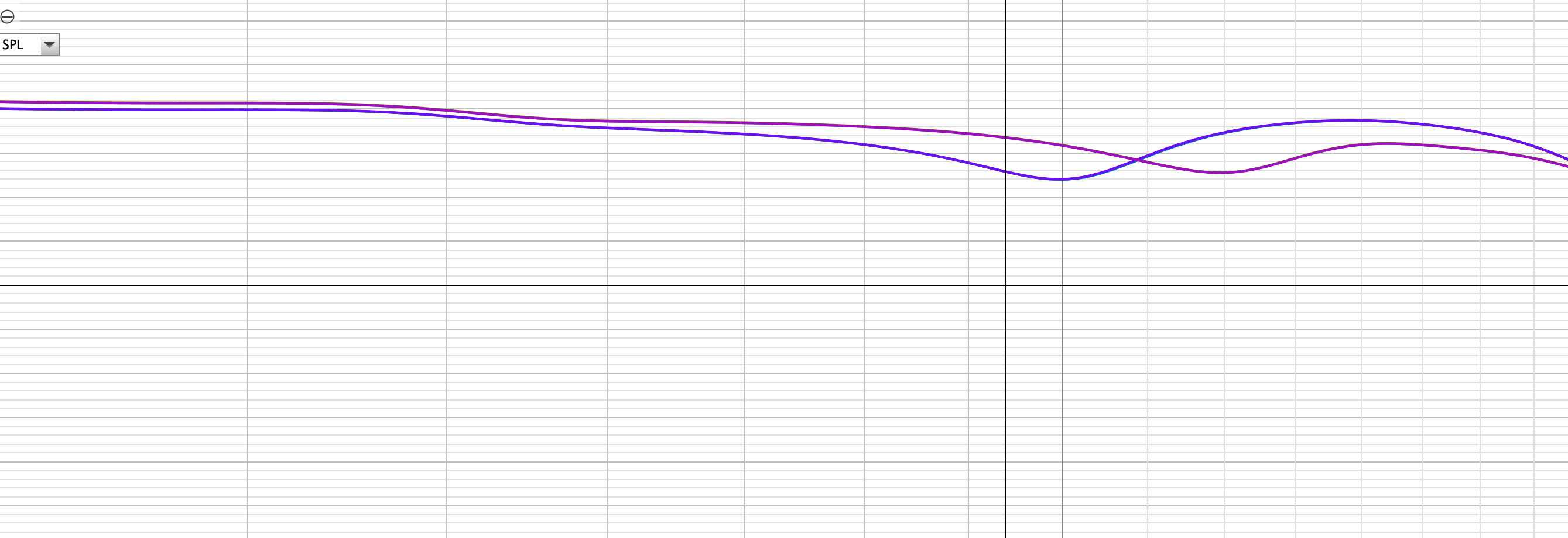

So I have now used REW to drive the input and measure the output on the 211 amp. First tests below, the difference is L and R channels.
I left the speaker in circuit playing while taking a tap off the terminals on the amp to drive the phono input on the audio interface.
Thoughts?

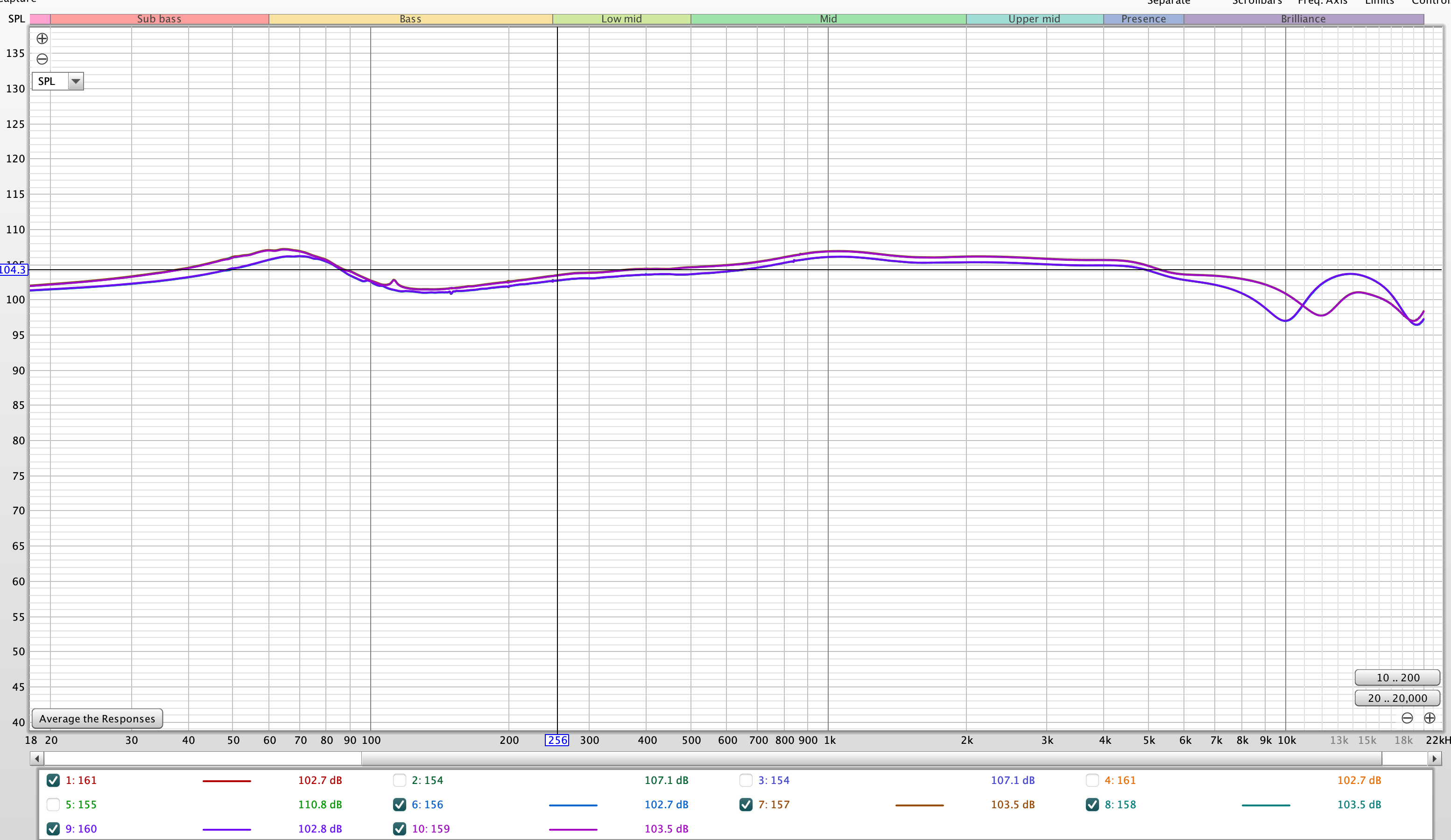

"I left the speaker in circuit"
The diagrams shows the speaker (and crossover, if it contains it) impedance fluctuations rather than amplifier behaviour.
If you want correct measuring, must to use real ohmic (8R or 4R 50..100W) load.

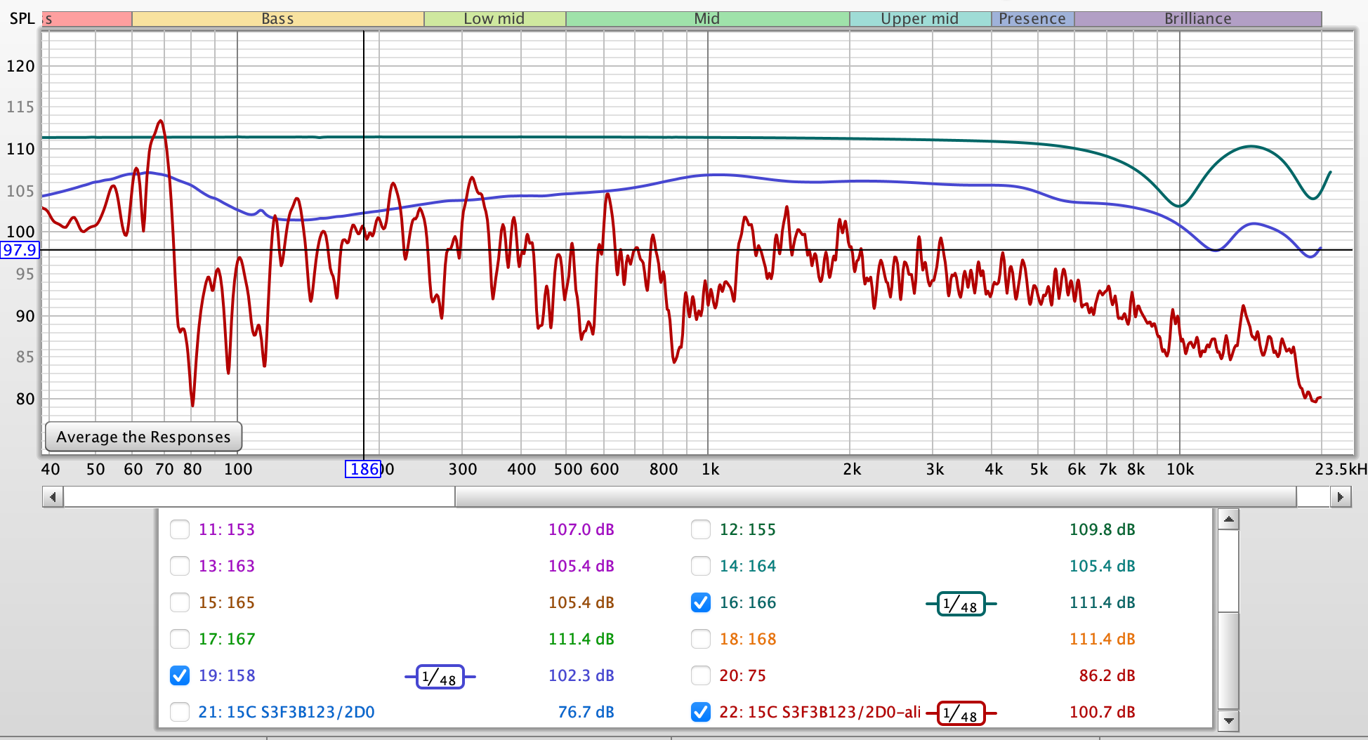

Well so here is an interesting combination which seems to show a consistent (in many ways) frequency characteristic in the amplifier.
Thoughts welcome
The traces are as follows:
Green test sweep into 211 amp driving 8 ohm resistor - measured output of amp
Blue test sweep into 211 amp driving Klipsch Heresy speaker - measured output of amp
Red test sweep into preamp, driving 211 amp, driving Klipsch speakers - measured output with microphone in room.

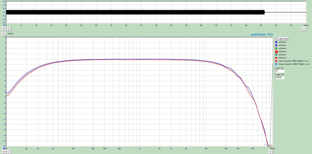

1.) Be sure that amplifier's input sweep is "horizontal" -at least- from 10Hz to 20kHz: measure it with the same method.
2.) If it's good, -as I wrote earlier- the interstage -and mostly- the OPT produces such anomalies.
I attach one of my friend's 211 amp frequency curve (I measured in last week) as "benchmark":
-3dB 19Hz..30kHz -at 1W- is acceptably good for 211 amps.

These are all very as much normally expected. The first high frequency resonance at 10KHz is disappointing, but it costs considerable money to get the next octave through a high impedance output transformer. There are very good reasons why type 211 valves aren't used everywhere, and you've just documented the biggest hurdle. Wonderful linearity, but expert-level everything else needed.
In-home microphone measurements are meaningless without detailed description of the mic distance, axis, yada yada, and are even then only vaguely translatable to other spaces. Doesn't matter.
Good news: nothing looks broken.

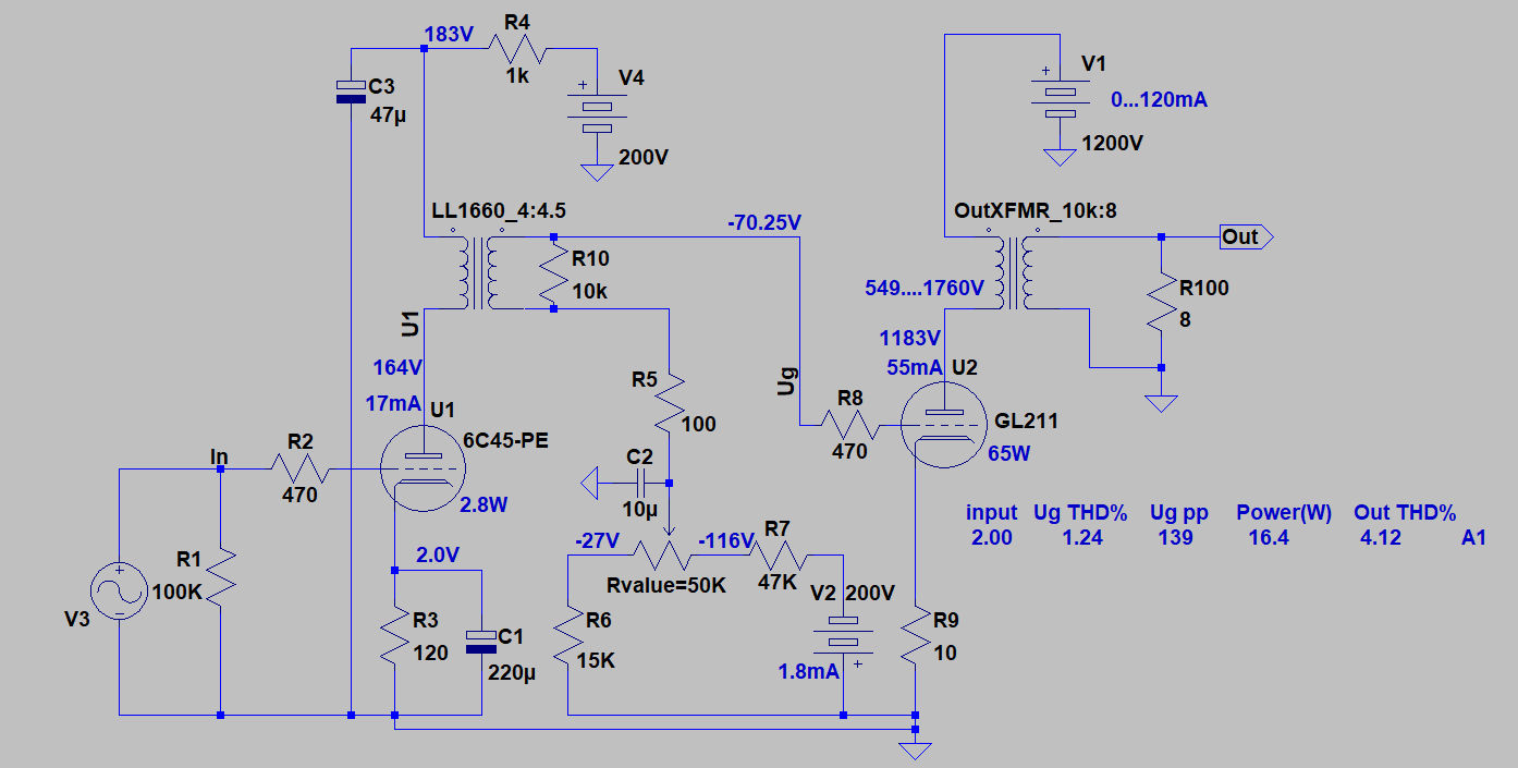

I know the circuit is in simple schematic terms
6c45Pi
Lundahl 1660 interstage
211
output transformer
Can I assume the 10 Khz resonance is the amplifier as it was built rather than a failed component. I will in due course also test the RH channel, and also calibrate the REW with the audio interface.
to be honest it sounds pretty good,
You have two pretty high impedance transformers, and really need to expect that a 1000:1 frequency range is pushing expectations. Not the end of the world, even really good speakers don't really do a whole lot better, or as well. But nothing is broken - high impedance wide-bandwidth transformers are difficult to impossible, depending on your interpretation.
