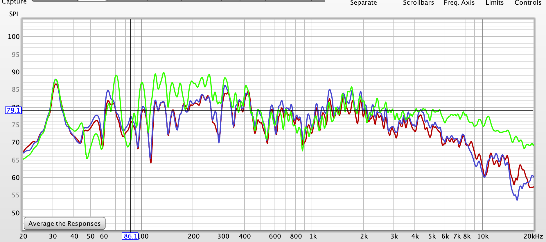

This is the measured frequency response with the 100 uF in place, so assuming that 100 or even less is enough?
(using REW to drive the 211 input, and taking an out put across and 8R on the speaker terminals)
It shows that 100uF is enough.
Examine the unused snap in capacitor, if it's lower than 100uF (for example 47uF), try it.
Use REW from 10Hz, not 15Hz for better visible separation.

The red trace is the 211 driving Klipsch Heresy speakers, the signal being taken from a parallel connection at the amplifier speaker terminals.
As the loudspeaker (crossover) can altering 10kHz "valley" to 12kHz - IMHO with OPT "under fitting"- makes it probable, that OPT would be the problem cause.
By all means try another cathode decoupling capacitor (to rule out it's liability).
For the measuring the "quality" is unimportant, if it's good (low ESR) for few ten kHz.
