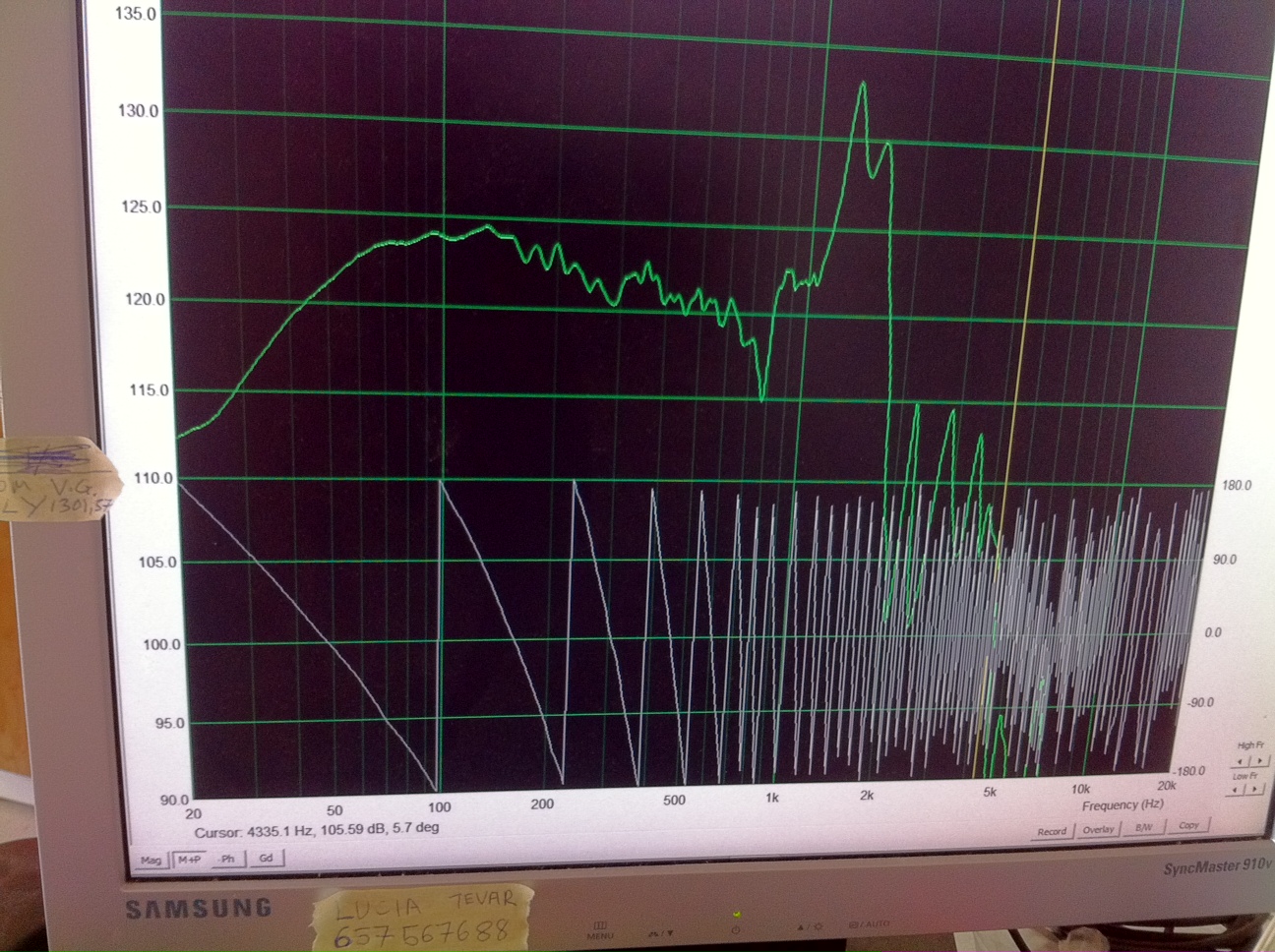

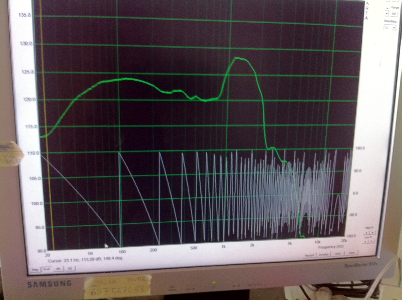

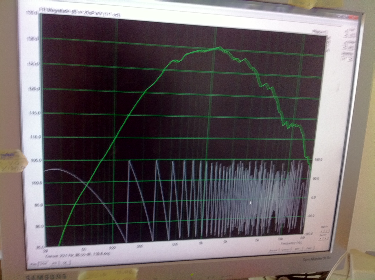

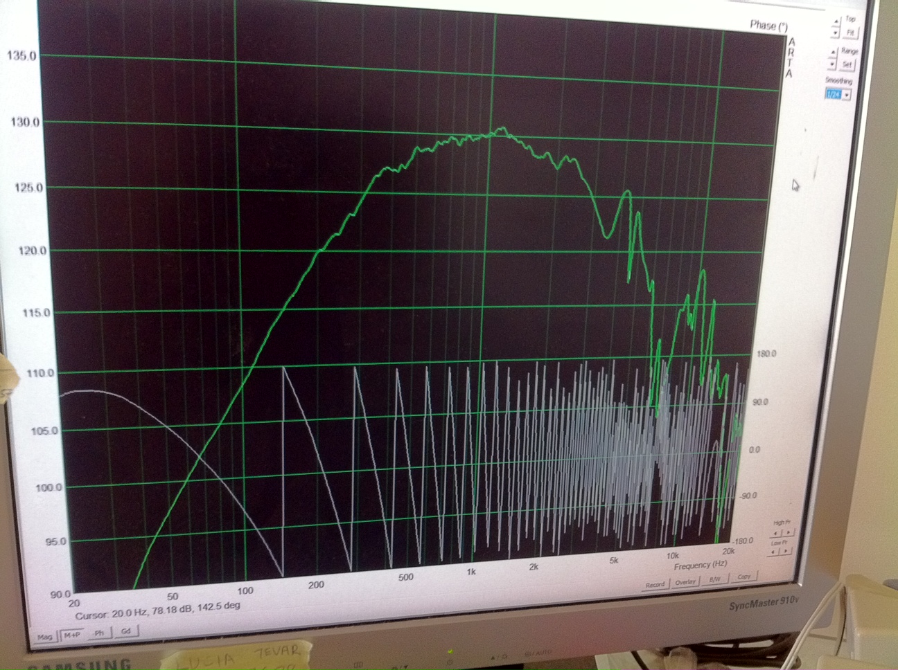

Well I've re done the nearfield for Woofer and Mid and got more logical results.
I was told how to mute the channels. As when I ticked the Mute box the channel did not stay muted, I disconnected the cables for Mid and tweeter channels. Perhaps the Hypex Dlcp or amps did not like that???
Anyway to mute a Channel you have to reduce its Gain to -96db. Not via Mute button! I don't know whether I have ever read that in the instructions and I cannot read minds!!
So I attach better looking freq responses for Woofer and Mid (not scaled because different volume settings) and no filters.

Good job! That looks much more realistic.
You did include the phase on the screen, but you are using absolute phase and this includes the phase lag from the propagation delay. This is fine, but the phase wraps many, many times, making it difficult to learn much by looking at it. If you select "Minimum Phase" from the View (I think that is the name) menu in that screen the wrapping will be removed.
The woofer response looks fine for a 15" in a closed box. The hump up near 1kHz is probably some cone breakup. You can flatten the lower part of the response using DSP EQ to adjust the tonal balance of the upper bass.
So, now the question is why, when you had the filters enabled, was something like a highpass filter being applied to the woofer? If I were you I would play around with the Hypex DSP settings while only measuring the woofer output until you get figure that out. Once you can get a lowpass filter implemented you can go back to working on the crossover.

I wasn't muting properly. I tried clicking on the mute buttons but the channels didn't stay muted. So I disconnected the mid and tweeter cables. I then got those measurements where the woofer looked like a mid. I can only presume that the Hypex DLCP or the amps didn't react well to that.
Emailed manufacturer who explained that to mute a channel, set its gain to -96db. That gave me the last measurements
Assuming that I have now measured Woofer and Mid correctly? I have heard some say that I now flatten the responses of each driver and then apply the crossover filters. Before hearing this, I presumed that you look at the individual responses, judge where the crossover freqs should be, apply the crossovers, then flatten the total from 20-20KHz? My thinking behind this, is that I wouldn't be flattening the parts of the responses that were going to be "Cut off" by the crossovers anyway?????
