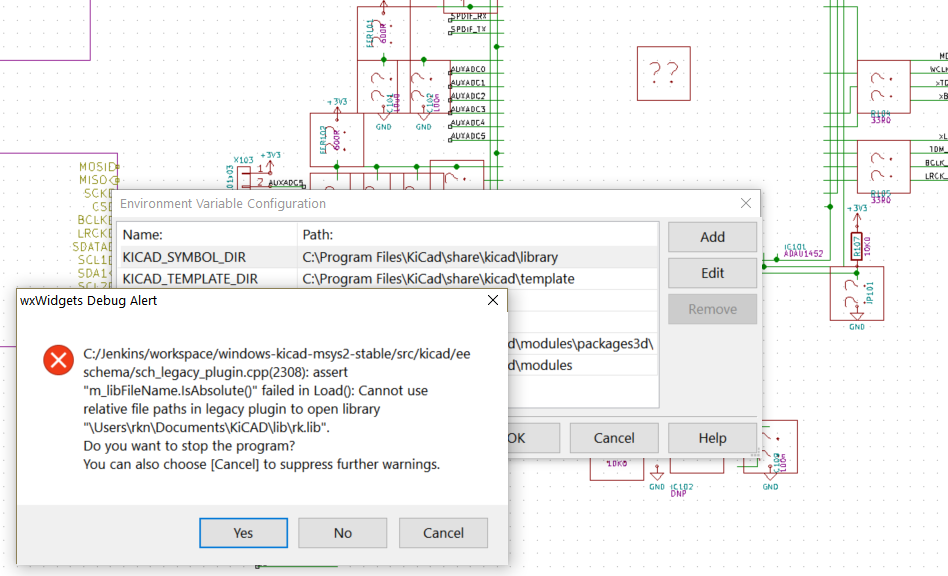

@dimitri: Hm, you should be able to load the schematics with the given libs in the repository. Anyway, I'll double check it tomorrow!
Thank you, I used *.lib from the repositoryHm, you should be able to load the schematics with the given libs in the repository.
