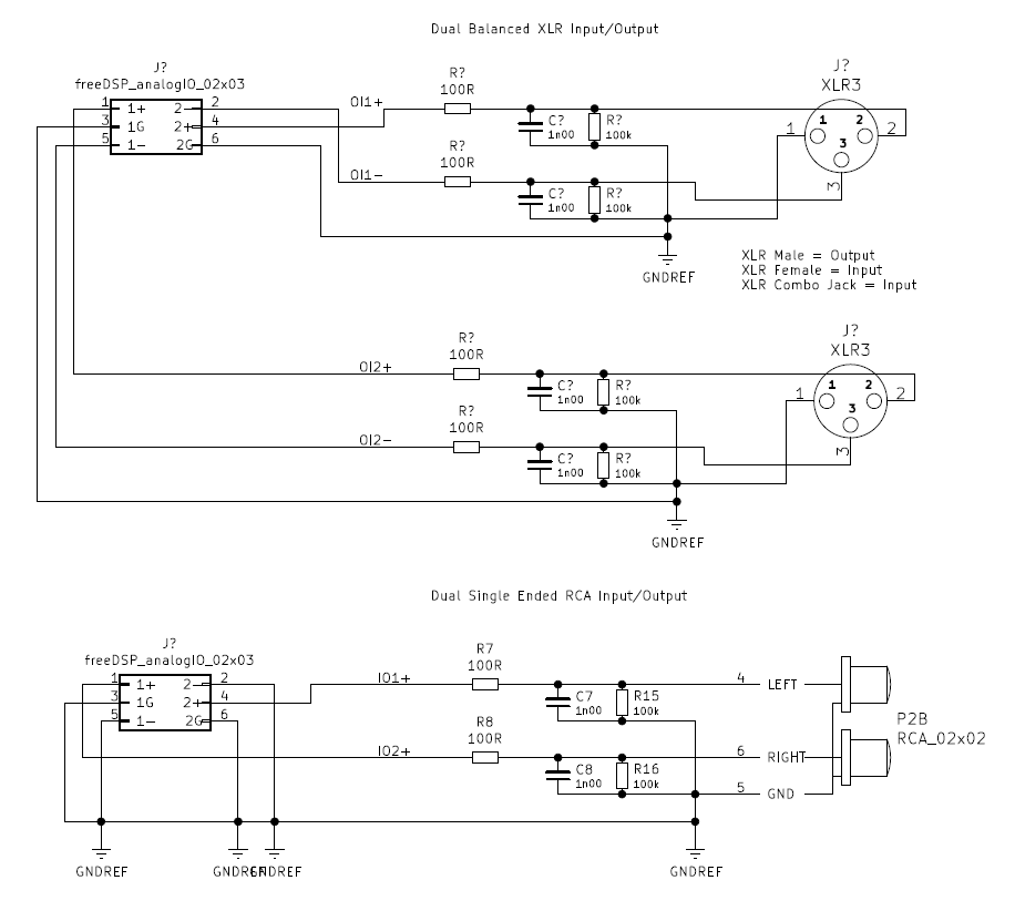

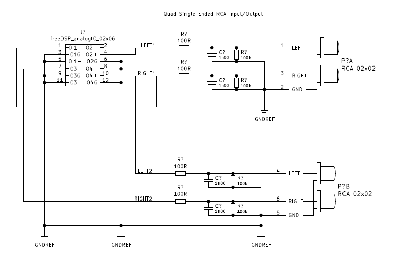

Here is a first take on a schematic for single ended RCA inputs. One board will work for both inputs and outputs, I believe. Please critique. Thank you.
attachment.php

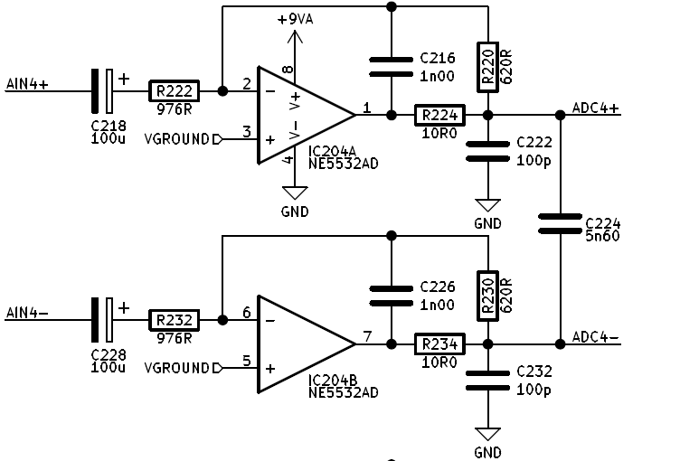

I went into the freeDSPx AnalogIO x8 board and found the "ESD Protection" circuit.
Here is the Aurora:
attachment.php
Here is the AnalogIOx8 (with the extra parts):
attachment.php

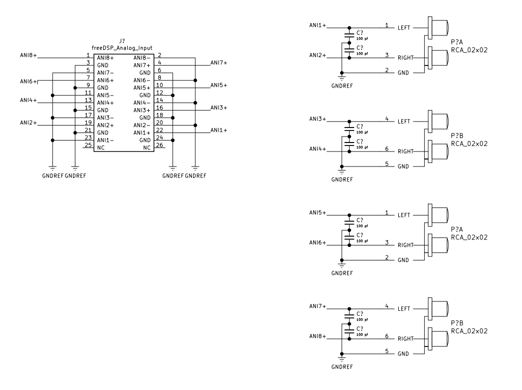

Here is my second take on a schematic for single ended RCA inputs.
attachment.php

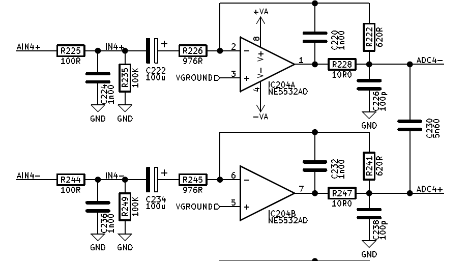

dspverden said:
This is not an ESD protection, it is the RFI filter you have added.
Yeah that makes more sense. RFI filter at the inputs, in a metal grounded case would keep the interference to a minimum inside the case. Right!? So putting it close to the inputs will keep the interference out... In theory.
So I have a question... Can that same RFI filter work on the outputs? Also, can the negative pin of the output be grounded? Should it be? I'm trying to determine if we can use the same part for both inputs and outputs (with the RFI and with or without the grounded negative pin).
I'm working on some other schematics to show XLR inputs/outputs, 1/8 inch (3.5mm), and 1/4 inch. I'm also considering drawling up the schematics for an active input/output setup as well. I figured documenting the recommended configuration is the first step.

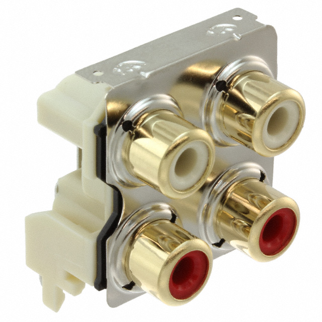

This quad RCA connector would look like this.
attachment.php

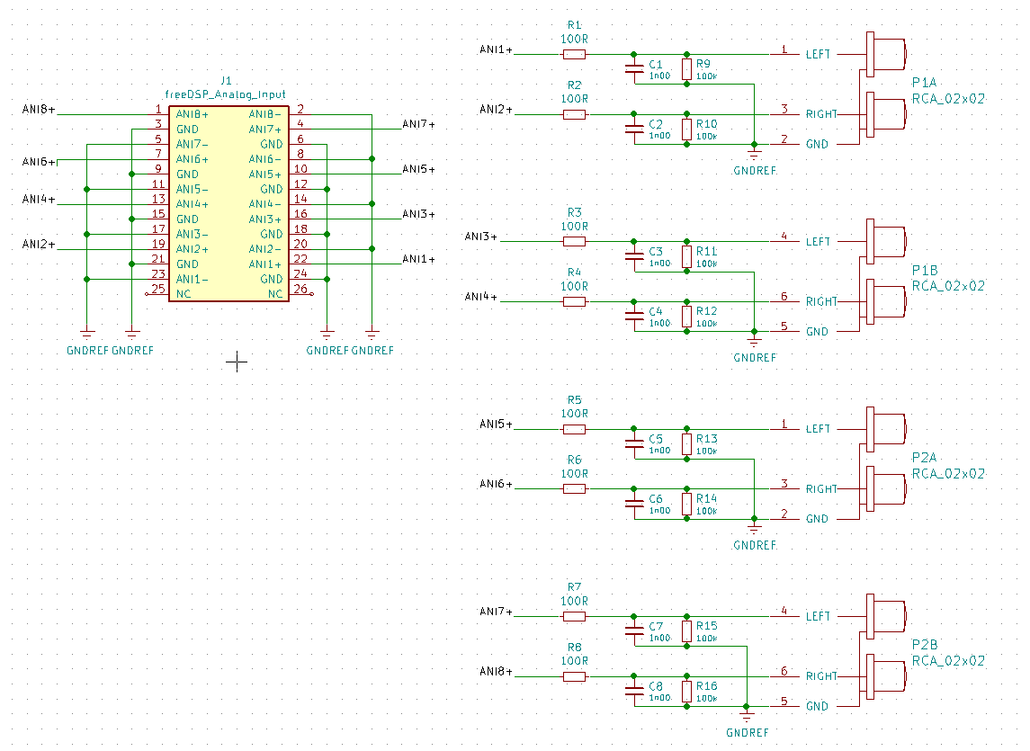

And here is the schematic (unverified).
attachment.php
**** I'm trying to figure out if my quad connector is backwards (Left/Right).
