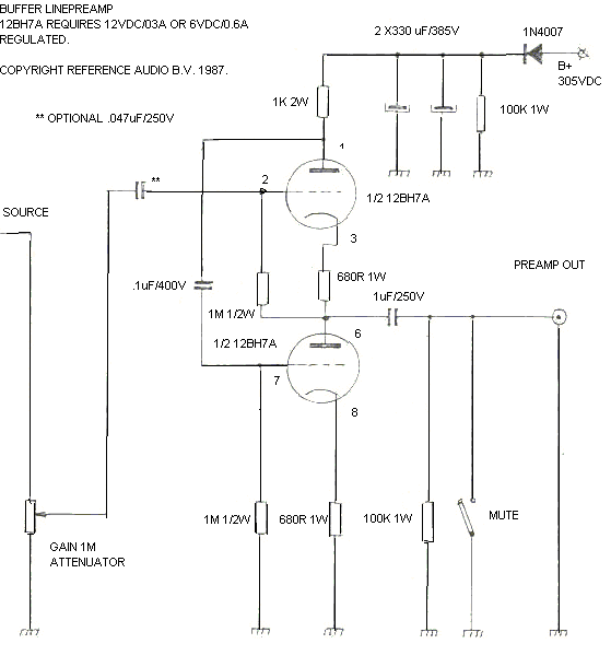

On the attenuator switch, it should be a shorting type or can I get away with a non shorting? two waffers for stereo? Any suggestion?
I better start working on those 6 power transformers, It will take some time, but in the meanwhile I will import those nonmagnetic MF Rs and some tubes I missing such as EL86 and OG3.
Preamp.
That would be shorting, AKA "make before break"...if not you'll get unpleasant noises when the grid is disconnected.
I use a Elma switch, two of them in a dual mono setup.If I get the series attenuator to work ( I expect it to) you'll only need one deck, to be on the safe side you can order to switches with two decks.
They're easily dismantled and you won't need shaft extenders nor couplers if you do the layout right.

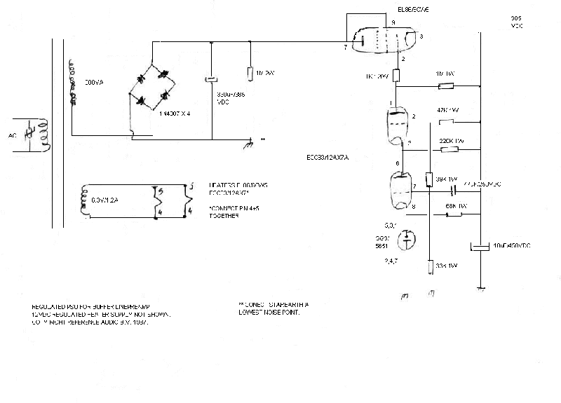

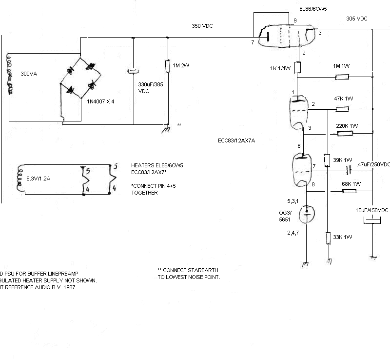

The preamp part is ready to be scanned, the PSU will require a redraw before scanning.
Please be patient....worst of all I will need to redo the 1Meg attenuator since I seem to have lost my papers on that.

PREAMP.
An interesting thread for those wondering why Mr.Tube😉 is using silicon in his preamp.
DIODES.
The need for speed...
So, my theory is that thanks to the series reg. we have a good isolation between the power provider (PSU) and the actual circuit...the only concern remaining being: how much crud are these diodes throwing back into the mains?
Well, although I did not specify them as such, the xformers in the preamp I use do have an electrostatic shield, they are exceptional at keeping voltage and current constant and nothing on the mains seems to upset them.
They are not exorbitant in price, considering this isn't a cheap linestage in the first place,but...they were made to order.
As far as I can tell the diodes don't really matter, in fact you're not likely to hear the difference between a tube rectifier, an ordinary diode or a fast recovery one in that particular position.
I think you're starting to see the benefits of regulation?
The only place global feedback is O.K. IMO.
Not that I want to generalise this, I just want you to give it a go.
