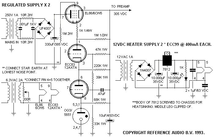

Your design seems ideally suited to use an isolation transformer as the powertx. I'm thinking of certain EI designs by Elgar and MGE (Topaz) offering 0.0005pF capacitance between the windings, and claiming noise reduction of the order of 146dB common-mode, 60dB transverse. One would of course have to add a second transformer for the heater supplies, but that's preferred from a sonic vantage point in any event.
You could if you live in a country where you have a 240V mains.
I try to not use off the shelf xformers as most are below standard (mine anyway) so I have them custom made by a winder I trust.
The little extra you pay gives you a xformer with all the goodies you want: good line regulation, no noise, no heat, a static shield between primary and secondary and in case you have several secondaries wound on the same iron you can tell him to minimise interwinding influences where it matters most.
IMHO a good powerxformer is the heart of a timeless concept and is never money down the drain.
Other than that I try to pay attention to good isolation from the mains so the music just gets amplified without (I'd hope) external influences.
Series regulators are only one way to go about that, chokes are fine too but are bulkier and probably more expensive to get right.
All in al, to me at least, it's easier to design a good regulator than to find an excellent choke and once you've designed some regs for several current ranges and voltages you can reuse them in other designs very easily.
Cheers,😉

Frank
Can I also use the 12FQ7 tube on this preamp design?
if not do you have a design for these tubes.
You could but keep in mind that the values were optimized for the 12BH7A whereas the 6CG7/6FQ7 is a noval version of the 6SN7 and heater variants.
No, other than the occasional Luxman design using it I don't see it used very often.
Last production runs I know of were done by Ei but I haven't seen much of those lately.
Cheers,😉
P.S. Keep in mind that the pinout isn't the same either.

Thanks for the info.
Just this morning I broke one of my 12BH7A tube when I accidentally drop my portable grinder. I managed to find 4pcs. of 12FQ7 from my dads pile of stuff and wonder if I could use it.
I'm on the process of building the preamp I still have 3pcs will keep the third one for replacement if ever one got busted, "I hope not cross my fingers". I'll keep you posted regarding the status of the project.
Again thanks.
If it were me breaking a tube_something that actually seldom happens_ I get in this funny funeral mood....
Under the conditions they operate and provided you run the heater at 12VDC, they should last you a lifetime....
Which is probably much longer than you'll keep the preamp anyway...🙂
Cheers,😉
