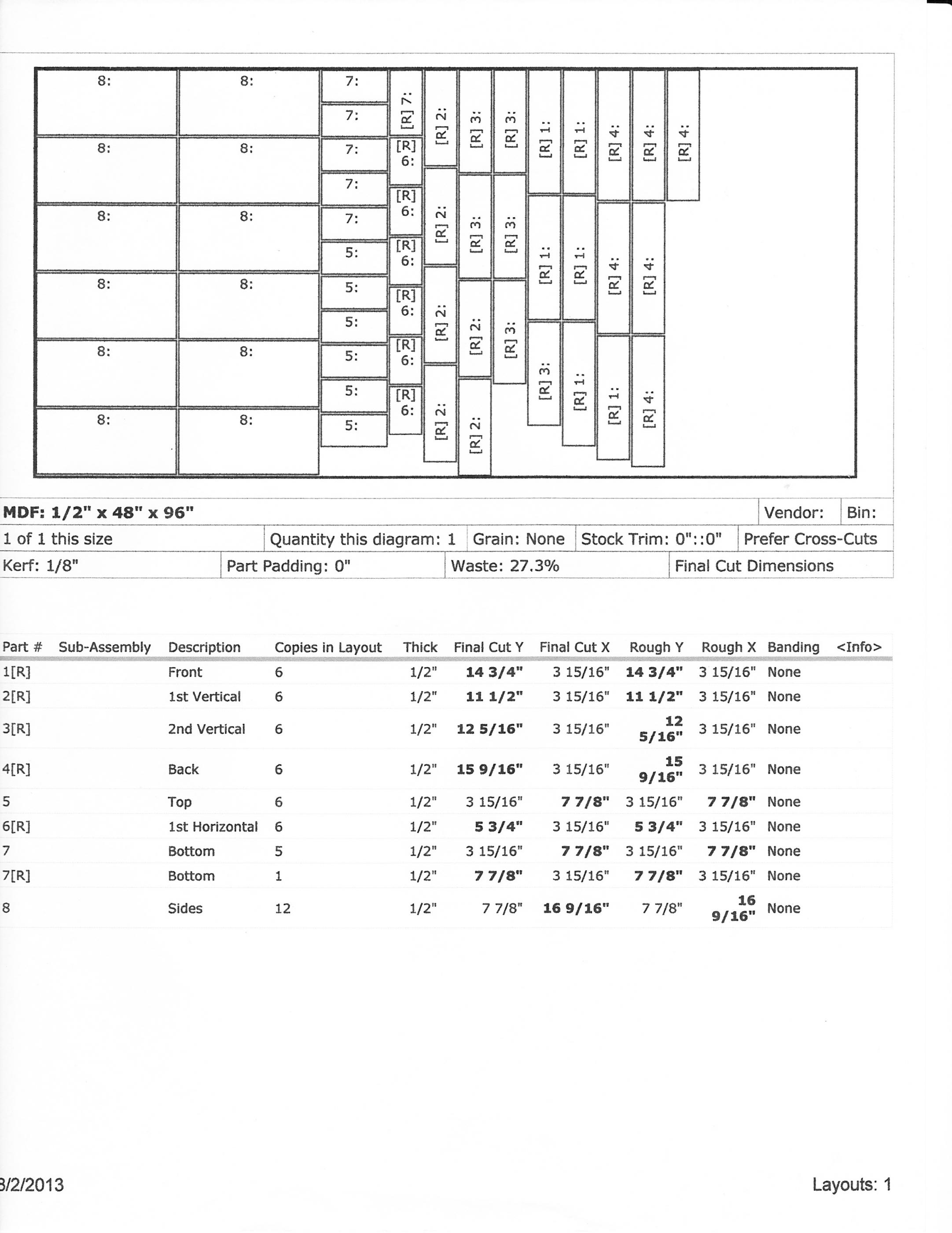

I know this thread is nearing a year old, but would it be possible to include the cut sheet dimensions within the body of your reply? For some reason, I cannot read the zipped file.
