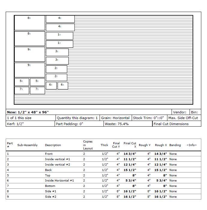

The first image should be a layout for ONE PAIR from a single sheet of Ply/MDF.
The second should be THREE(3) PAIR from a single sheet.
HAPPY CUTTING! Keep safe....![]()

Optimized Plan

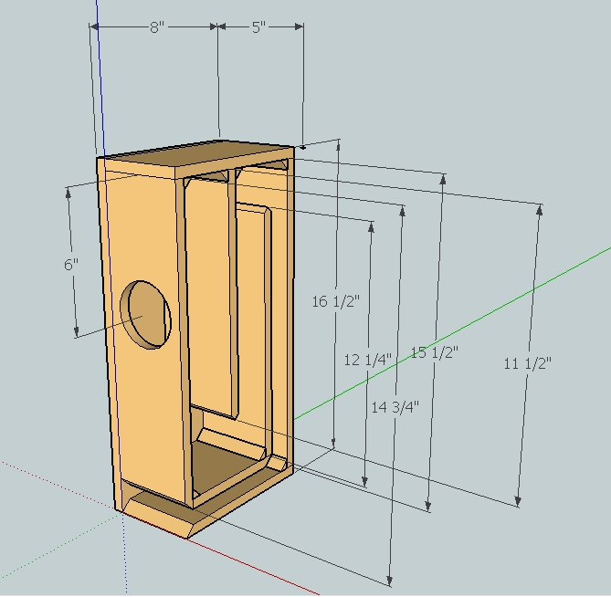

After tinkering with the design for a few, (and finding out that the Aura drivers are no longer available from Madisound)...I have Made a plan for the Dayton Dayton Audio ND91-4 drivers which are availible from Parts-Express for $28.65 (as of the time of this post). Quite a bit more expensive but worth the extra change. The new design followed a criteria which is optimized for build time, reduced complexity and budget. Just my take on a small DIY build anyway. Enjoy! Below is the link to download the Sketchup file.

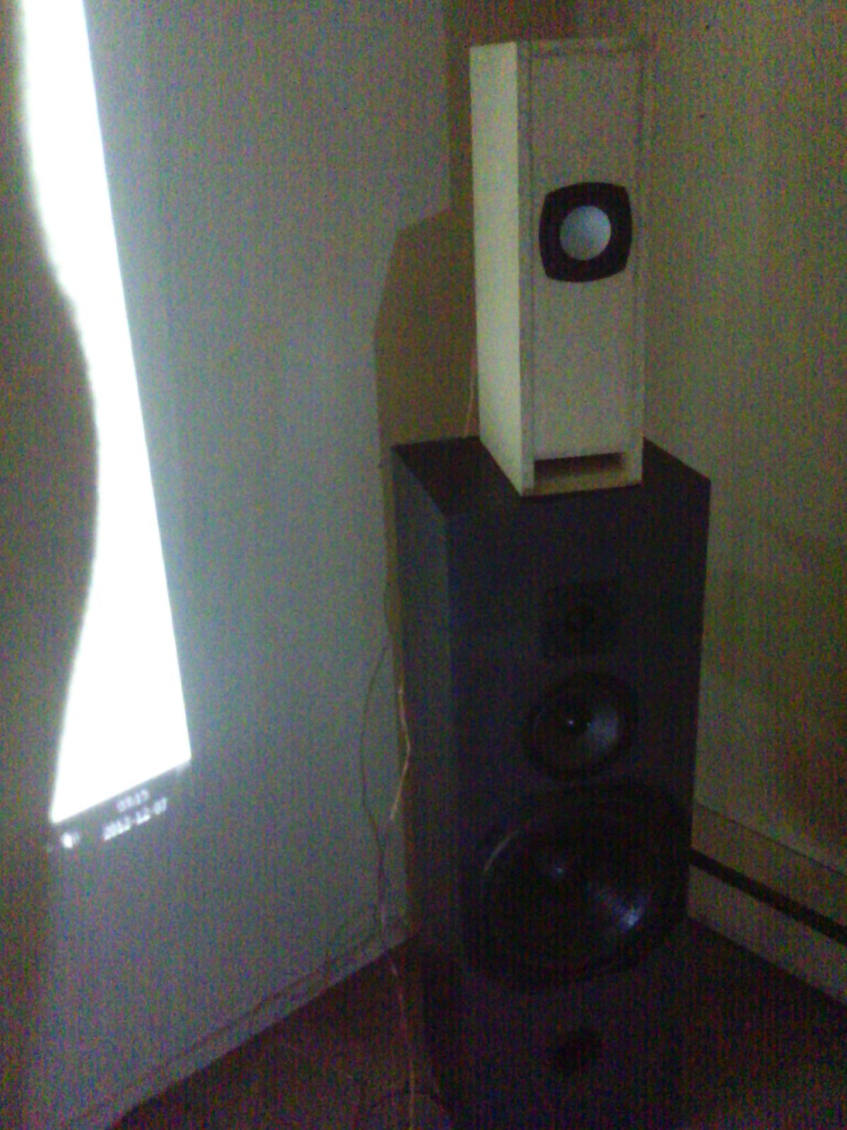

This was a quick and dirty build for a set of garage speakers. Wood, is from an old cabinet; I raided my wife's sewing closet for the stuffing; drivers were purchased when they were $12.50 (I'm kicking myself for not buying more at this price); including incidentals (speaker wire, nails, glue, sandpaper and Danish Oil) I'm in these for around $35 and a few hours of labor. I love em. I certainly don't have an ear, but I'm impressed these. At this point they need a little more love to minimize air leaks along the line. A gasket for the driver is definitely needed (mounting flange is slightly bowed) and a proper terminal (speaker wire is ran through a hole in the back and sealed with caulking which isn't holding up to my abuse).
Also my boxes ended up about 1/8" taller because of the thickness of wood used. I didn't compensate for this on the depth so the cross section of the line is slightly less.

I cut and installed a gasket for the driver and I applied more caulk around the speaker wire. This cleaned up the sound and really brought out the highs. I hooked up Paul's filter (.90 mH inductor in parallel with a 20 ohm resistor) and it brought down the highs more to my liking. Since the Sprite has a larger baffle I assume the F3 of the BSC is lower than it should be in this configuration, so I want to tweak it. Although, after plugging Paul's values into MJK's BSC equation the circuit is doing something else because I ended up with an f3 of 3.5.

I for the life of me cannot determine the mounting depth of the backwall for the speaker chamber...
The t-line is dictated by the butt joints. What is the depth, from the front wall, of the speaker chamber?
Download the Sketchup file
Check post #42, download the sketchup file. That should help you more than any description I can give you.
