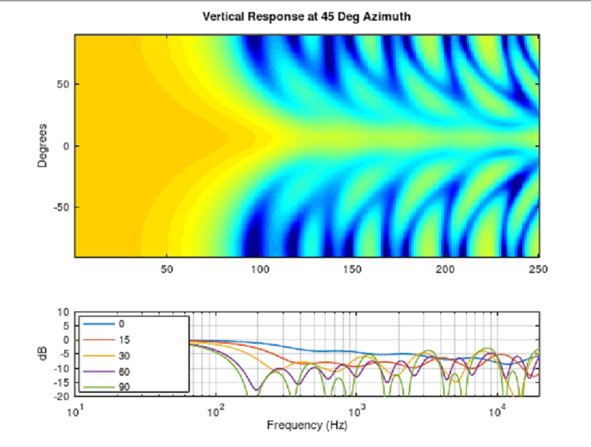

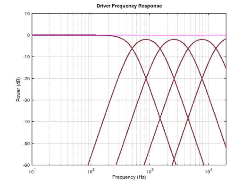

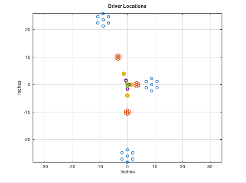

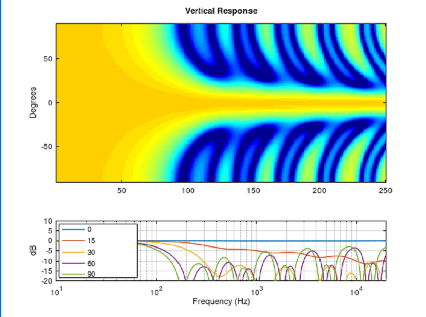

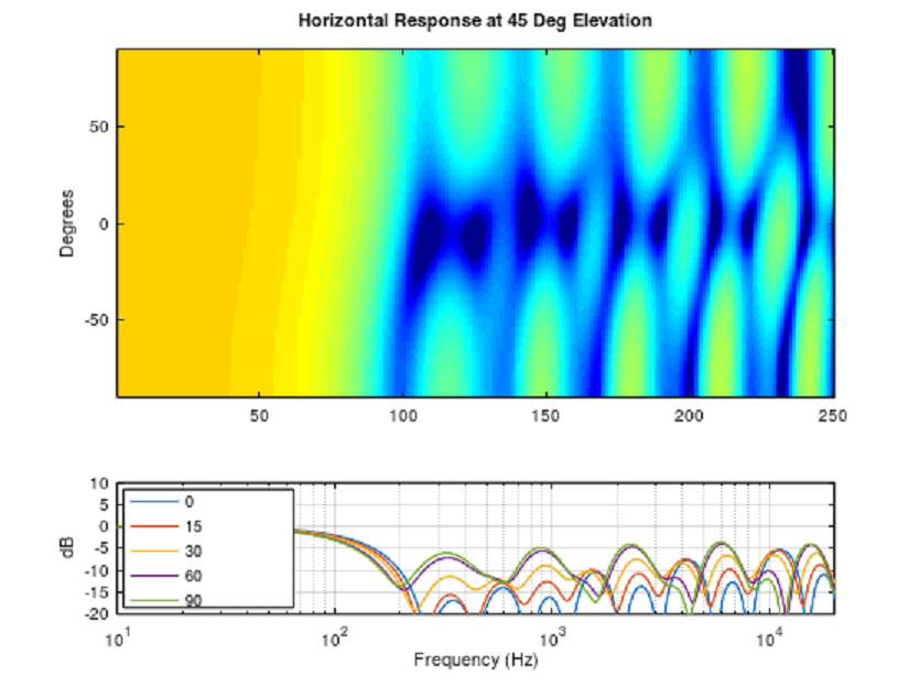

I took a shot at replicating your simplified design. I allowed another nest rather than generating a planar tweeter, to save myself some trouble. That shouldn't make much difference, particularly not below 8 or 9 kHz. The vertical and horizontal polars look OK, but the diagonals are pretty bad, IMO. They don't match the ones you posted, which I don't trust. Let me know if you see an important aspect that was missed or simulated erroneously.
They can't match because rotation center in your simulation is not at the center point of speaker. Only thing that we can really trust is that these simulations are always inaccurate.
My simulated measurement positions are all equidistant from the point 0,0 depicted on my driver location plot, which is the center of the speaker. I don't know why you would be convinced otherwise. I have built and measured a speaker based on this approach, and found my simulation to be highly accurate at predicting polar response.

If you compare the response in my "Horizontal Response" plot (which uses an elevation angle of 0) at 45 degrees azimuth to the response in my "Vertical Response at 45 Deg Azimuth" at 0 degrees elevation, you will see that both plots show a similar response. In contrast, a cut across your diagonal plot at 0 doesn't match an off-axis response from your other plots. Instead, the cut at 0 across your diagonal plot is flat. That's inaccurate.

That is as accurate as can be because 0 deg response in any diagonal rotation is axial response. I suppose we need some graph to get agreement what is diagonal rotation.
I thought it was pretty clear how I interpreted it (at least for anyone familiar with azimuth and elevation angles). I understand now that you didn't try to replicate what I did. You created a different plot along a different axis. I think your interpretation may be more in line with what TBTL expected. However, it looks like my interpretation was better at showing warts in polar response (which I think was the point of the question).

I suspect the reason I was able to highlight issues with the polar response of your proposed simplification is because I showed more of the response away from the reference axis.
Quite many simulations done in the morning. I would say that "my" diagonal rotation method reveals directivity issues much easier and clearer because difficult diagonal planes are visible much longer in directivity charts such as polarmap.
One thing which probably caused misleading differences is diffraction simulation. I had diffraction simulation in response data but you did not. Result is worse without diffraction. But I can confirm that three drivers per way does not give very good result. Four drivers per way is better to diagonals because risk to form just M-MM pair is reduced. Not so economical anymore but gives more freedom to select and locate drivers than six.
