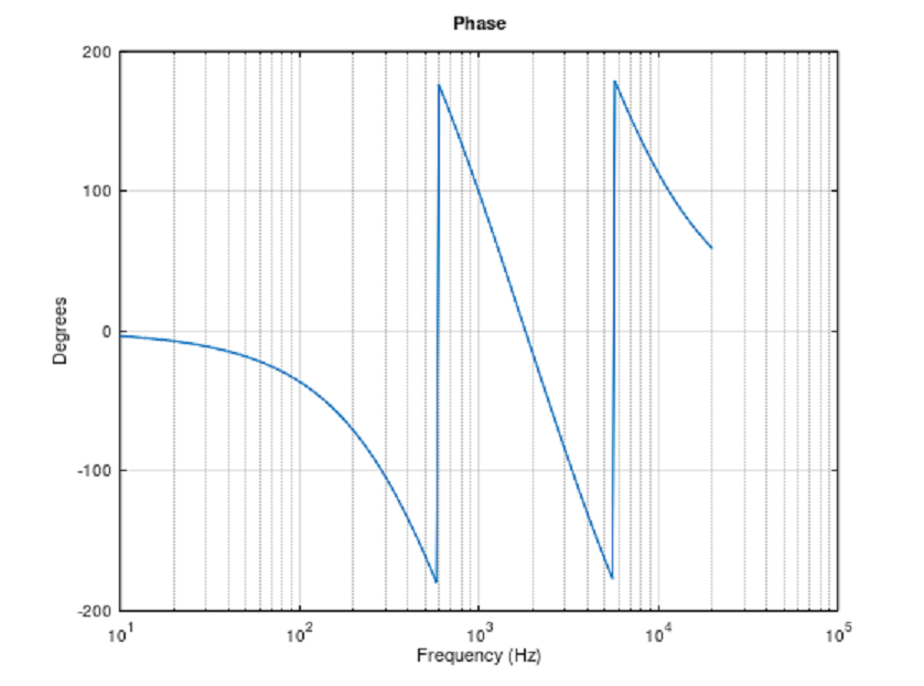

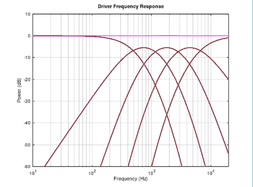

I'll see if I can come up with an easy way of explaining the filter Qs.
Here's an equation that was derived empirically:
Q = 0.5 + 0.1/power(frequency_ratio_up, 1.5) + 0.1/power(frequency_ratio_down, 1.5);
Where frequency_ratio_up is the ratio of each crossover frequency to the next higher crossover frequency. Similarly, frequency_ratio_down is the ratio of each crossover frequency to the next lower crossover frequency. When there is no higher or lower crossover frequency, remove that term. (For this reason, lowest and highest crossover frequencies have slightly lower Qs than the ones in the middle.
In the example I gave in the OP, there are 4 crossovers. The ratio of crossover frequencies is fixed at 2.36. Thus the Qs are:
0.52758
0.55516
0.55516
0.52758

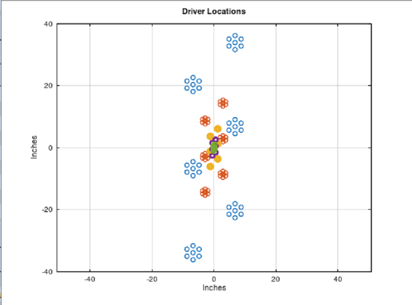

Here is more economical version. 4-way with 10 drivers and LR24 linear-phase crossover.
Mechanical possibilities are closing to reality, though not yet entirely reached with those driver locations.

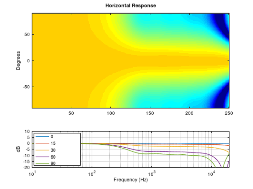

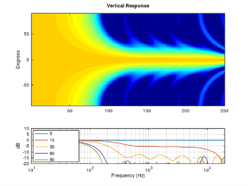

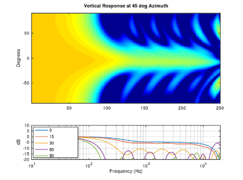

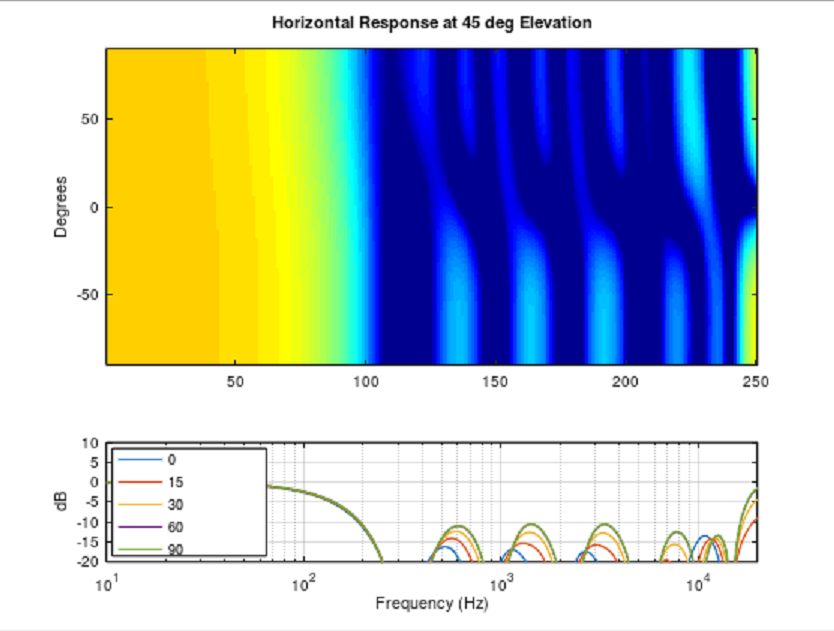

I took a shot at replicating your simplified design. I allowed another nest rather than generating a planar tweeter, to save myself some trouble. That shouldn't make much difference, particularly not below 8 or 9 kHz. The vertical and horizontal polars look OK, but the diagonals are pretty bad, IMO. They don't match the ones you posted, which I don't trust. Let me know if you see an important aspect that was missed or simulated erroneously.
They can't match because rotation center in your simulation is not at the center point of speaker. Only thing that we can really trust is that these simulations are always inaccurate.
My simulated measurement positions are all equidistant from the point 0,0 depicted on my driver location plot, which is the center of the speaker. I don't know why you would be convinced otherwise. I have built and measured a speaker based on this approach, and found my simulation to be highly accurate at predicting polar response.
Edit:
If you compare the response in my "Horizontal Response" plot (which uses an elevation angle of 0) at 45 degrees azimuth to the response in my "Vertical Response at 45 Deg Azimuth" at 0 degrees elevation, you will see that both plots show a similar response. In contrast, a cut across your diagonal plot at 0 doesn't match an off-axis response from your other plots. Instead, the cut at 0 across your diagonal plot is flat. That's inaccurate.
That is as accurate as can be because 0 deg response in any diagonal rotation is axial response. I suppose we need some graph to get agreement what is diagonal rotation.
I thought it was pretty clear how I interpreted it (at least for anyone familiar with azimuth and elevation angles). I understand now that you didn't try to replicate what I did. You created a different plot along a different axis. I think your interpretation may be more in line with what TBTL expected. However, it looks like my interpretation was better at showing warts in polar response (which I think was the point of the question).

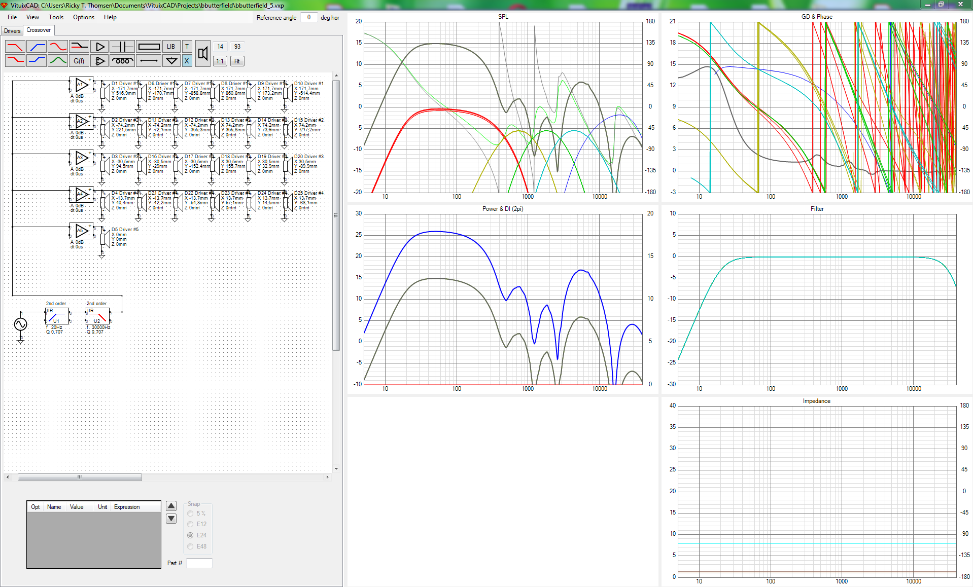

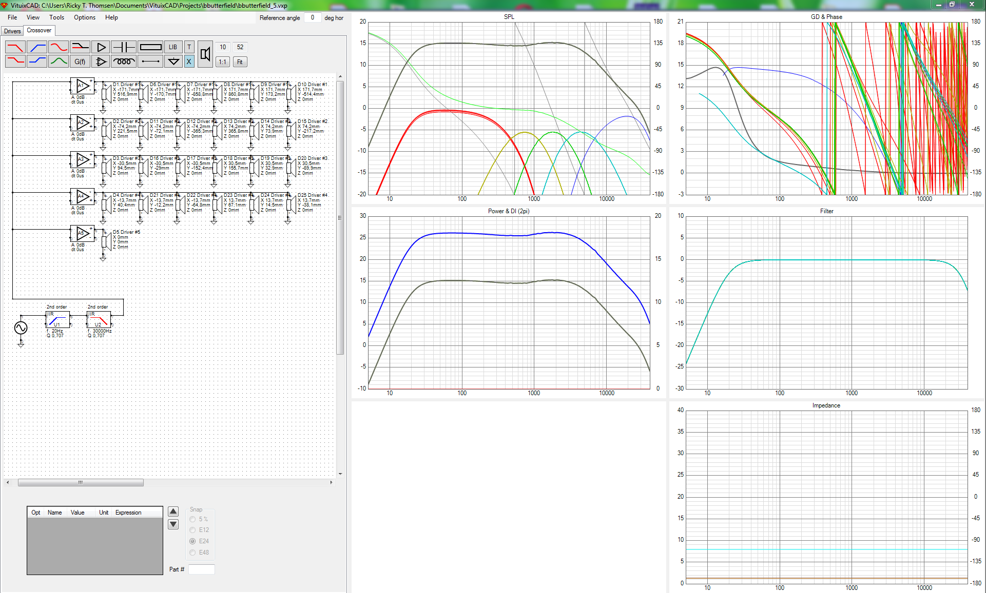

That's true, but we should remember also here that VituixCAD main program is crossover simulator which relies on measurement data. That is usually easiest to capture by rotating speaker around it's own origin, or by rotating mic around speaker's origin. That leads to previous rotating system at least in simple home labs with limited space.
VituixCAD has also free adjustment for origin (X,Y mm) and plane azimuth (Phi in previous image) but that feature is not public. That enables simulation to half or full circumference below, above, left or right side of the speaker. That works with simulated circular drivers to half space only because loaded measurement data can have two planes.

I suspect the reason I was able to highlight issues with the polar response of your proposed simplification is because I showed more of the response away from the reference axis.
Quite many simulations done in the morning. I would say that "my" diagonal rotation method reveals directivity issues much easier and clearer because difficult diagonal planes are visible much longer in directivity charts such as polarmap.
One thing which probably caused misleading differences is diffraction simulation. I had diffraction simulation in response data but you did not. Result is worse without diffraction. But I can confirm that three drivers per way does not give very good result. Four drivers per way is better to diagonals because risk to form just M-MM pair is reduced. Not so economical anymore but gives more freedom to select and locate drivers than six.
