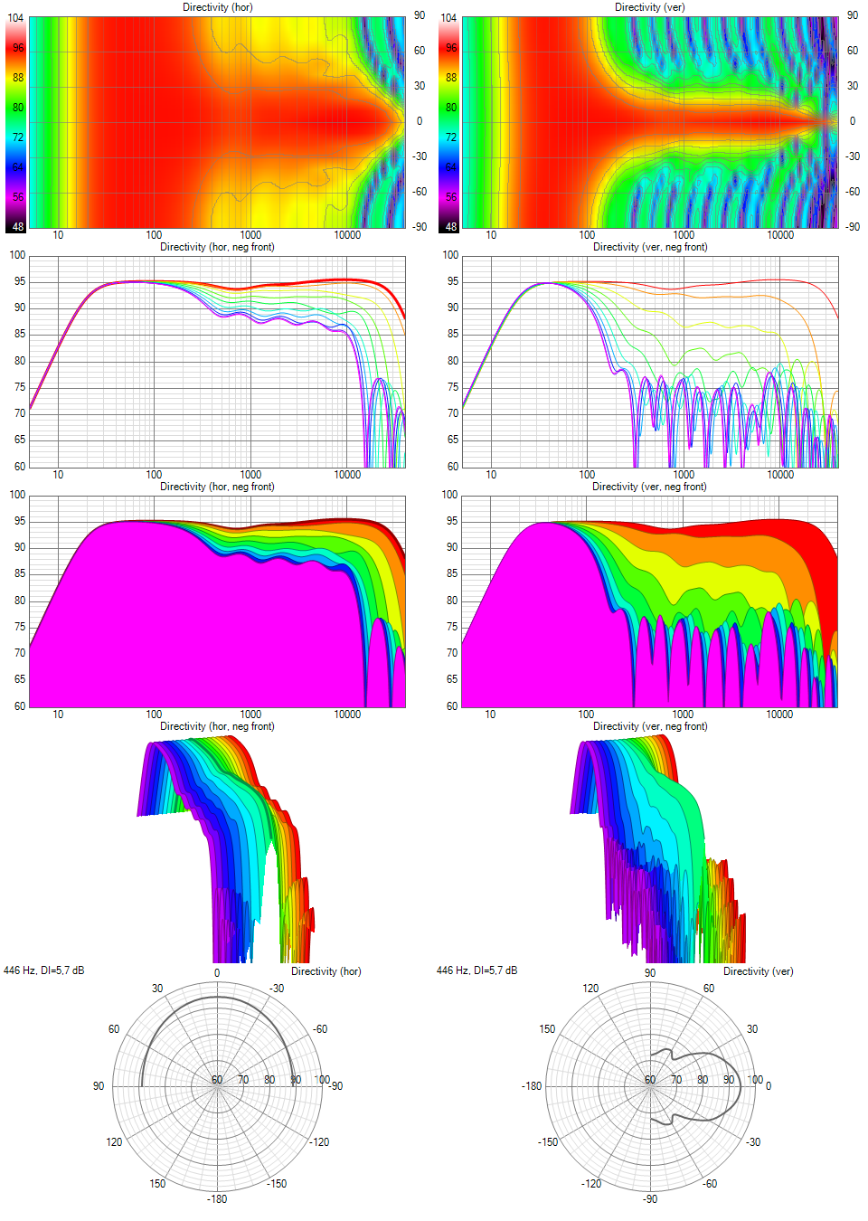

Model looks work close enough now thanks bbutterfield support me models precise numbers for position pattern of drivers and XO frq points, Q of slopes is not the 100% precise number but a avarage and probably the reason midrange area show a small ripple.

BYRTT, I feel like I should be thanking you more than you thanking me... it's nice to have independent verification in this thread for all to see. Particularly since I'm not sharing my speaker design at this time. Did you calculate the polars? It would be nice to see those as well.
I'll see if I can come up with an easy way of explaining the filter Qs.
I'm glad to see the off-axis consistency. We can probably get that even better with the exact Qs.
It looks like the axis labels for the angles are off. Should those be +/- 90 rather than +/- 180?
Edit: I don't think it's the labels. There must be an assumed baffle or something that prevents the 180 degree response from looking like to 0 degree response for this planar array.

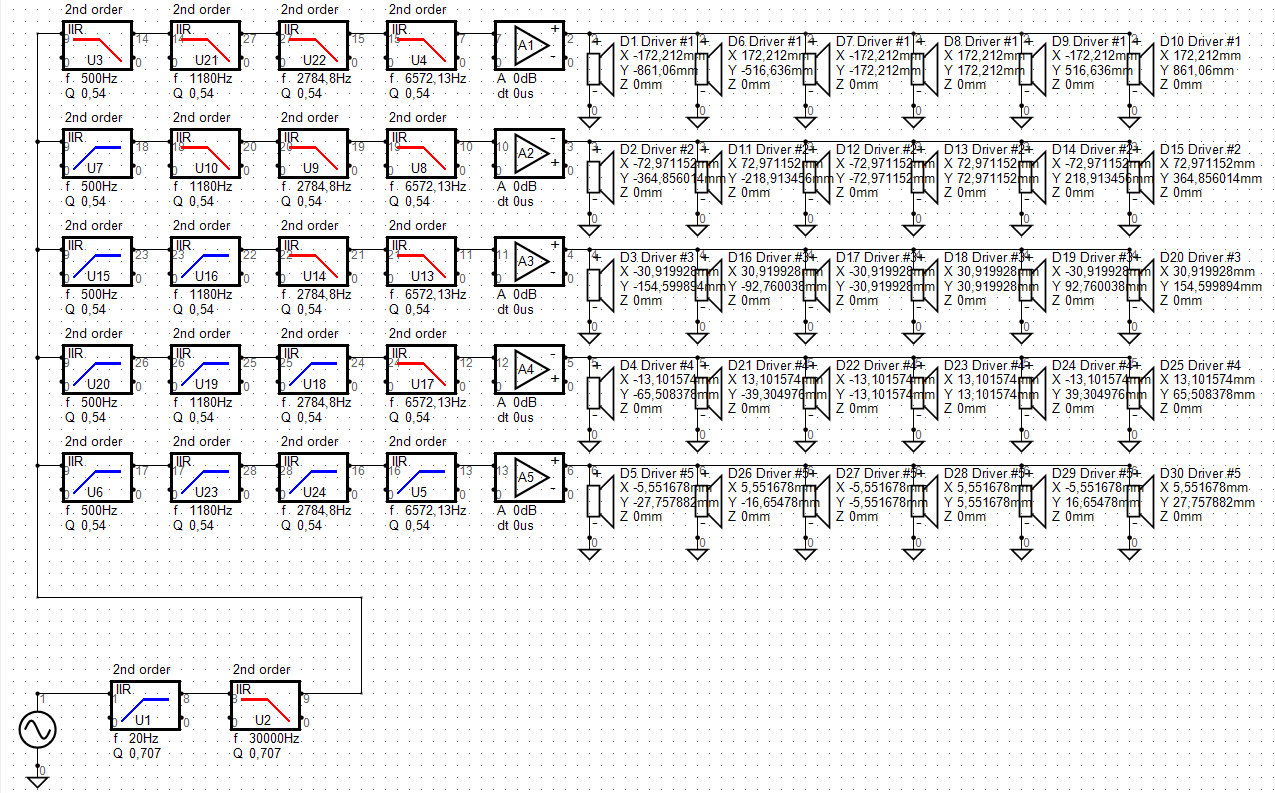

Driver data was generated with Diffraction tool into a phone booth with massive rounding to avoid ripples. Driver diameters 15, 30, 60, 120, 240 mm. Baffle loss is compensated with 2nd order shelf. Pure theoretical dimensioning is not possible in practice, but that was obvious in the beginning. Last two bands would probably fit and work with totally three drivers (instead of twelve).
180 deg is less directive than 160 deg due to better phase match. Also in real life.

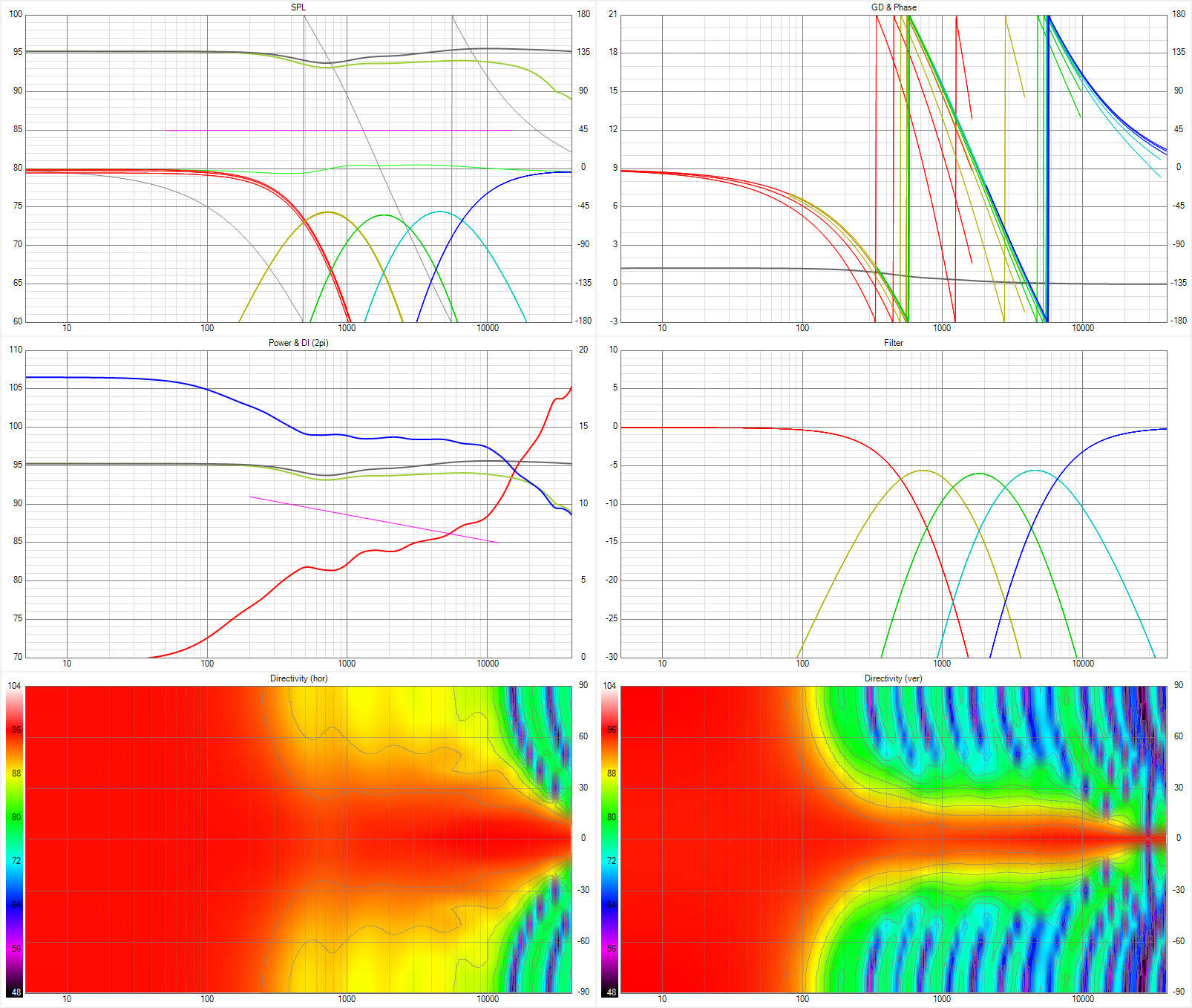

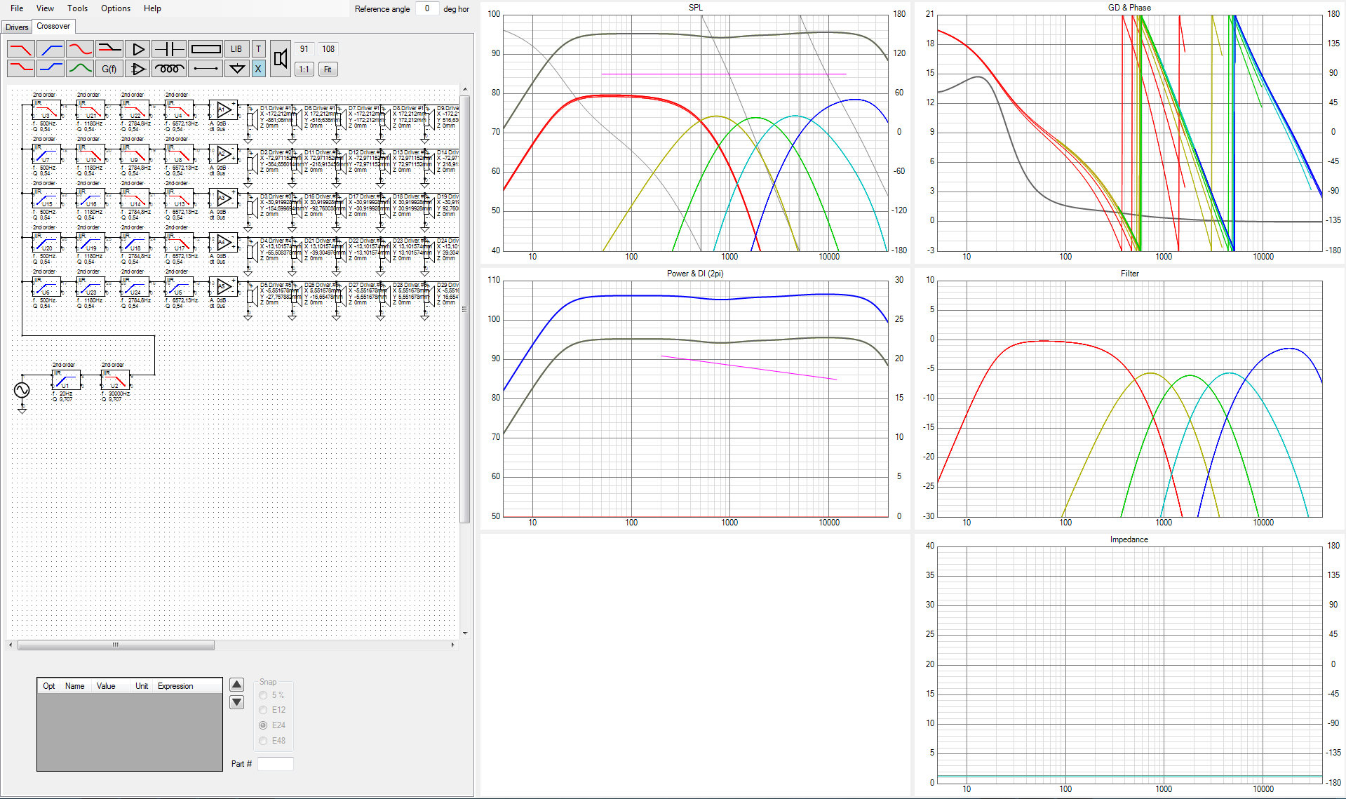

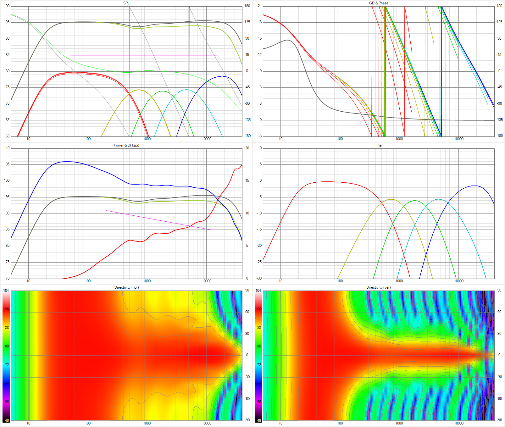

Is below alright kimmosto comments are very welcome for education 🙂 first is without stopbands as yours and second is a BW2 system passband 20Hz-30kHz.
For info procedure was take default flat driver as a 240/120/60/30/15mm diameter piston via menu "Tools/Multiply A * piston directivity" from zero up to 90º in steps of 10º as horizontal files and a double for each renamed vertical file, that gave me +/- 90º directivity hor/ver and then enabled "Half space" into options meny.
Know we are in pure syntetic model mode here using no real baffle other than pattern for X/Y positions and flexible active XO filter plus that syntetic directivity tool for piston sizes.
Realistic baffle size could be added with step and difraction and even room in form of curves from one of Jeff Bagby's spreadsheet but its get complicated then with 30 different positions of drivers and alot of work 🙂

This is a surprising result to me. Are these FIR filters? I had assumed that something like Horbach-Keele was necessary to make that work.
You can get pretty close to FIR filter performance by doing two things:
1) messing around with the filter slope
2) messing around with the front-to-back spacing of the two drivers being crossed over. For instance, by setting the tweeter backwards.
Yes. "Standard" LR24 linear phase FIR which is also available in some dsp devices without playing with IR & convolver.
Elliptical slopes are not mandatory if order is good compromise which mixes directivity but avoids lobing.
