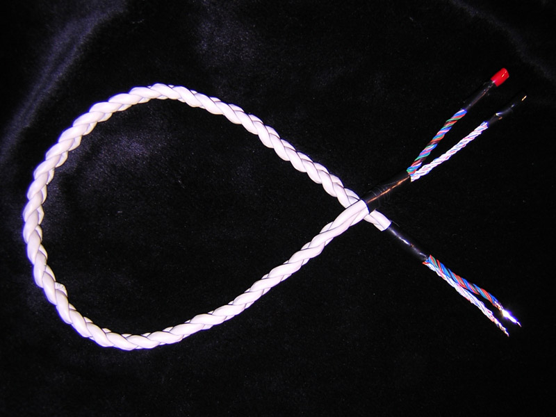

It's 3 lenghts of Cat5 cable braided together, At the ends the color/white cables are twisted together to form the negative and the color cabels are the positive. There are many implementations of the Cat5 as a speaker cable here on the forum and elsewhere.
Here's one:
http://home.zonnet.nl/geenius/CAT5.html
I think I'll try to make some cat5 for my JX92S's.
