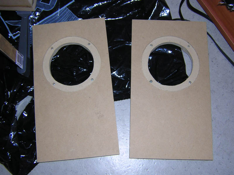

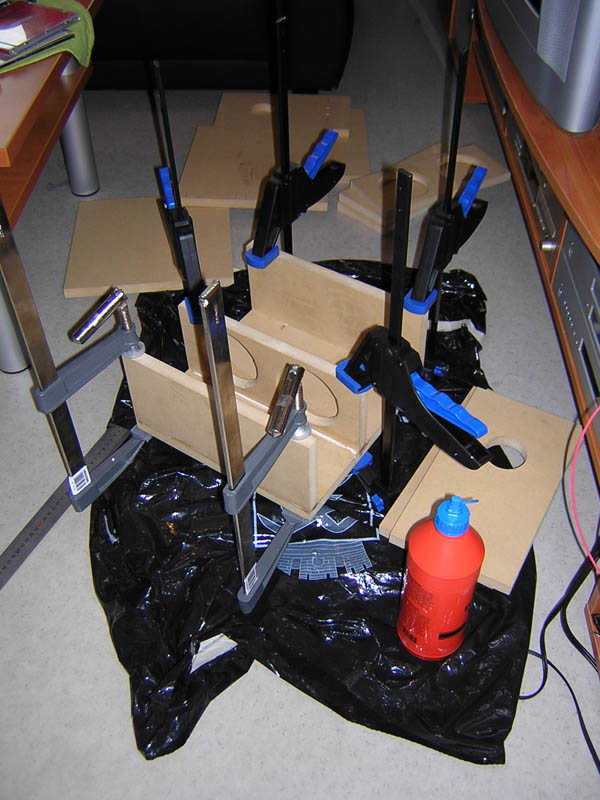

Today I've been gluing some more and I've started making the internal cable. One ready:
It's 3 lenghts of Cat5 cable braided together, At the ends the color/white cables are twisted together to form the negative and the color cabels are the positive. There are many implementations of the Cat5 as a speaker cable here on the forum and elsewhere.
