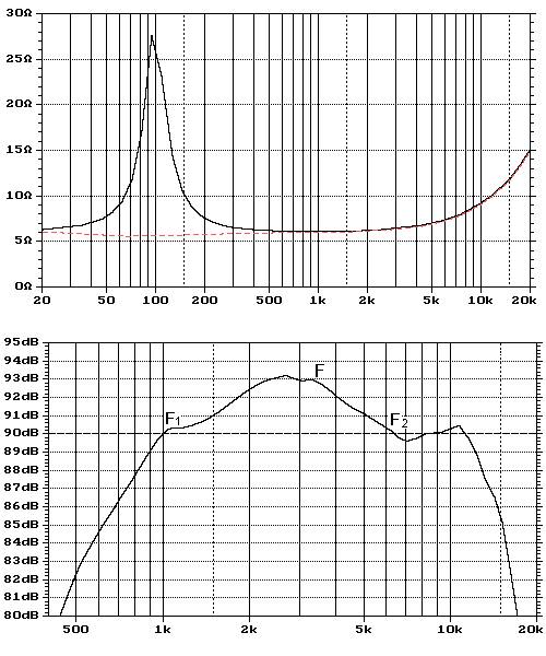

There is no baffle step effect shown on any of the measurements I've seen so far. When measuring at 1m etc, shouldn't the baffle step show up?
Bsc
I actually begin to think the the rise, starting at 600-700Hz is the bafflestep.
If you take the formular from TrueAudio
Baffle Step fb3 = 115 / WB (where WB is the baffle width in meters)
you get 638Hz for a 18cm baffle, that's about where the rise starts in your graph.
But that would mean the driver has a dip or series of dips in the upper midrange and the peak at 8k isn't that dramatic.
This would kind of strengthen GEEKs theory (or better experience) that when the midrange clears up, after an extraordinary long break-in period, all is fine.
or am I totaly off tracks now?!?

Hmm, I guess on retrospection the ripple effect of baffle step is pretty clear from around 700Hz to 3kHz, which as you say means that there is a large dip in response 3kHz upward?
The bottom line being that no further BSC is required I guess.
Vikash said:How would I combine the notch to include BSC? My baffle is 175mm wide (211mm including the bevelled edges) x 281 high.
The fact that MLS signals are not truely low frequency signals may be the reason why the baffle step does not show. Additionally, 1W testing is really not realistic, it's just good for sales.
The easiest way is to run "the Edge" to generate initial BSC values, add a cap just using listening to determine which sounds right, and then compensate the impedance.
Baffle diffraction ripples would normally be ignored. It does more harm than good to try to flatten those out.

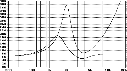

Hi, a series notch filter as I understand it is used to reduce the impedence peak at Fs: http://www.speakerbuilding.com/content/1041/
thats right - a series notch is for impedance correction (upper picture) and parallel notch is the one we are talking about!
You don't have to look from the drivers point of view - it's the parts point of view. All parts are in parallel to each other and than in series to the driver.

Vikash said:Hi, a series notch filter as I understand it is used to reduce the impedence peak at Fs: http://www.speakerbuilding.com/content/1041/
This is the Zobel that goes in parallel with the driver for impedance correction.
A zobel will flatten the impedence rise caused as a result of VC inducance. This allows crossovers in that region to function better/more predictably.
http://www.trueaudio.com/st_zobel.htm
to visualize Vikash's words hear a picture of a Zobel function. A Zobel can just be calculated with Le and Re.
For a series notch to control the impedance peak present at the resonant frequency you need the following data:
Driver DC Resistance (Re)
Driver Free Air Resonance (fs)
Driver Electrical Q (Qes)
Driver Mechanical Q (Qms)
