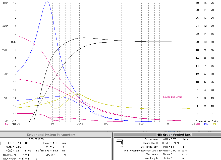

Dave, I'm thinking of converting the design to a BR. What tuning would you recommend in an 8.5 - 9 litre enclosure?
Vikash said:Dave, I'm thinking of converting the design to a BR. What tuning would you recommend in an 8.5 - 9 litre enclosure?
I'll have to run some sims... gotta go help my dad put a tarp on his roof (it gets scary when the light globes start filling with water)
dave
The box is a bit small to get an alignment i like the looks of (given factory specs). It looks like tuned to 54 Hz with a bit of resistance in the port should give fairly flat to 50 Hz (without the stuffing there is a 1 dB peak at about 100 Hz (but you may like that). I did the sim at 8.75 litre.
What is a standard port D in GB?
dave
dave
I did a few sims with WinISD Pro, and with CSS's T/S-parameters a 55Hz tuning seems to give the best responce in a 8,75l enclosure. However with HobbyHifi's measured T/S I'm getting a +5dB peak at 70Hz with 55Hz tuning. If the tuning is lowered to 35Hz the peak disappears, but the responce is not smooth and group delay is quite high at the lower frequencies.

The 4.05mm Dia. port seems perfect.
Vikash said:40.5 and 45mm ports to hand. Both are 121.5mm long.
123mm is what the calc says... so your port is close enuff.
dave

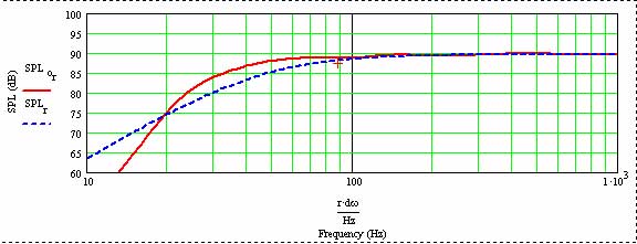

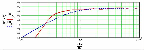

Well, I am in the process of building a bipole MLTL, for which I had used the CSS T/S parameters to model in MJK's mathcad sheets. The FR graph from that one looks like:
So, I suppose, if your box is large enough, the higher Vas won't be too much of an issue. You'll just have to tune the port lower to match the lower Fs to get rid of the hump.
That is supposing the Hobby Hifi specs are correct.

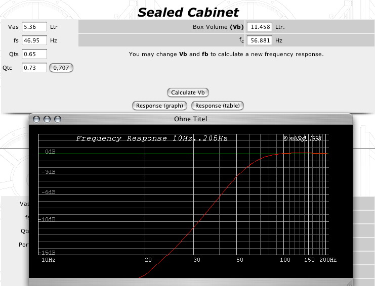

I have the FR125Ss playing in a 12L sealed cabinet, I can't measure them, but I doubt that the f3 is somewhere between 50 and 55 Hz (see the simulation below), from what I'm hearing the f3 is more like in the 70 - 80 Hz area.
I will start experimenting with ports for the 12L enclosure in the next days.
