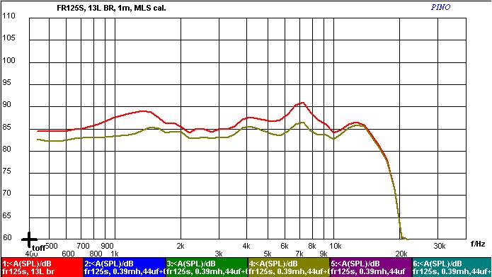

Notch mixup
Hi all,
i made a little mistake with my notch posting. The 12 ohms are with notch no. 2 NOT no.1 !!
Notch 1: 0.39mh / 44uF (2x 22) --> this is for the 1500Hz region
Notch 2: 0.1mh / 4.7uF / 12 ohms --> this is for the 7000Hz peak
Sorry!
Thorsten

Hmm, why does your measure show output only up to ~15kHz, while I believe the FR should be 65Hz-20kHz +-3dB?
it's not because of the driver trust me! DIY magazines "Hobby Hifi" and "Klang + Ton" measured FR125S over 20kHz (up to 30kHz!!). It's just my microphone.
Measurements below 370Hz are quite "useless" at my place because it would only display room reflections.......
Regards
Thorsten

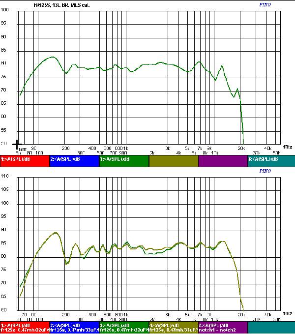

Nearfield and new notch
today I made a nearfield plot without notch. The 180Hz bump is possibly because of enclosure resonances due to a undamped back wall.
Below is a plot with a new notch filter. Reason:
We compard the box 1:1 with Jordan JX92s in Jordan TML. Although the frequency range with the inital notch filters war pretty flat we didn't like the upper midrange.
We tried some notch variants and ended with two:
Var.1: 0.47mH / 22uF / 12ohms (green line)
Var.2: 0.47mH / 33uF / 12ohms
We prefered Var.2 because the upper midrange was a bit softer.
Notch 2 (for 7000Hz dip) is still valid: 0.1mH / 4.7uF / 12ohms.
The curves might don't look good at all but they sounded great!
Regards
Thorsten

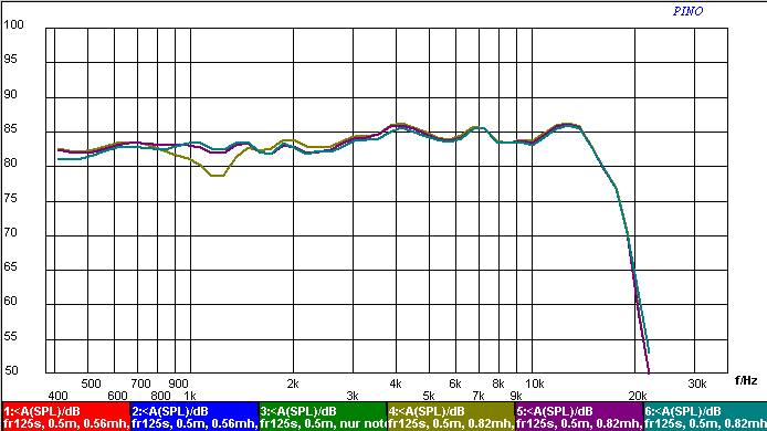

"Last notch version"
we did some measuring & listening sessions (1:1 with Jordan JX92s TML) and came up with our final version:
Notch 1: 0.82 mH / 8.2 Ohm / 22 uF
Notch 2: 0.1 mH / 12 Ohm / 4.7 uF (unchanged)
The line with the dip is without the 8.2 ohms.
Regards
Thorsten

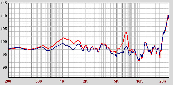

Vikash said:Hi Thorsten,
Bare with me, I'm learning as I go along...but here's my measured FR and modelled response with two notch filters:
1k notch
C1: 170uf
L1: 90uH
R1: 1.2R
7k notch
C2: 30uf
L2: 19uH
R2: 5R
Any feedback appreciated.
Hi Vikash,
I find the values of the components in your notch filters quite strange.
The formular says, the peak frequency f=1/(2*pi*sqrt(L*C)) with L in Farad and C in Henry. A bigger L results in a lower f2 and smaller C results in a higher f1. The max. attenuation At is set by the resitor R (3dB ~ 4Ohm). I don't know any formular that would help finding the values for L and C with given f2 and f1, for me that's a matter of simulations and tryouts.
With this formular, in theory!, your 1k notch would target ~ 1300 Hz, which would be correct, but again, to me the values seam very strange for a notch filter, don't know what it would do really... actually I wouldn't know where to get a 0.09mH or 0.019mH air core inductor.
I have build Validators filters for my 12 liters BR cabinets and they seam to work pretty well. The 1k filter with L1=0.8mH also targets the bafflestep, in Valis case 18cm bafflewidth, i.e. in my case with a 24 cm baffle the L1 is around 1,2mH.
best, lc
Thanks for the feedback lc. I derived those values through a crossover simulator which I'm trying to figure out (evidentally not well). I'll go through it again and figure out where it's going weird...

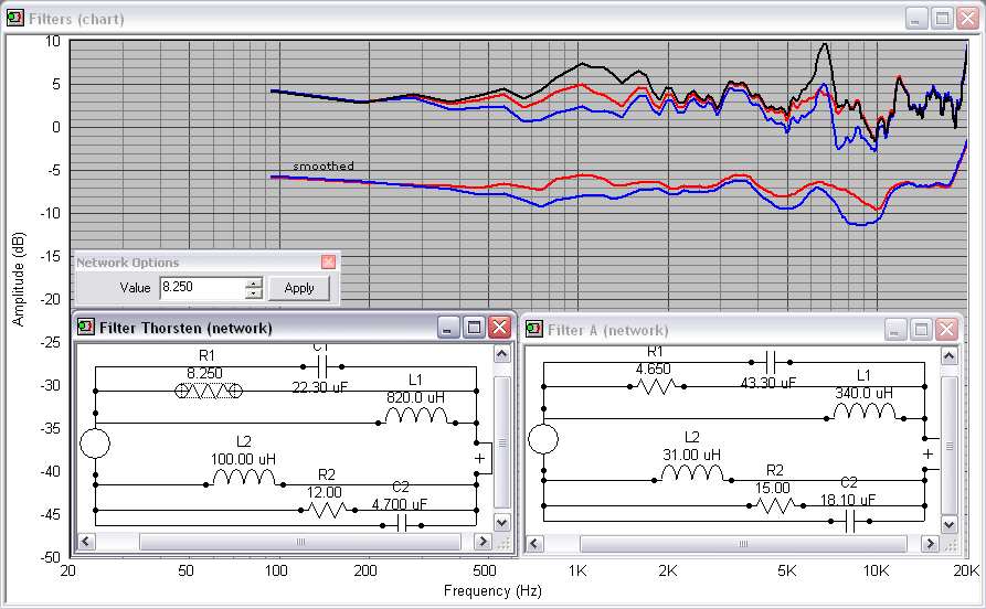

Hi Vikash, the 1k notch looks pretty much okay. 0.35mH, 39uF and 8.2Ohm was my starting point, it will flaten the peak. I don't know speaker workshop, but is it possible to change the value of the components and see what happens?Vikash said:I did some more playing this evening, this time using Speaker Workshop to simulate the two notch filters. Can you see what I'm doing wrong?

Hi lc, yes I have derived those component values by manually fine tuning and viewing the results in SW.
I've attached another simulations this time with Thorstens notch as well. I'm happy with the 1k notch as subtle differences here will be due to the differences between our cabinets.
I've come to the conclusion that the 0.1mH inductor is used for practicality rather than it being ideal (you're right, the smallest air core on madisound.com for example is 0.1mH). This might neccesitate a little unwinding if the rest of the values look ok.
Your opinion is appreciated as always.

Vikash said:Hi lc, yes I have derived those component values by manually fine tuning and viewing the results in SW.
