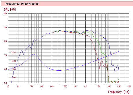

It's all a bit of a mystery why Vifa should have discontinued one of their best ever drive units. 😕
A lovely flat 5" bass/mid driver.
But the modern afficionado can seek out some similar drivers:
Peerless HDS PPB 830860
The Peerless HDS PPB 830860 clearly does much the same thing. 😎

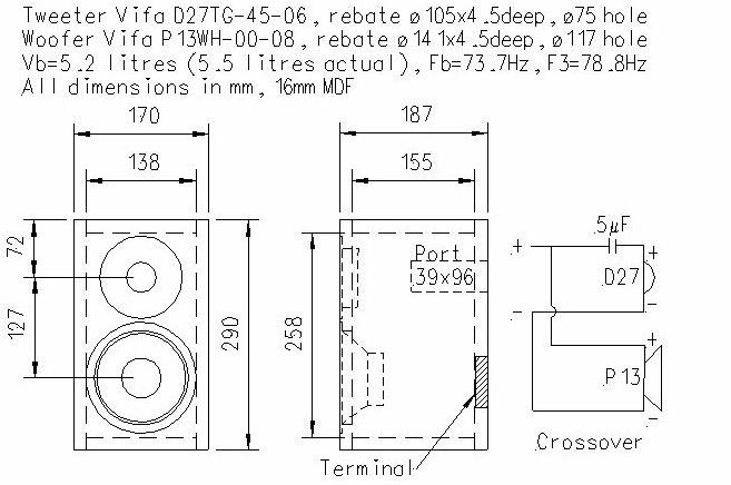

I've been using the P13WH for a good number of years in a pair of little ported 2-ways, along with the Vifa D27TG-35-06 tweeter. The design is from here: http://www.diyaudio.com/forums/multi-way/25590-diyaudio-reference-speaker-project-11.html#post308661
They're really lovely little monitors. They're always either on my desk or by my bed. Great detailed midrange - perfect for guitar and vocal, which is ~80 percent of the music I like. My only complaint is that they really are lacking in bass. The Ariel gives me another 6dB of bass thanks to the dual mid-woofers, plus the transmission line allegedly extends the bass down to fs...
Not to mention that they look really nice and they're a good woodworking project, and I'm in the mood for cutting some wood up.
Here's one of my little "diyAudio reference" speakers:

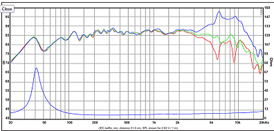

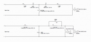

The SB 5" MFC polycone is a good idea, Rabbitz.
5" SB15MFC30-8 :: SB Acoustics
It's very similar to the 0.7mH Le Vifa, just a lower inductance at 0.14mH due to damping rings. I've been playing with some variants on the SB Acoustics Elok idea. It's third order essentially. You can put resistance in the bass shunt.
I'd guess if you put a 0.5mH coil in front of it, to put the inductance back and take out the HF hash, it would work with Lynn Olson's Ariel crossover. 😎

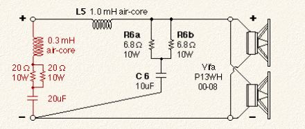

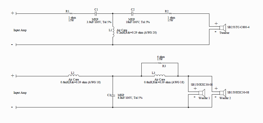

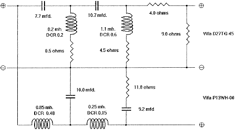

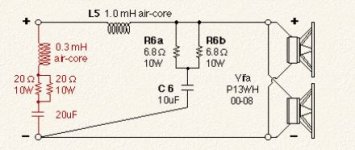

My plan is to biamp with a 100W one for the woofers and a 50W one for the tweeters. I've got a bit of work to do to reverse engineer the Ariel crossover so I can do it actively.
There's not much to reverse engineering the Ariel electrical response. Interestingly, the impedance correction is not flat. This gives it a little bass boost and 2dB midrange presence at 2kHz. Which may be why it works better with valve amps.
If you put the Vifa DCR of 5.7R and Le of 0.7mH into an impedance correction calculator, you find that the bass shunt (and adjusted for parallel MTM) is just a near Zobel with half the theoretical capacitance. Which is what Lynn said it was.

Thanks for the analysis of the crossover Steve. I'm interested what you used to model the drivers? Simply a series LR circuit or something more involved?
I started reading up on driver modelling last night and my eyes rapidly glazed over. I'm just a simple engineer...

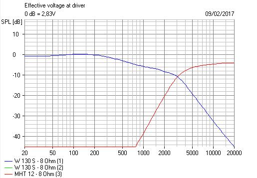

I just used a similar 5" Le=0.6mH 8 ohm driver. The Visaton W130S, as it goes. 😱
Boxsim is a very good simulator that an ordinary human being can get good results out of quickly:
Downloads
Import a similar project like this Couplet Light MTM into projekte folder, and you're in the right ball park already:
https://boxsim-db.de/couplet-light/
We don't have to reinvent the wheel in established territory like 5" MTM. It's easy, because 5" drivers are flat. 3kHz crossover.

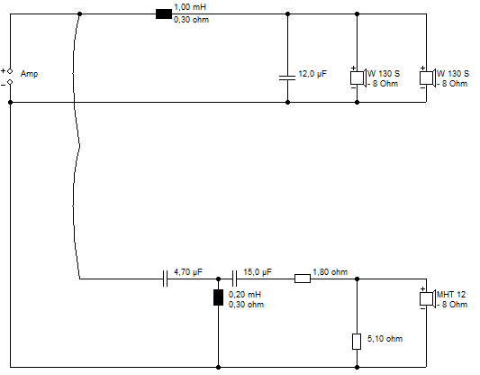

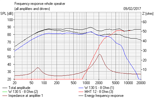

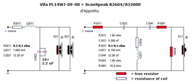

Troels Gravesen does an easy MTM here:
Vifa PL14WJ-

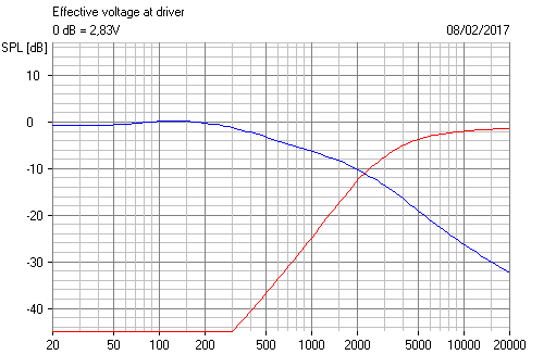

Now, actually, he uses a very familiar design of 2nd order bass at 4 ohms, which is always near 1mH with 8-12uF shunt, and a third order tweeter. The second to fourth images are the SEAS CA15RLY idea we tried with a ribbon tweeter. The main thing is to have the right idea.
In practise, when you include the (0.3mH for parallel drivers, it would be 0.6mH for a single one) voicecoil inductance, the bass is the familiar 3rd order in 3:1 ratio, which lies deep in the maths of filtering. As is the tweeter filter at 1:3. This ends up an order higher than Lynn Olson's design on bass and treble. In practise, a filter has an impedance, and at 4 ohms, the capacitors get bigger, and the coils smaller than with 8 ohms. But they are otherwise the same idea.
The slopes are not entirely symmetrical to allow for very slight time alignment issues between the drivers, and keep phase aligned. An old trick.
BTW, you will notice the electrical response is steeper than than the mechanical response here. That is the bafflestep allowance for the box, which is needed unless you wall mount. In the real world with a cabinet the lower bass sort of disappears round the back of the baffle by 6dB (which is quarter power), whereas the mids go forward to you. If you want to appear wiser than you really mostly are, you might waffle about 2Pi space and 4Pi space and diffraction. Which always loses noobies completely. 😀

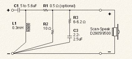

The Ariel crossover is 4th-order acoustic at 3.8 kHz, so adjust your active crossover accordingly. The tweeter will never need more than 20 watts, more likely 10 watts in the real world, so you might consider a Class A option for the HF amplifier.
