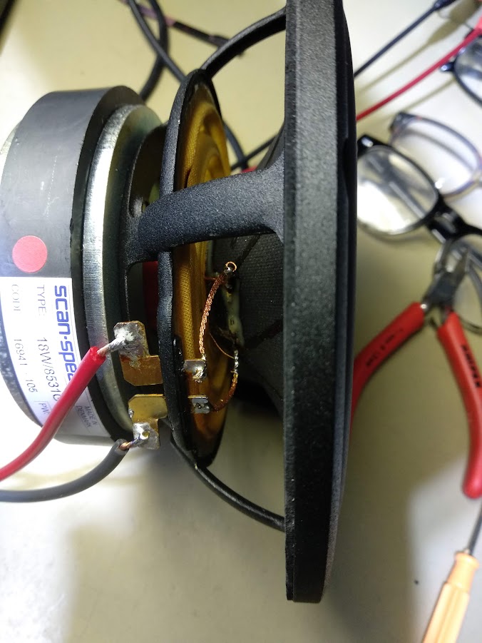

Four Scanspeak Revelators dead at the same time, no visible damage
Has anyone had problems with the Scan-Speak drivers without living in a humid/salty climate?

Another cause could be the change over to lead free solder, at that time a lot of variation was seen in solder and flux formulas.
A combination of aggressive flux and poor quality solder may be responsible, the posters who reported 'no problem' seem to have drivers from before the lead free era.
It could also be that some portion of the production was shifted to China or elsewhere, the parent plant becoming an assembly area.
There must be 10 people in sales, accounts, administration and so on, leaves about 14 people on the shop floor, and shipping etc.
Some changes in the product with improvement as the goal may have been bad decisions in hindsight, most failures happened long out of warranty.
Reactions: jkasch
Yes I really like the drivers. Can't fault the mechanics, split paper cones etc. I have a passive sub with 12" + passive radiator I designed using Scanspeak and it hammers. The faulty mids I've repaired now and they're fine. A note from the manufacturer saying yes, we're aware and isolated it to such and such timespan a couple of years ago would inspire confidence. A small batch flux/glue issue is most likely imho.

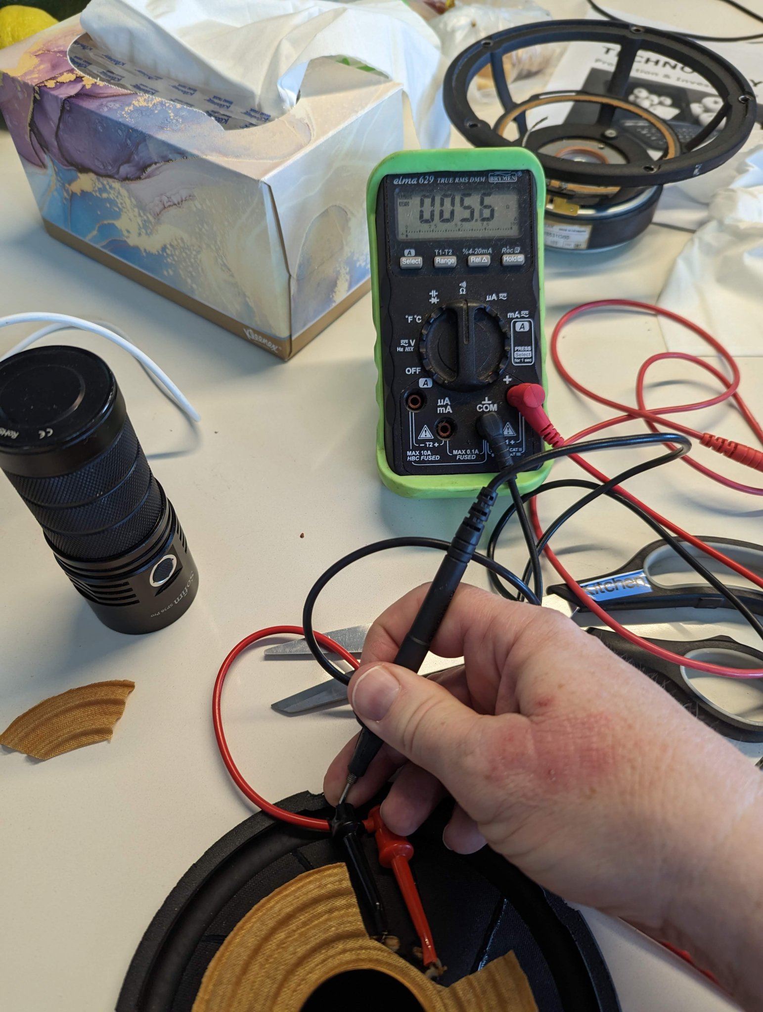

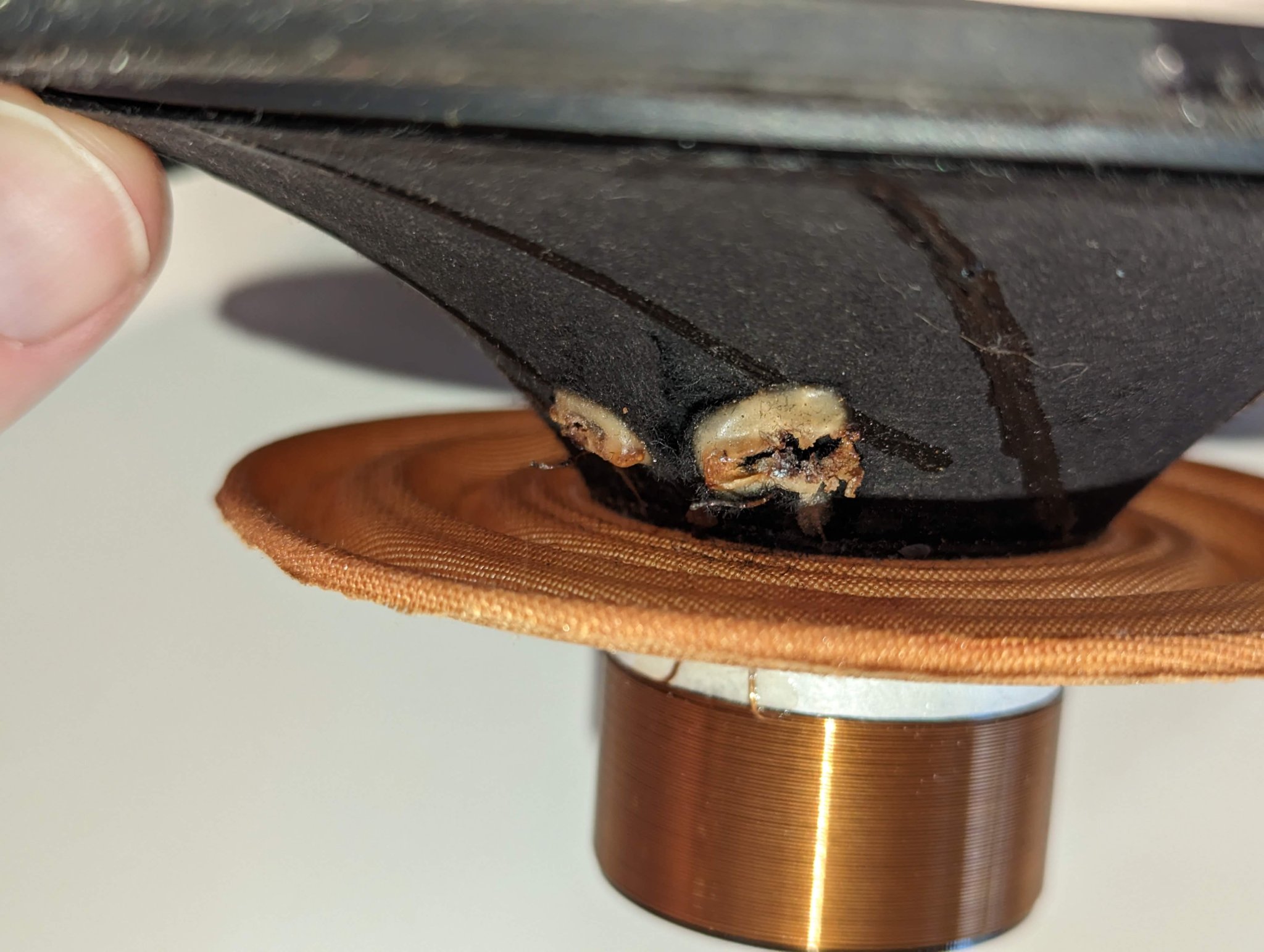

I sacrificed an element to make sure. It measures 5.6 ohm when measured directly on the coil wires. There's no visible damage other than the corrosion. Still have three drivers with the same problems, but I don't have time to repair them. Wondering if I should sell the rest of the components of my ZRT system and build something new? New set of elements is about AUD $1200.
