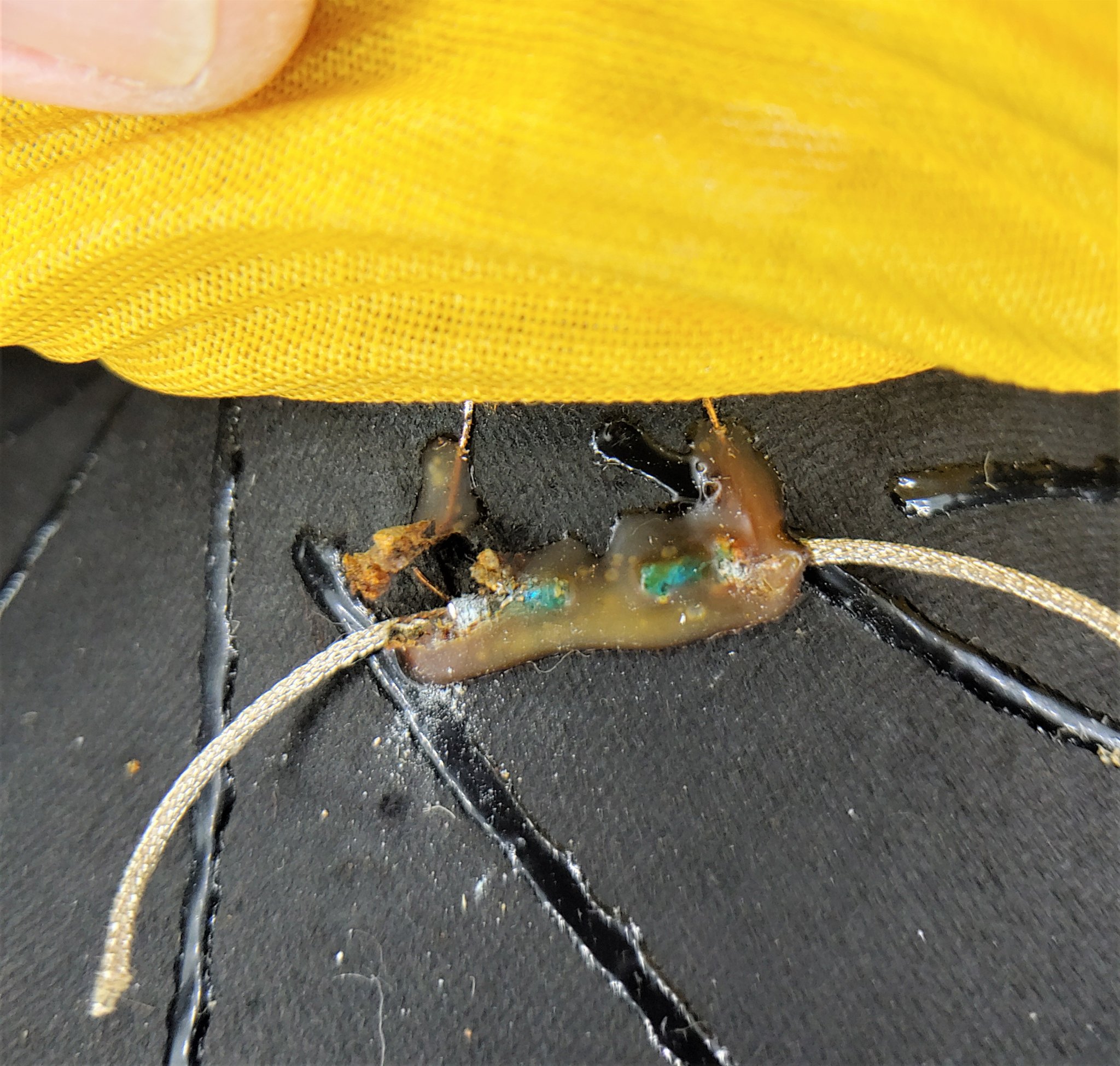

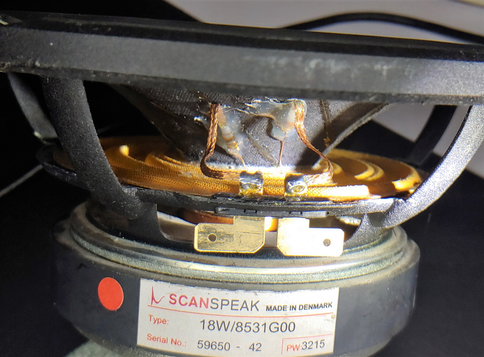

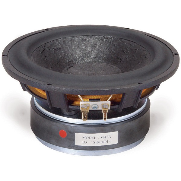

I've had two of the same drivers die on me the same way.
It was corrosion between the tinsel and voice coil wires on the back of the cone from the glue used.
If your really careful, it should be fixable.
Yep, just about to write that.
I fixed at least one 15W like that before, but they have other corrosion issues at that point usually.
Under the lead VC glue junction is where it is and you're explanation makes sense.
Actually SS woofers corrode in general.
The rubber oxides, you can even see it in madisound pics.
I told that to a guy I was going to buy some 26W's from.
I said: "$50 less because you already have corrosion inside the magnet hole in the back".
He said: "no" and he did me a favor.
I still talk to him sometimes and think, wow, I wonder if I have the same psychological issues (common in "audiophiles") 🤣

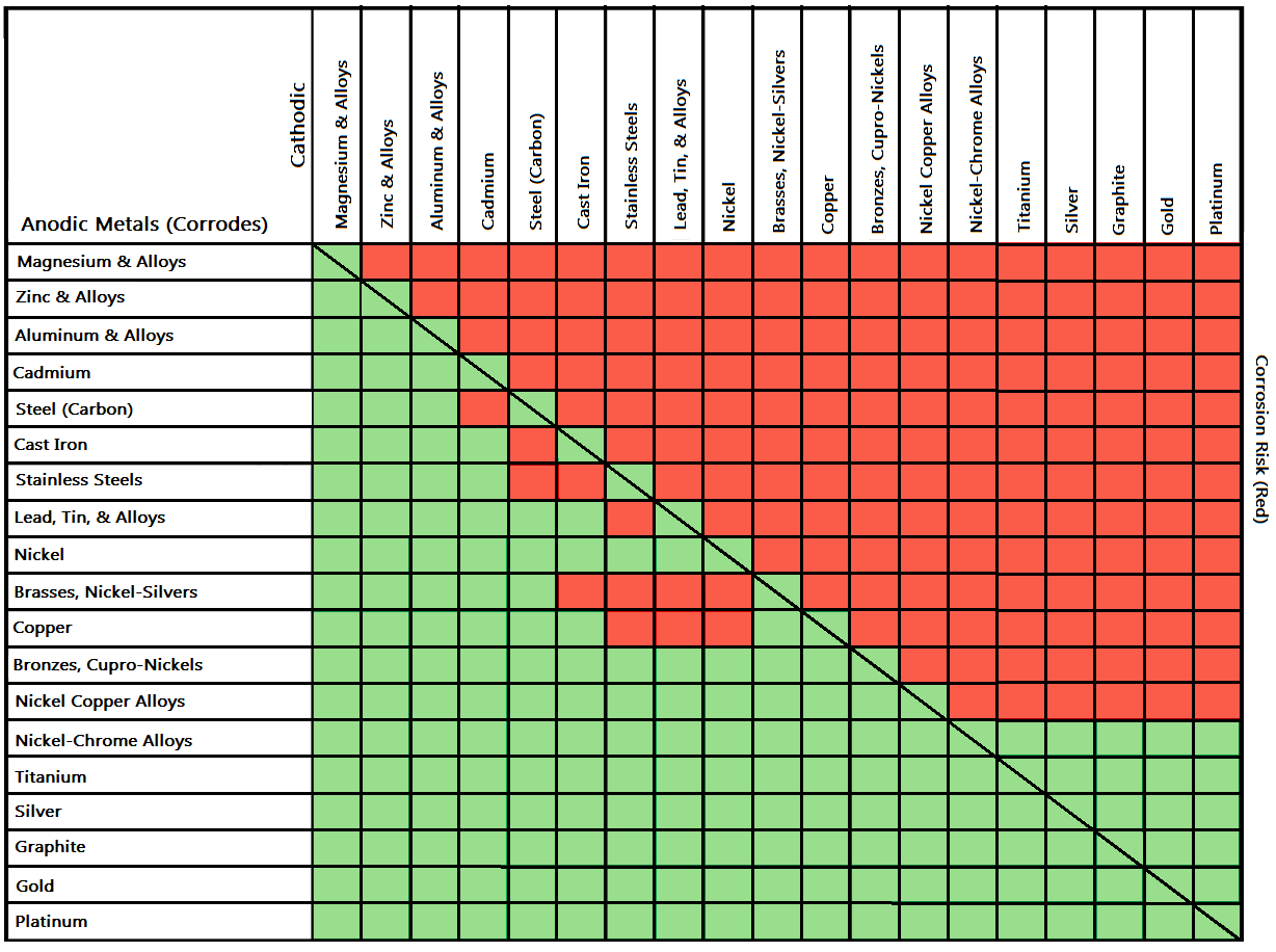

Aluminum and copper react, it is called galvanic corrosion, which is entry level stuff.
They should have taken care about that.
We use brass terminals here (zinc or nickel chrome plated at times), one side is copper, the other side is aluminum conductor... brass is relatively neutral to both.
The galvanic corrosion causes the material to be reduced to powdery oxide, moisture accelerates the reaction, so a covered joint lasts longer, if you are forced to use it.
As suggested above, a crimped joint may be more durable, thin brass tube (old ball pen cartridge / similar, or terminal) may work well enough.
Salty seaside air is even more corrosive in such cases, particularly in tropical climates.

I am betting that my new SS drivers are subject to this defect. 18W8741T00...... Just got them a few months ago and have never heard such great sound from a driver. Please tell me "Oh don't worry, those were way more durable than all the others."
That's a great 2-way or NE180 or NE225 is awesome also.
18WU should be the "best" 2-way woofer out there or 15WU.
It has great high and low SPL performance. Great Frequency range also.
I remember correctly I had 2 -- 18WU -- 4ohm that were corroded and the 15wu also, but they weren't stored correctly, probably.
Actually the 18wu 15wu were pretty much okay. But the 15w they came with was corroded under the lead glue.

Just to add some photos to this thread. I'm about to fix a second driver, the first one is sitting my Zaph 2 way, running nicely.
Here is a photo of the corrosion at the failure between the VC copper lead and the tinsel.
There's clearly some chemical reaction between the glue and the VC copper wrap-around solder joint to the tinsel.
The green oxidation is clearly apparent too. Disregard the VC copper break in the photo - that was done with the scapel while exposing the joint.
The powder from the corrosion spills out when the scapel reveals the joint, just like the blood from a corpse in The Andromeda Strain except not red.
I very carefully unwind a turn on the VC and re-thread it through the yellow support basket and I'm pretty meticulous in my solder reapair, using P1000 wet and dry very carefully to remove laquer from the copper and also use flux and 60/40 lead solder etc. with a reasonably good iron (Hakko 888D).
Then anchor at same site with glue gun and refit the cone etc. Use a 50Hz signal from the phone to confirm centre, leave vertical overnight.
I've only ever done one repair (it shows! not pretty but fully functional) shown below - used desolder braid - works fine.
And just to add - apart from this defect, I really like the drivers. The rest of the engineering + build on them is excellent and I'm very pleased with their performance. Has put a bad taste in my toolbox re: next build though. Has ScanSpeak ever come clean on this? Proven it's fixed and was a Friday arvo job?
