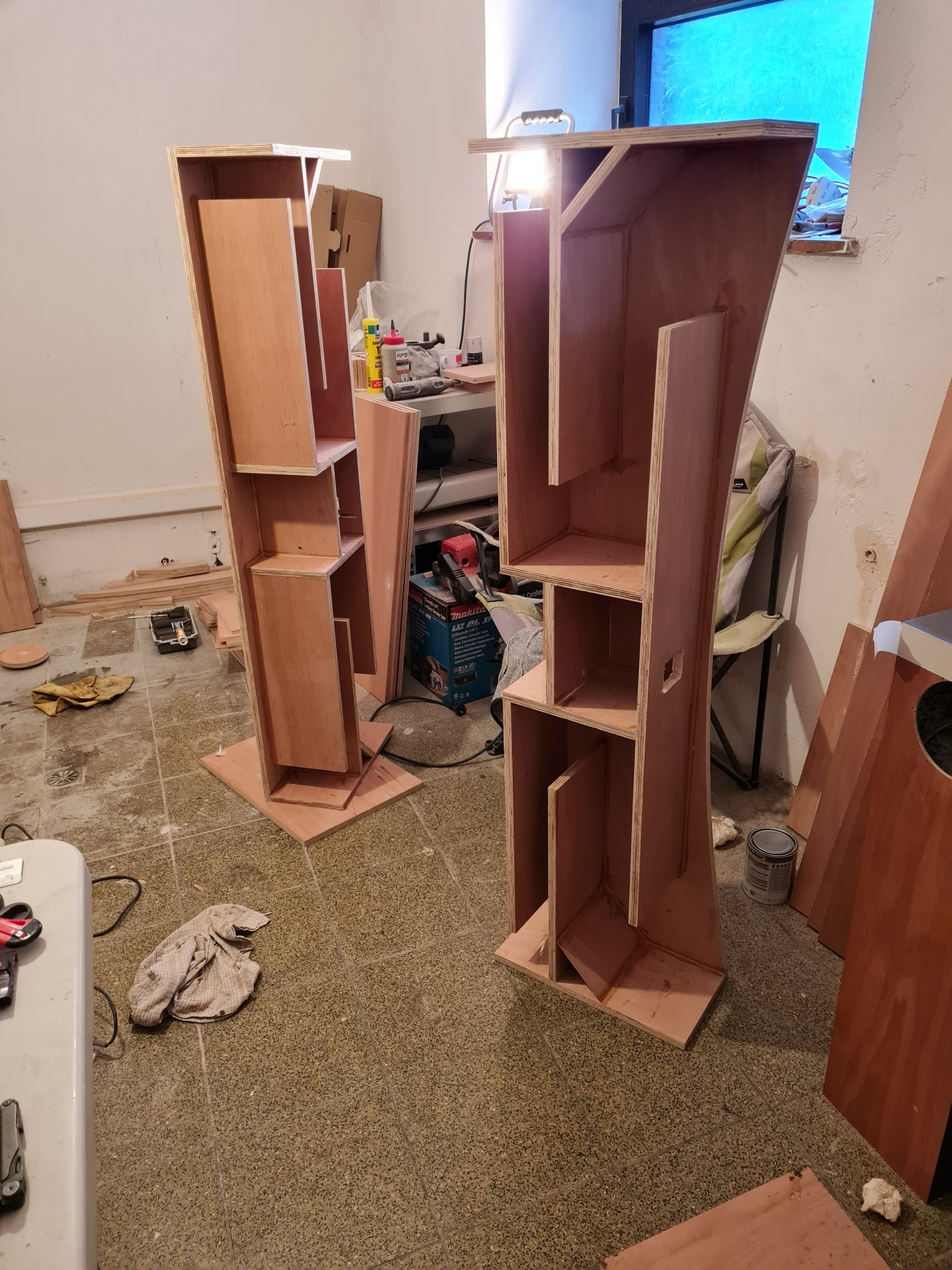

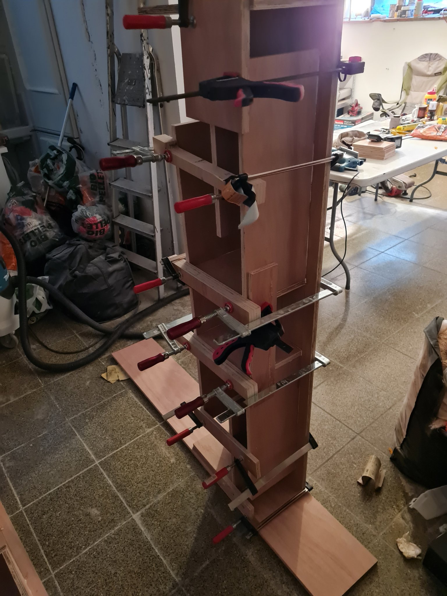

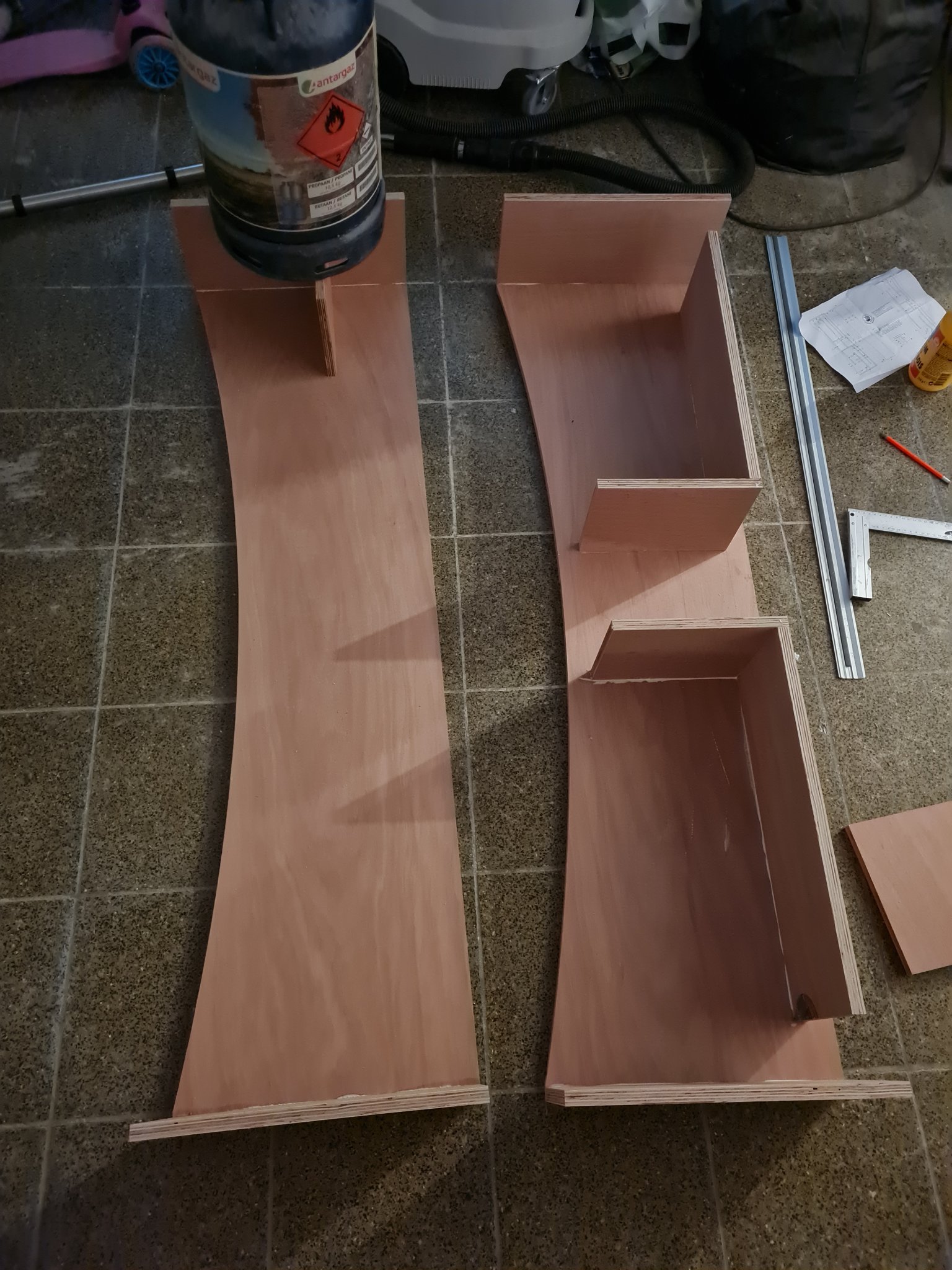

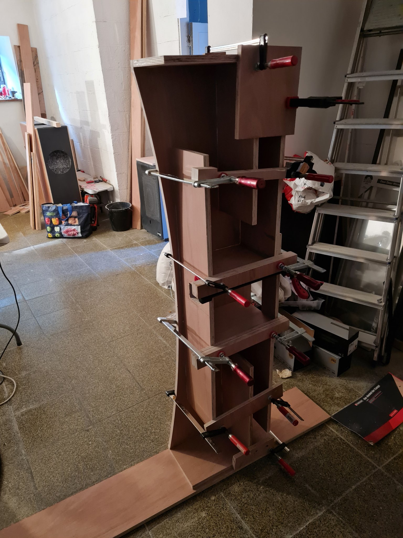

both sides are glued, still have to cut the speaker opening finish the damping and glue the front panels...the night will be long but, tomorrow i will finally listen to the music they can play...

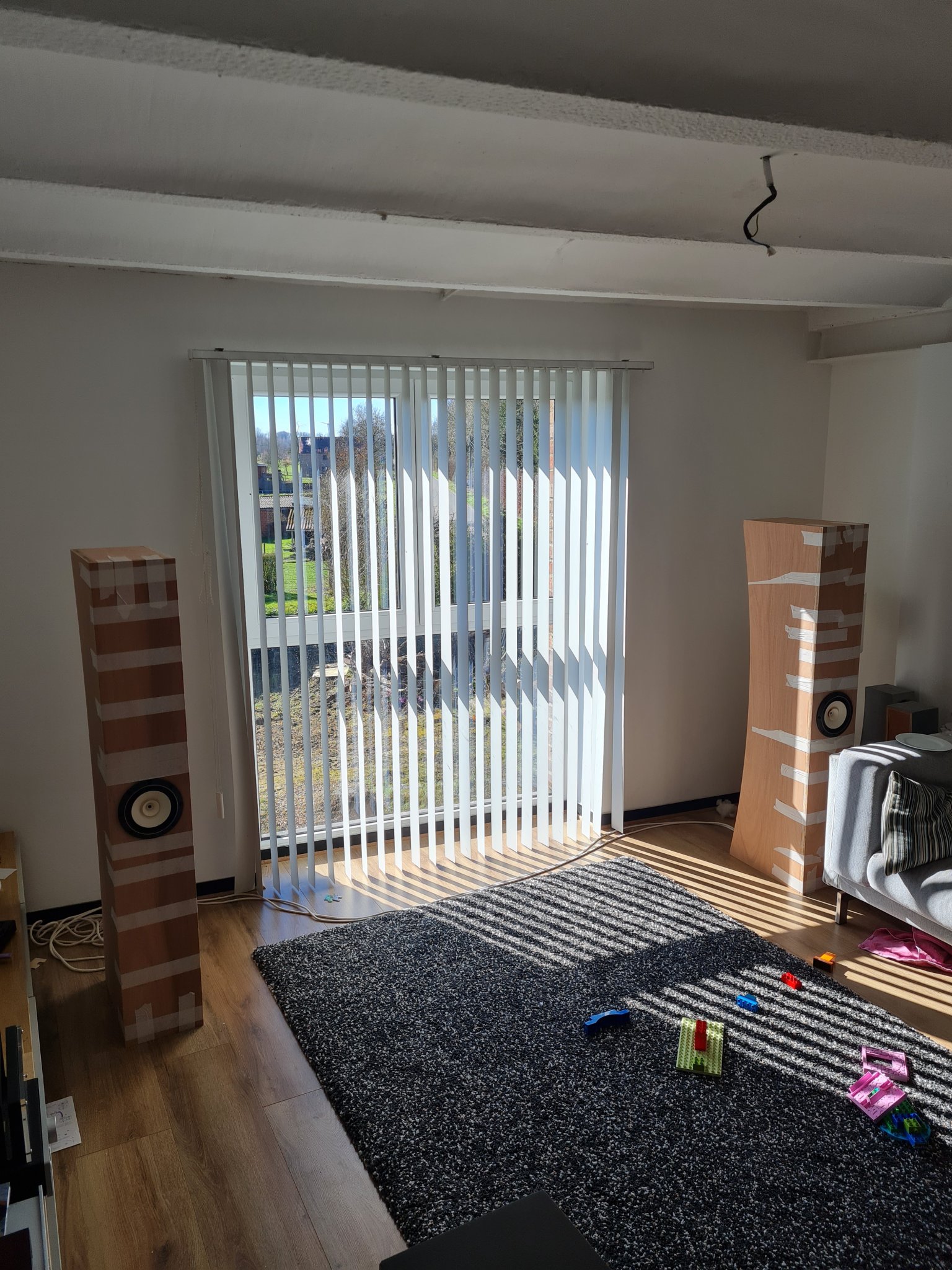

They are playing...and really really well, in fact I wasn t expecting them to be so good, they go deeper than my fhxl m10.2, are more punchy midbass, trebble is airy, and sound stage boys, well never heard one like this before, I have David Gilmour, the black strat and the whole band playing comfortably numb for me alone here in my living room like never before, and my m10.2 are allready playing the stars from the sky, but really these goes a step further, if I close my eyes, it s like I am touching the instruments, my scares from those being shouty and with no bass are far away...
Those fe168ns surprise me also, straight line they are a bit sharp and crispy in the 5 to 10k range but once 15deg off they are super spot on and deliver sweet but verry precise sound, so with the victors aligned parrallel and not toed in the sound is just super. The sound stage is hard to describe, I am playing all my live albums one after the other's and it s been like a rock festival in my house... 😁
Room placement is also crucial, like with most speakers, but here 5cm more or less from back wall and you go from boomy to flat sounding... I knew from all my fh that it was crucial but it is even more evident here... One more crazy thing, I have tested many many cables, speaker cables, rca cables, and power cables, for the speaker and rca cables the difference has been really important and relevant from one to another but I never really heard a difference with power cables, and just to be curious I tested 3 cables today for my power amp, pre and phono pre, and man it is hard to beleive how those speakers reveal the difference... Well i am completely astonished by this new set, no matter the waf, they will stay for a while...

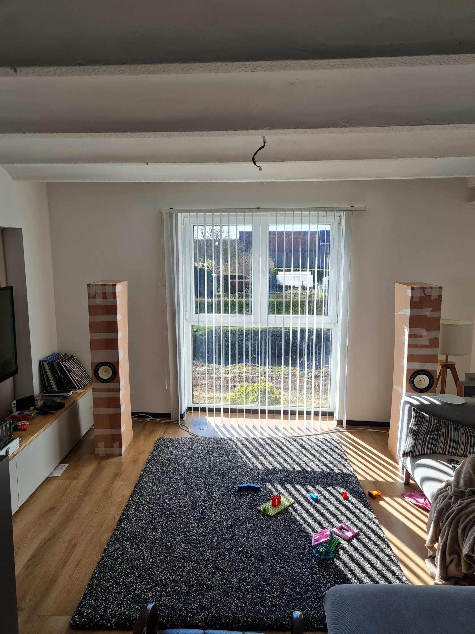

Still can't go asleep, switching between my m10. 2 fhxl and the victor on same albums, and yes I confirm, even if I still can t beleive it, Victor's are a serious step up... Man, "the wall" on these sounds so fckng a m a z i n g... I have that helicopter just landed on my carpet, so much fun...
Silberry for the MAOPs so that you can do an equal footing comparison?
When you switch are you getting the levels the same. The Foatex is some 3-4dB more sensitive. Also, if you are ABing as in the picture, the FHXLs are going to be screwed up a bit from the sides of Victor.

scheme... And yes of course I compare at same levels and with correct placement for each set, here both placed side by side for pict purpose... Will now have to take a look at silberry... Gonna have to love those builds... 3fhxl (2xm10.2, 1x11ms), 2fh3 (m7.2, p7.2hd) , 1 fhxs (ff85wk) , 1 marken trapezoid A11ms,1X adjust rearcduct now with A11ms, finally victor fe168ns,1st build started in December...
